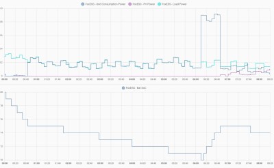

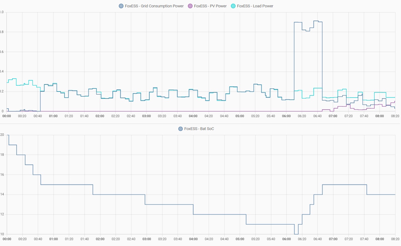

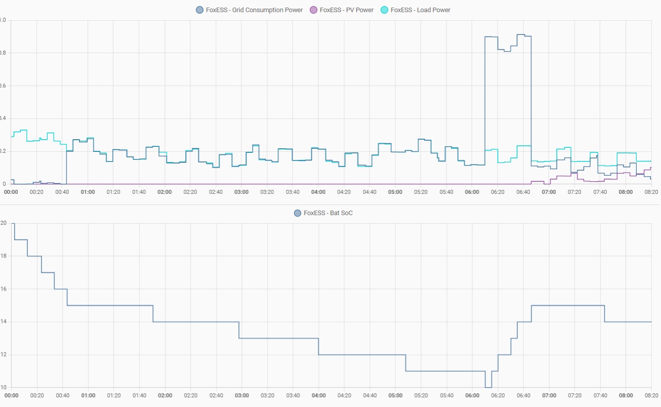

An update for anyone who is also facing this.
With both MinSoc=10% and Min Soc on Grid=10%, the SoC continued to drop below MinSoC at about ~1% per hour, even with Load met from grid.
When SoC reached 8%, I baled and reset MinSoc on Grid to 15%.
Having watched this for a couple of days, I am convinced that the scenario is:
  • 1.When PV=0, the SoC supplies Load with Soc gradually decreasing to the MinSoc on Grid setting, then
    2. At SoC=MinSoc on Grid, the Inverter switches the Load to Grid, next
    3. With the Load met by the Grid, the Inverter is still powered by the SoC, the Soc decreases gradually until it reaches MinSoc -5%, then
    4. The Inverter starts a charge from grid until the SoC reaches MinSoc on Grid
    5. Steps 1 to 4 repeat until PV comes on line and starts to pickup Load and charge the Soc
I have seen this happen at MinSoc on Grid = 20%. 15% and 14%.
I am worried that at MinSoc on Grid, the SoC would drop to 5%. In the somewhat unlikely event that an extended grid outage occurred at that point, I am worried about possible damage.
As a PV newbie, I am very happy to be corrected and learn otherwise.
A screen shot from Home Assistant with FoxESS cloud integration and MinSoc on Grid = 15%:
