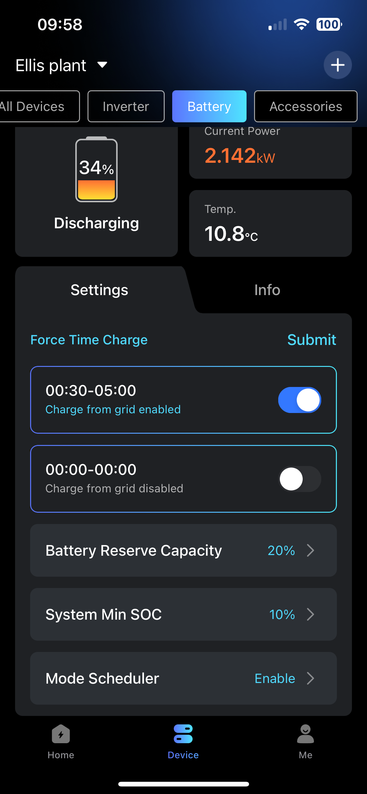

Hi having problems now setting charge from Grid as says write error I have been doing this for last week but neither version of the app or website will let me set it , see pic enclosed
any help appreciated thanks-
- Posts: 1865
You’ve got a schedule set (Mode Scheduler: Enable)
You can’t run the ‘old’ charge periods when you have a schedule set, either disable it or use Force Charge in the scheduler.
