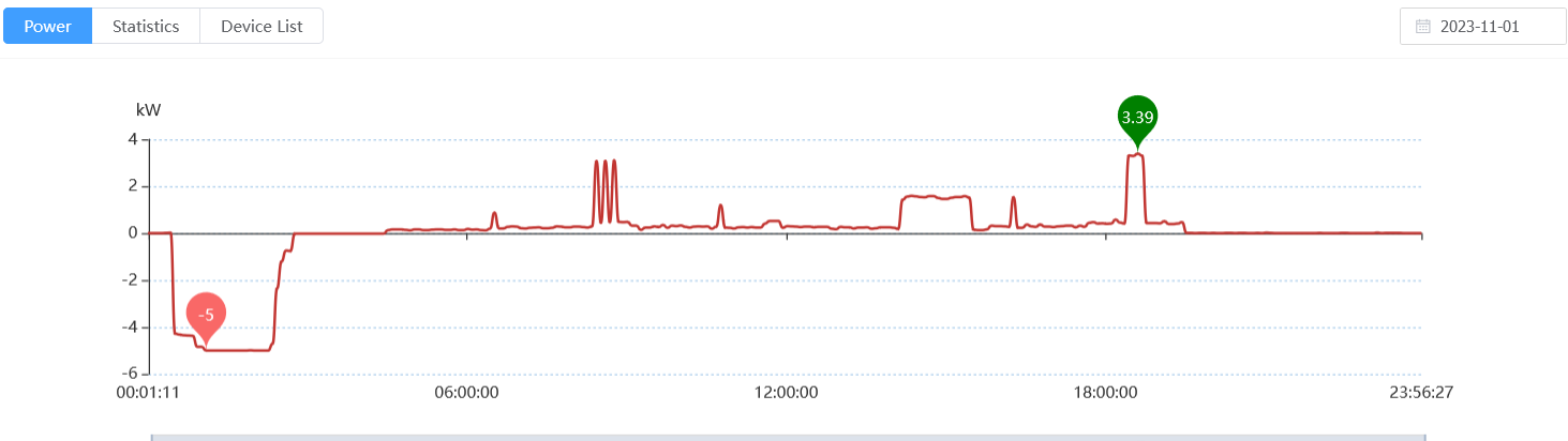

The system was installed in August 23 and performed well - providing almost all my daily usage (about 10kw) until about the end of January. Around this time, it simply stopped providing any usable output. The two attachments show a typical day last year (1st November) versus a typical day now (15th May).

Typical day in November 23
Typical day in May 24

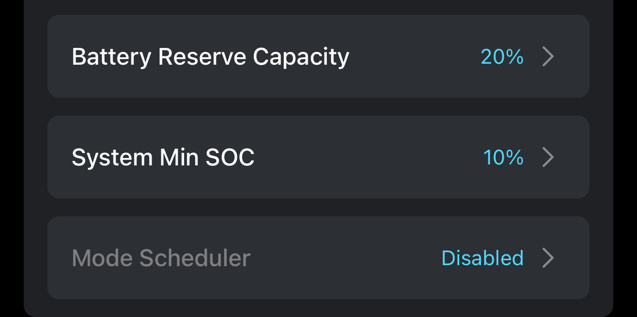

I’ve been having a similar issue. Battery reports having 90+ percent SOC, but it draws from the grid after the sun goes down. Seems like a major software bug. Sometimes if I toggle between backup and self-use it fixes itself for a day or two.
Doesn’t help that after months, my charts still don’t record or show SOC data.
No response from FoxEss support.
Re: Batteries providing barely any output and bizarre issues with Fox support
@srooke Can you screen shot your battery charge settings and post it here please
Here’s my settings. Note: the inverter still does not record the SOC in the charts too. Same old data feed issue?

srooke wrote: Fri May 17, 2024 5:52 pm Here’s my settings. Note: the inverter still does not record the SOC in the charts too. Same old data feed issue?IMG_8219.jpeg
Can you remind me which inverter model this is and what your firmware versions are - i’ll look up the latest firmware versions - the newer inverters H3 Pro, KH and H (G2) have had quite a few updates over the last month
