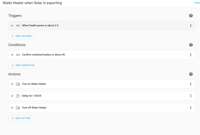

The best way of diverting solar surplus solar generation into hot water is to use an Eddi or iBoost device but there are cheaper, easier ways to reuse your exisiting immersion heating element to heat up hot water from surplus solar generation.
I'm using a Frient smart cable device inline to the immersion which is a smart switch and energy monitoring device https://frient.com/products/smart-cable/
This combined with a simply Home Assistant automation turned on the water heater when the export feedin power is over 2kW for more than 5 minutes and turns the water heater on for 1 hour.
An Eddi or Iboost is a far nicer solution as it can very the amount of power going to the heating element but my cheap and cheerful solution has been working flawlessly since I set it up.
Keen to hear all your thoughts on how you use your surplus solar generation.
Turn on immersion heater via smart switch when exporting power

I tried using the visual editor and it looks similar to the example at the top of the thread but it doesn't seem to work.
