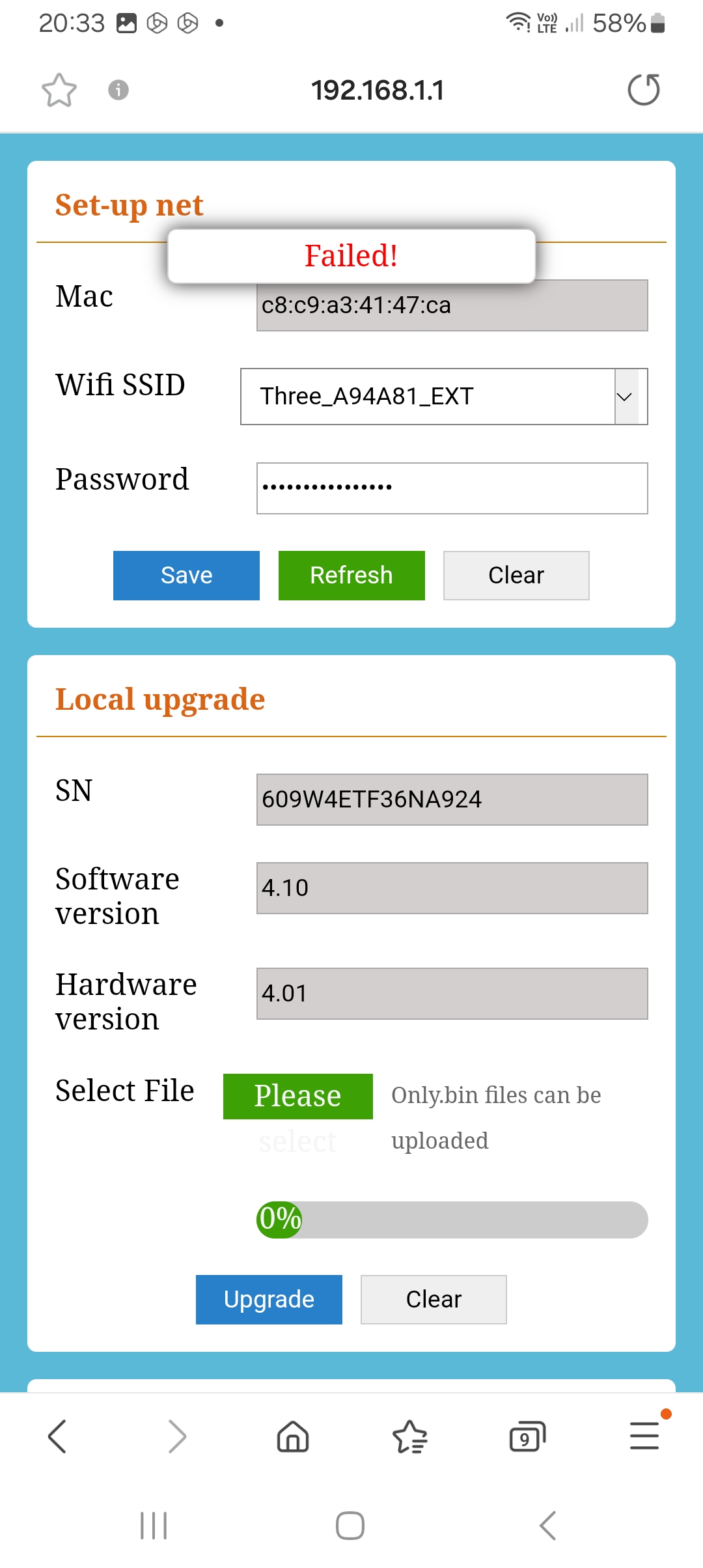

It is flashing red quickly. I get as far as connecting in browser and it finds my home WiFi but when I save it constantly fails.thanks Gary
I am using a Samsung android phone to do this and I am turning off automatic connect WiFi and selecting manually.
ok, thanks for that - it does appear to be failing to join the network, I guess you've double checked the obvious things like the password is precisely as set i.e. O not 0 (zero) and there are no full stops anywhere in it etc..
The only other thing I can think of is , some it gets confused with some routers / extenders as they have both wifi bands (2.4Ghz & 5Ghz) on the same SSID - the datalogger can only connect to 2.4Ghz - if possible can you try and disable the 5Ghz band or rename it so it has a different SSID to the 2.4Ghz band.

Hmmmm, confusing.
So just a couple of thoughts - have you tried connecting your phone direct to the extenders wifi to prove it can accept a connection and give internet access
and the only other thought would be to simplify the name of your wifi extender and remove the '_' characters - i've never tried it with anything other than normal alpha characters and whilst it's clutching at straws it might be worth trying it to discount it.
If that doesn't work I would suggest you email Fox service and see if they can suggest anything, as failing that it might need a new datalogger.
