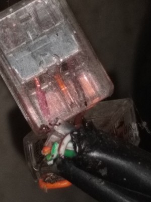

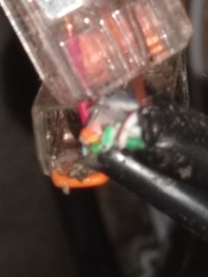

Although difficult I've managed to open up the connector and, contrary to the picture shown in Nathan Marlor's (excellent) guide the existing wire has only one connection, to pin 7.
There's another wire in there but it's not connected to anything!
Should it be connected into pin 8 according to Nathan's picture? It's quite possible I disconnected it (although I didn't see it happen).
In fact it looks like they've used an ethernet cable because the connected wire is actually a twisted pair (blue and white, both apparently in the connection) and the free-flying one is brown and white, although only the brown has exposed copper cable. I s'pose they might have only tightened the screw on the white and it got pulled out...

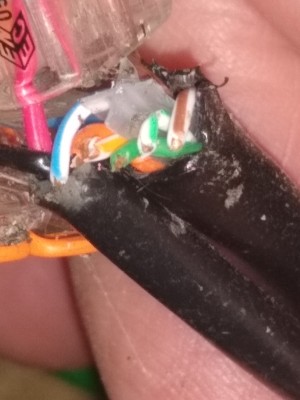

I'm not sure that tells us much, the standard CT clamp is a white clamp with the words 'Split Core CT' and 'CTSA016-100A' written on the top - it has a black sheathed cable that comes out of it but the cores inside are black and white and I can't see that in those photo's - that might mean they have used a different CT clamp or put a RED sheaf around the white cable.
But going back to your original post you thought they had used 2 twisted pairs a blue and white and a brown and white (if it is a cat5 cable the whites would actually be white/blue and white/brown stripes) - we can see that the brown/white and blue/white cables have been left cut which suggests it is the brown and the blue cores that are carrying the CT signal.
Without a better picture and reading back through what you said I would suggest the cores that should be connected in the meter connector are BLUE to Pin 7 and BROWN to PIN 8
Note at the CT end the RED core looks like it might be loose in the connector so worth double checking that hasn't been pulled loose.
Strange that, at the inverter, the blue and white and the blue should both be wired into the connector if they only connect one of them at the other end?
I assume both the brown and white and the brown where both wired in, but those were the free-flying ones when I opened it up.
Any road up, I think you're right. I acquired a pair of wire strippers and managed to strip and then connect the brown (as well as the brown and white) and now it is working!
