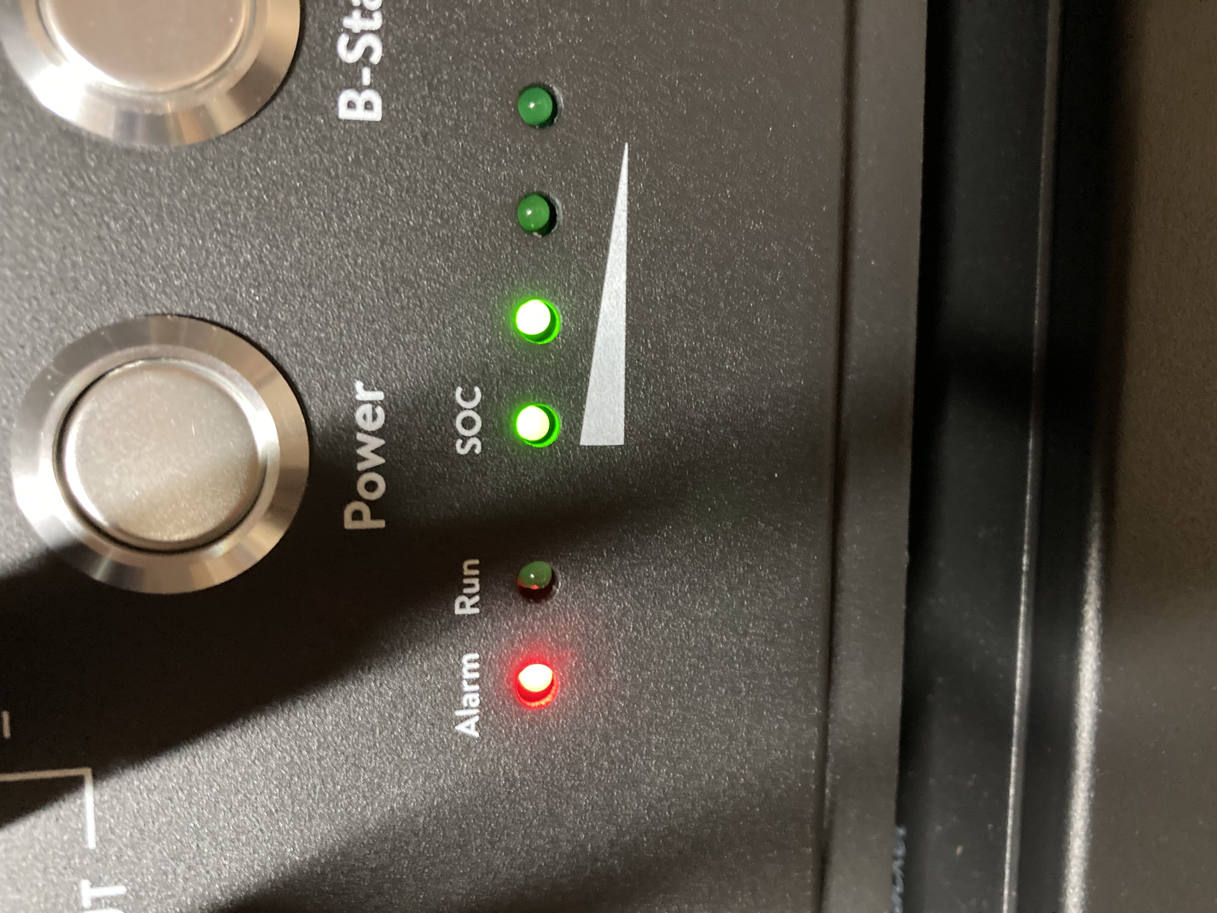

But shortly after power on the red alarm flashes and buzzer sounds with the SOC lights in the BMS appearing to show error code for module addressing failed problem if I am reading the error display and manual correctly.
Red alarm led and the two left hand led lit green on the SOC display.

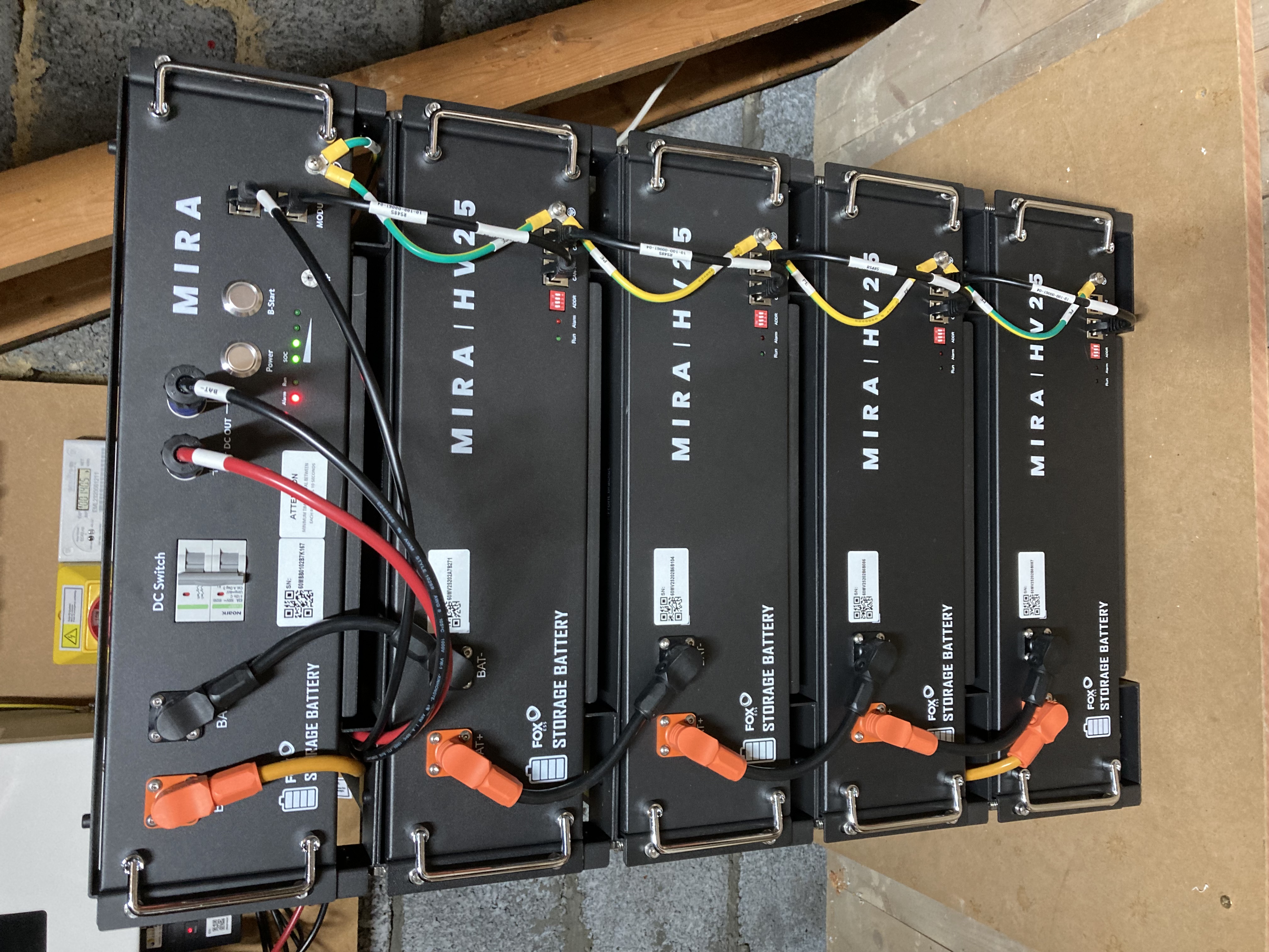

Can you post an image of your battery stack please, might help to work out the problem.
Also I know you said all the addr dip switches on the batteries were down, but I have seen batteries where the dip switch was installed upside down and so ‘off’ was up - look very carefully at the ‘on’ label to confirm the orientation.

Photo attached..
I have carefully checked and the addr dip switches all have the on label correct orientation.

It all looks to be installed correctly, and I can see that the new battery is the first in the chain, it is possible if the firmware is very old that this is causing the problem and Fox will be able to update the BMS remotely and then move on to updating the slaves - they will also be able to check which pack is reporting the error. Another possibility is a faulty interconnect cable.
