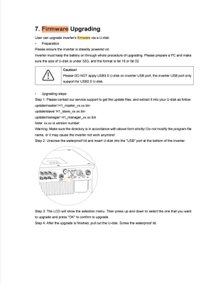

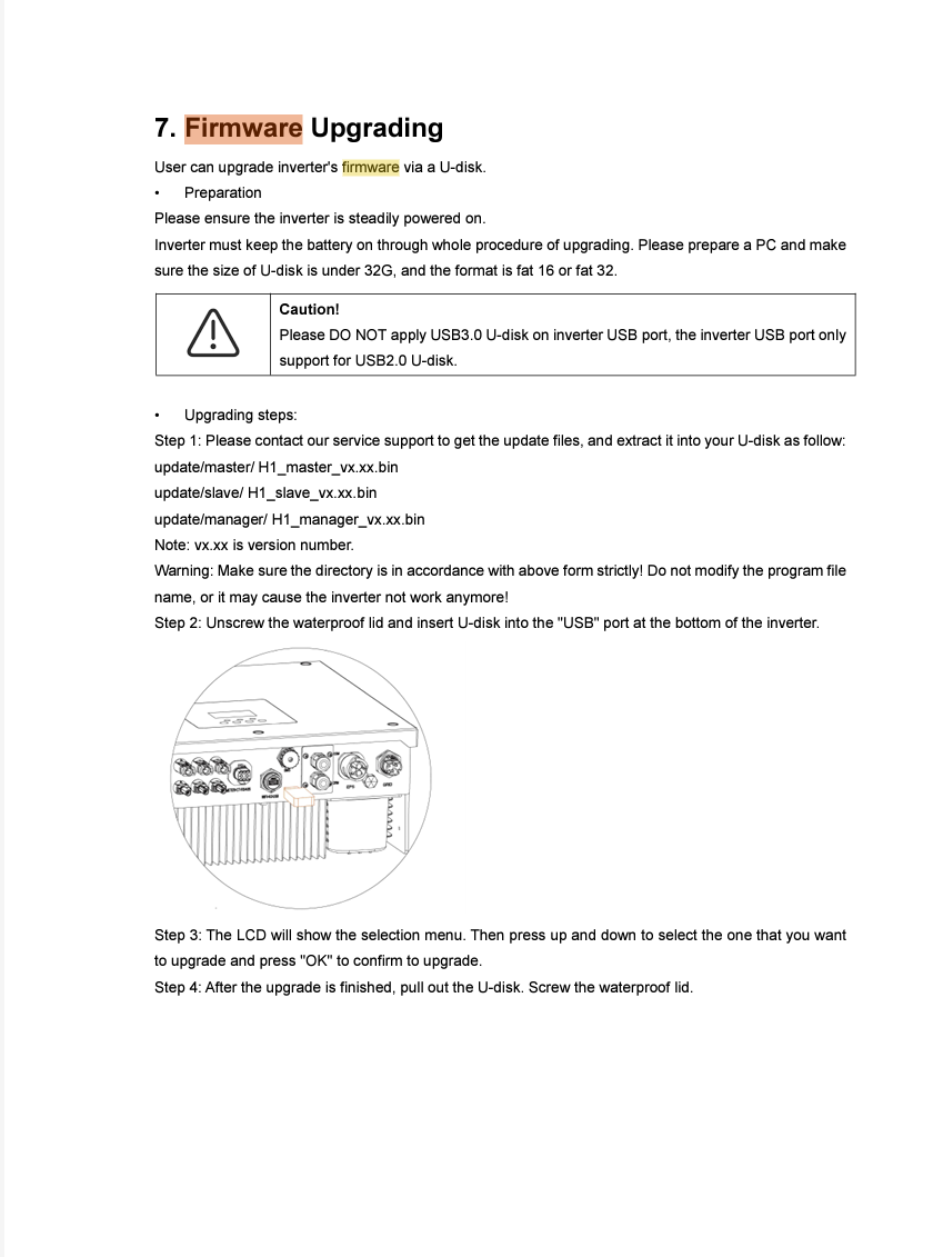

See attachment below of page 32 of the H1 manual. There is a file naming and folder structure to use.
Thanks, but that only explains it for the inverter itself.
