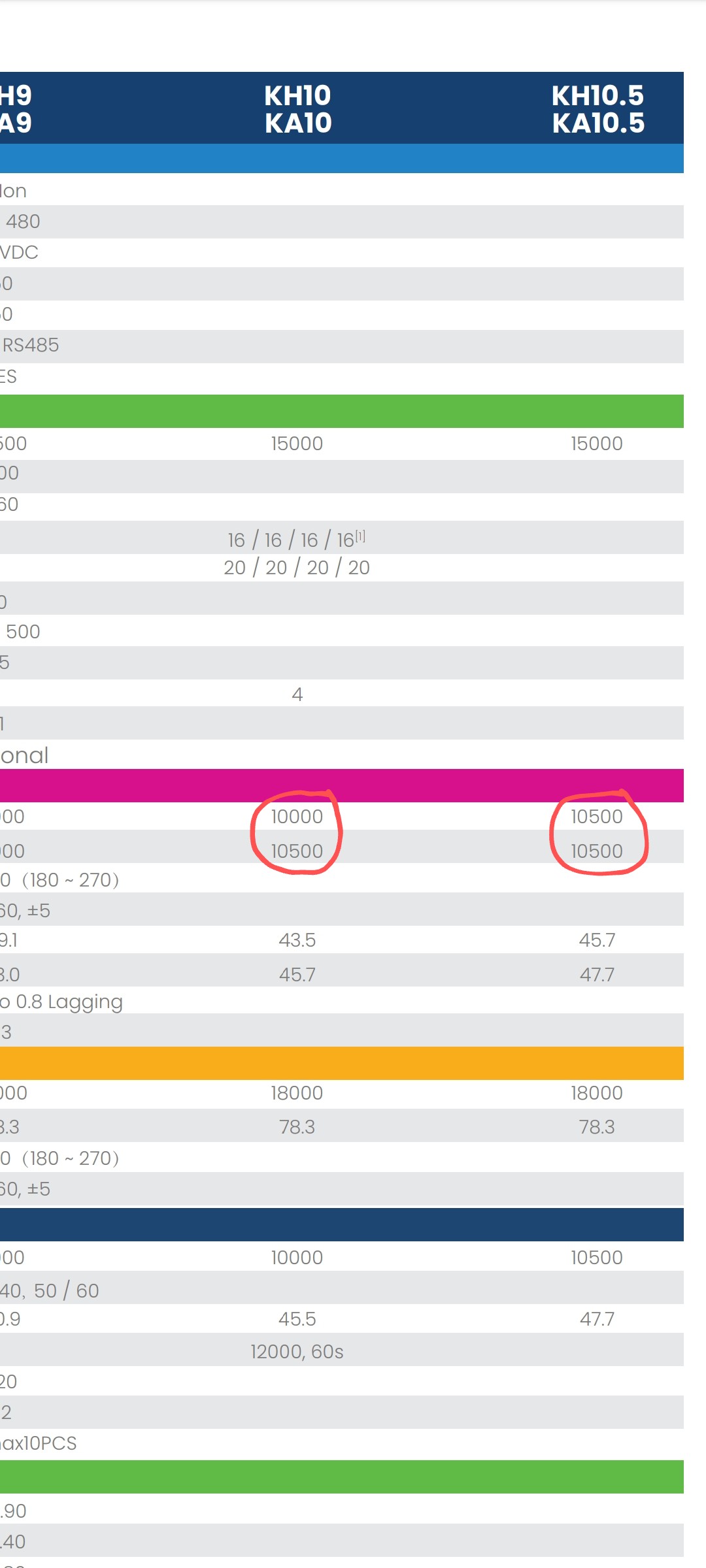

Kh10.5 max power
- Posts: 1872
The 10.5 kWh is it’s maximum AC rating it won’t deliver more than this as export, but it does have a short over burst to cover a few hundred watts of house load - you are also looking at the batteries (DC) and so you will see 2 or 3 hundred watts extra there because of conversion losses.
