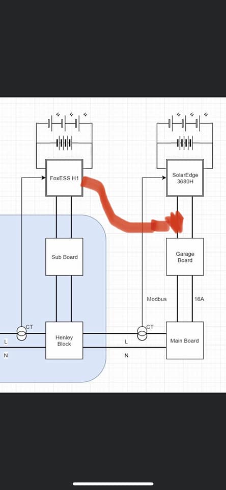

Probably a lot of messing but you if you install them in series with a split load (i.e. 2 consumer units) you can get them to work separately without fighting between them. I’ve copied an old post that shows an installation. (The red wire is a link from CT2 on the larger inverter to the secondary to measure it’s feed).
