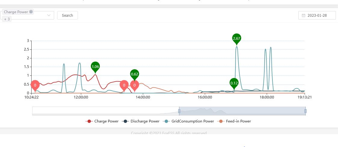

Unfortunately, my system is still unresponsive despite the lack of "forced charge" settings for 24hours. I think it is best illustrated by todays record as copied in below.
During the sunshine in the middle of the day, the battery was charged but the grid was still used to deal with short peak loads of 1.8kW which means the battery reached 100% sooner. Then the excess energy could only go to export to the grid.
Later when the oven was on between 4pm-6pm, all but 0.12kW, came from the grid. The discharge rate remained steady at 0.12kW all through the afternoon (as it had been from midnight until the panels began to generate power).
I have the same data in other forms but I think the image below is explicit. FYI the reported battery temperature is around 13deg C.
What might be wrong ? and can I sort it ?

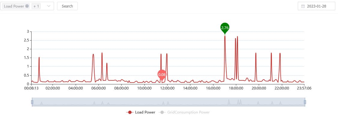

Could you show me the house load that corresponds to the same time period above , the load is shown on the site overview (first) page when you log in.
And also a couple of things to check in your inverter settings - you’ll have to do this at the inverter panel, go to settings, 0,0,0,0 enter, then work mode it should be set to ‘self-use’
And also from the Settings, go to Battery and let me know what your minsoc, minsoc on grid and maximum discharge current are set to I would expect 10%, 10% and 35A
Many thanks, Dave - I had already double checked the settings on the inverter and the operating mode has been "self use" throughout. Both min SoC were set to 20%, but I have just changed them to 10%. I am not clear why that would influence the responses so much.

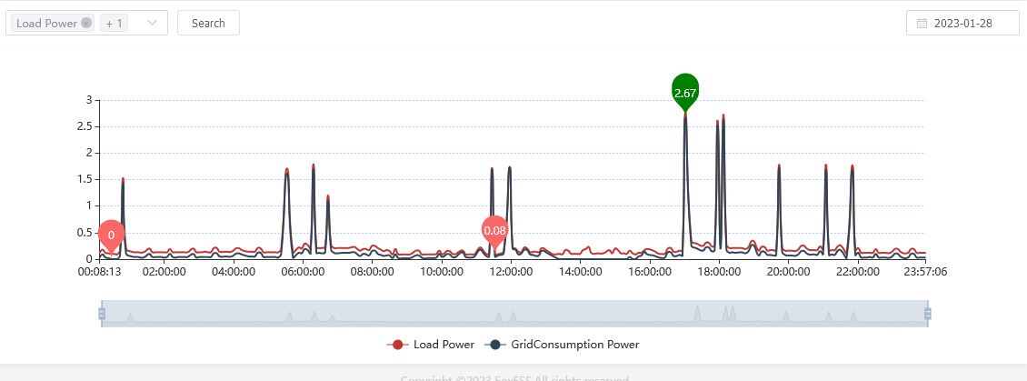

Here is the Load graph for Sat. I have added for comparison that graph along with the Grid Consumption which follows it very closely - the latter is less the 0.12kW of battery supply apart from when the sun is shining. I can confirm these numbers relate well to the figures I see on my smart meter IHD of instant reporting of grid consumption.
FYI I know about the regular demand 1.7kW peaks throughout the day - they come mostly from our instant boiling water unit which heats up for about 30secs approx every 40 mins or so - of course with the strange snapshot reporting of Fox, the chances of it being spotted depends on whether the snapshots are or are not in sync.
Load Graph Load v Grid Consumption graph I'd be delighted to hear your opinion or from anyone else who has worked out how the BMS is supposed to match house demand

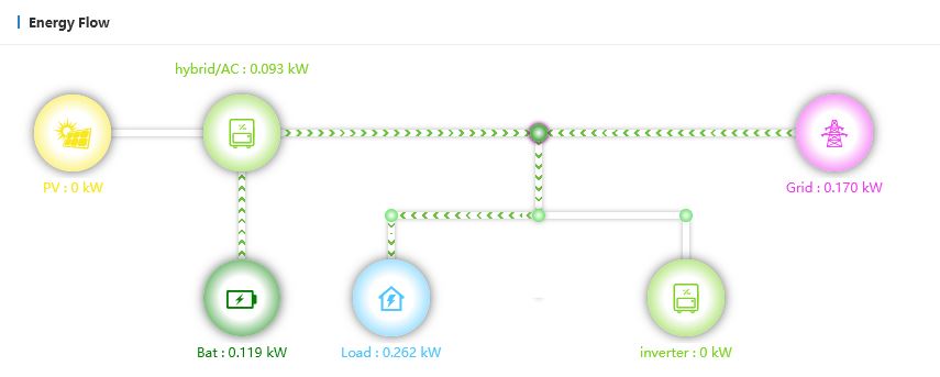

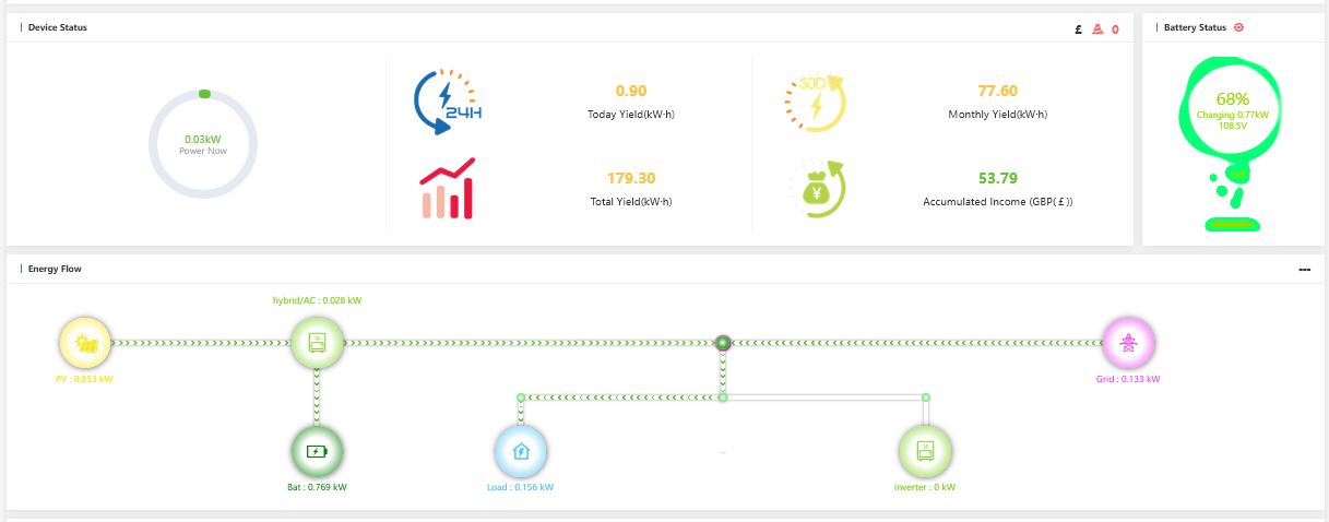

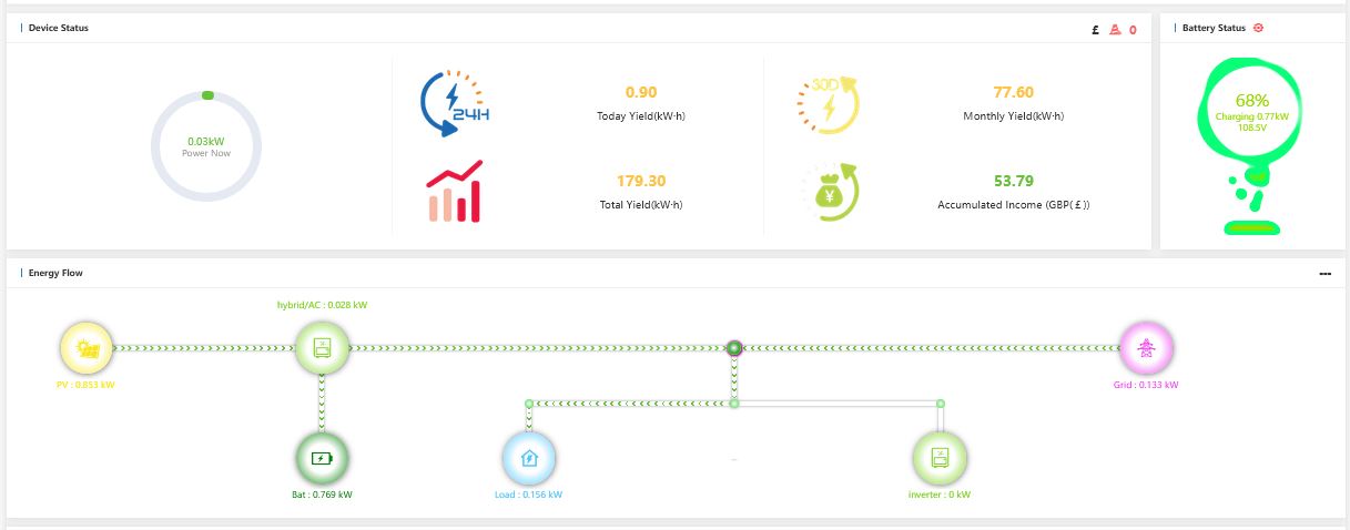

Ok, very strange - can you have a look at your ‘real-time’ power flow, is the direction of power flow what you would expect i.e. towards the house for load, and away from the grid for consumption
I should have added, looking at your graphs assuming the battery is sufficiently charged (> minsoc) the inverter/BMS will respond to demand almost instantaneously and so you would not expect any pull from the grid.
When a large load such as kitchen hob, kettle or heat pump turns off there is a small window of time where the inverter will dump the excess power from the batteries to the grid before it corrects so you should expect demand to be met by your batteries and the occasional short peak of export when the load turns off - that’s not happening at all which makes me wonder as to whether your inverter is correctly measuring the direction of flow.
Thanks again, Dave - in terms of your first question, yes I believe the flows are all in the correct directions. If I understand correctly, the image you want to check (as just captured) is:

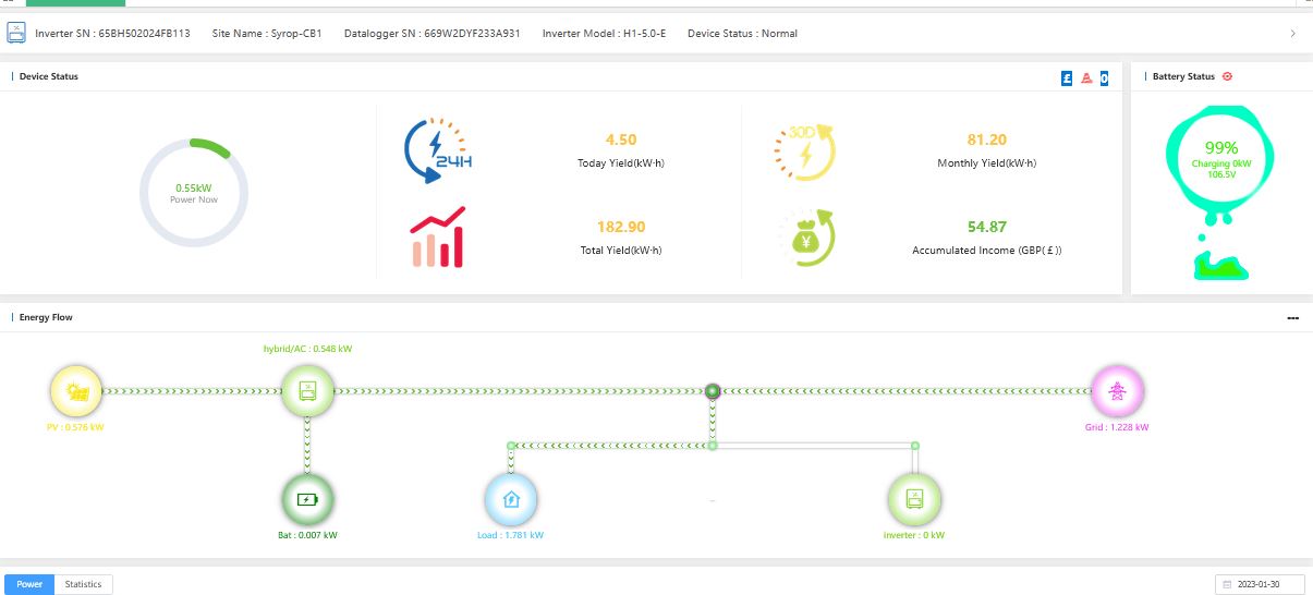

FYI the behaviour is perlexing in other ways. Just now there is sun and some demand from the house but it chooses to charge the battery and only slightly meet the house demand, drawing the rest from the grid ! See below:
Many thanks again for your checking it out and the advice - I'll report more this evening

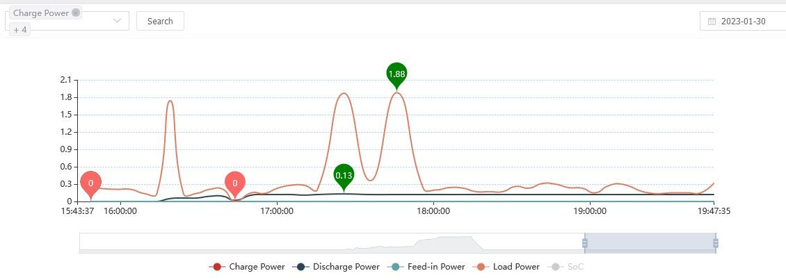

I rebooted the system as suggested at 4:45pm - so far no change in behaviour, and still a steady 120W only feed to the house. see graph below:
No errors on reboot except as expected at time of turn off, see below:
Further, I see the behaviour at midday was to keep feeding the battery even when excess was going to the grid rather than meet the house demand. It seems to me the priority is battery before self-use - how can that be ?
Apart from getting FoxESS directly involved, has anyone any other thoughts ?

Everything seems to be going to load, even when the load is lower than what is being generated. My smart meter shows export however so it seems something is off.
Seems my CT somehow got disabled, not sure how as I hadn't accessed any settings until the battery stopped responding.
Now using battery power and not grid power again.
