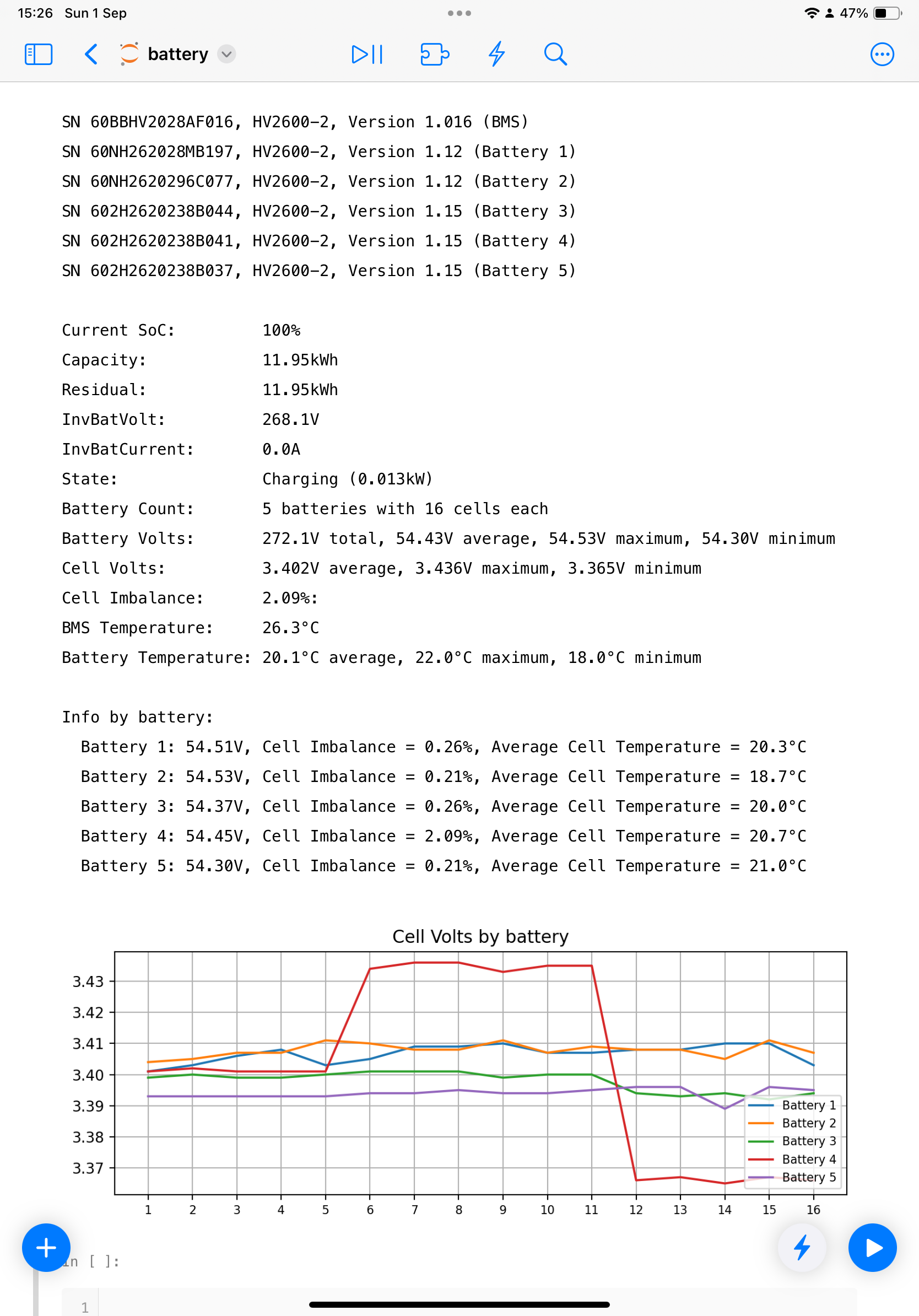

I seem to have an issue with battery capacity rapidly reducing, hoping someone can recognise what the problem might be, and what's a likely solution.
Over the past ~6 months I've noticed my battery capacity doesn't seem to match expectations. I have 4x 2600, 2 are V1, 2 are V2 and a V2 BMS. Total of 10400kWh, not accounting for losses, reserve, etc).
This has been most obvious today. This morning (early hours) the pack charged from 28% to 98% in 1 hour (~7.5kWh), but the max charge rate is around 4kWh. This afternoon it's discharged from 72% to 15% (~6kWh capacity) in 30 mins, max load of 1.08kW, average around 0.8kW for that time period - around 0.5kWh used.
BMS min temps are 10C or above throughout today and last night, so I don't expect this is cold temperature related.
BMS cell mv Highs and Lows generally track together, but when charging there does seem to be a 100mv gap. There have also been some spike/dip pairs where the mV high goes to ~4490mv and mv low goes to 2210mv at the same time - this happened on 24/12, 30/12, 02/01. The rest of the time the max/min is between 3550/3100.
Does this look like a duff cell(s) in the stack, and if so is there any way to locate it or identify which/how many of the battery packs might be affected?

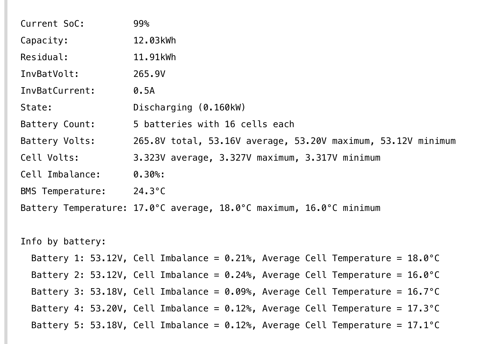

I'm still seeing (last night) state of charge go from 67% to 99% in about 10 minutes, which doesn't add up from the charge rate, duration, etc - 30% should be about 3.4kWh, and in 10 mins would need a charge rate of 20+kW, not the 4kW it was at. It is then charging at 400W for over four hours, so seems to be trying to balance.

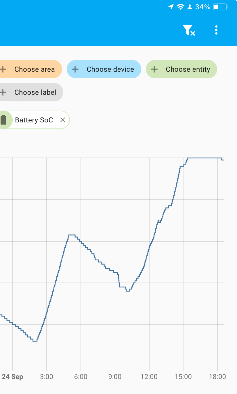

Looking at the charge profile last night I'm still seeing SoC jumps of over 50% in 5 mins. I did see that a year ago you mentioned to Luke about splitting the stack into v1 and v2 groups, charging them both to 100% separately, then letting the pack fully discharge/charge to help the BMS reset where it thinks the limits are. Is it better to have the stack at 10/50/100% before splitting, do you know?

The battery stack is in a garage, so while it's not heated, it doesn't go below 0C, and very rarely goes below 5C (didn't this winter). I am looking at getting a server rack / cabinet, with some fans, so I can ventilate in warmer months and keep them a little warmer in colder months.
Probably better if you let them do a few cycles with the minsoc at 10% but in all honesty if that persists I would be sorely tempted to raise a ticket direct to Fox and ask them to review your pack, they offer some solid guarantees and if your pack isn't self healing it's possible it could be a dodgy cell - it's likely they will ask you to do some of the things like slow charge, pack splitting etc.. so you may be better to do it under their support rather than repeat it.

Hello folks,
I wonder if I can revive this thread please.
I'm having the same sort of problem — quick jump from circa 80% to max. I've gone through this thread, following the same steps — firmware was updated on Friday (thanks Martin at FoxESS UK!) and batteries are now 1.15 for the three v1s I have, and 1.12 for the two v2s.
I ran the battery script in Jupyter too, and noted the attached. Is this suggesting battery 4 just needs to get its act together, and would separating v1s and v2s for discrete charge cycles help, or is it suggesting a deeper issue? I'd most appreciate an experienced view, and whether I just need to give it longer for some 10% to 100% cycles to balance things out with the new firmware.
Many thanks for any thoughts!
--Mark
--Mark

- Posts: 1850
Battery 4 is out of balance, not specifically with the rest of the pack but inter-cell balance is not good - that could be the result of running on older firmware for a prolonged period and is most definitely what is causing your pack to jump at the 80% and likely to be causing it to drop near minSoC as well.
Usually you would expect to see a few cells low or high, but this pack is showing a bank of cells that are high, a bank of cells that are low and the rest are in-line with the other packs.
Breaking the pack is a lot of work, so first it would be a good idea to go with the easier option (which is very likely to correct it) and change your max charge current to 3A you can do that at the Inverter panel - Settings, Battery, Max Chg Cur.
That would mean your batteries will charge at 700-800 watts which will take some time to charge them but it will give them time for the cells to balance.
Make sure you take a full charge all the way to 100% and hold it there on charge for a couple of hours - that will help the inter-cell 'high' balance.
But before you do that you need to flatten the batteries, make sure your minSoC's are both 10% - use the batteries normally and let them drop to 10% (they may well overshoot the 10%) and wait for the BMS to cut power from the batteries - once it has, keep the pack at minSoC (don't charge) for at least a couple of hours - you will likely see the BMS do short maintenance charges (around 1000 watts) as it 'bottom balances' the pack - in effect what will be happening is the inter-cell 'low' balance will be correcting when this happens.
Once you have done a full cycle like this - then change the max charge current back to 35A and use the pack normally for a few days, if you could then re-run Tony's script as they approach 100%.
Fantastically detailed info Dave, many thanks for taking the time to write that! As luck would have it, it's tipping it down outside, I've just stuck the oven on, and the SoC has hit 10%.
I've dropped the charge rate to 3A via HomeAssistant, and disabled your helpful automation that was dropping it to 5A after 80% anyway.
Let's see how it goes. I shall update the thread in a few days' time!
Many thanks again.
Many thanks again.
