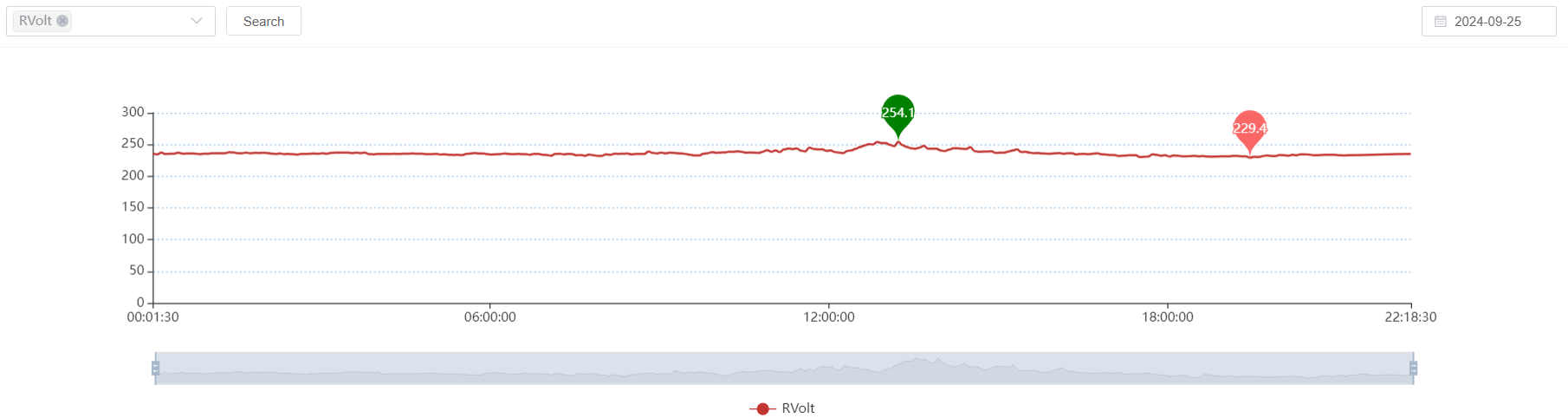

The RVOLT spiked on 25th, but has not spiked again:
I followed the manual and disconnected the unit on 26th. First a few minutes, then for half an hour. Unfortunately it did not fix it, and does not invert anymore: I did not touch it today: It keeps being stuck in the loop: 60s checking, restarting, 60s checking, restarting,... No production either today... I'm in Belgium without local Fox service, but will contact them in the Netherlands.
- Posts: 1873
Ok, your voltage looks good and is in-line with what you would expect so I think the relay fault (an internal error) is causing this - I know that Fox can remotely diagnose and have implemented fixes for this fault remotely - so will wait for Fox support to get back to you.
