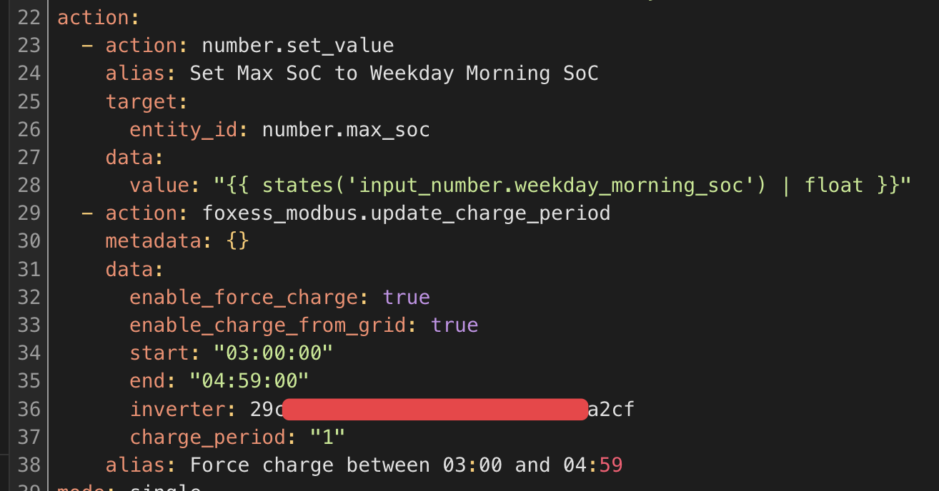

I'm using the nathanmarlor/foxess_modbus integration and have an automation that takes a target SoC number value that's configured on a dashboard slider, sets the Max SoC on the inverter and then enables charge period 1 between 03:00 and 04:59. If I set the slider to 70%, for example, it still charges to 100%. Connection is via RS485 and Waveshare adapter.
H1-6.0-E-G2
Master: 1.21
Slave: 1.02
ARM: 1.32
The automation is configured as follows:

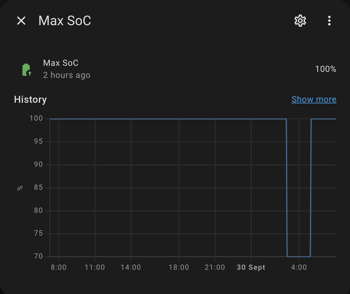

I can see from the sensor history that the Max SoC does indeed change from 100% to 70% for the duration of the charge period:
But here is the reported Battery SoC for the same period:
My expectation is that it would charge to 70% SoC and go no further. Can somebody tell me if I'm missing something obvious here, either in my configuration or understanding?
