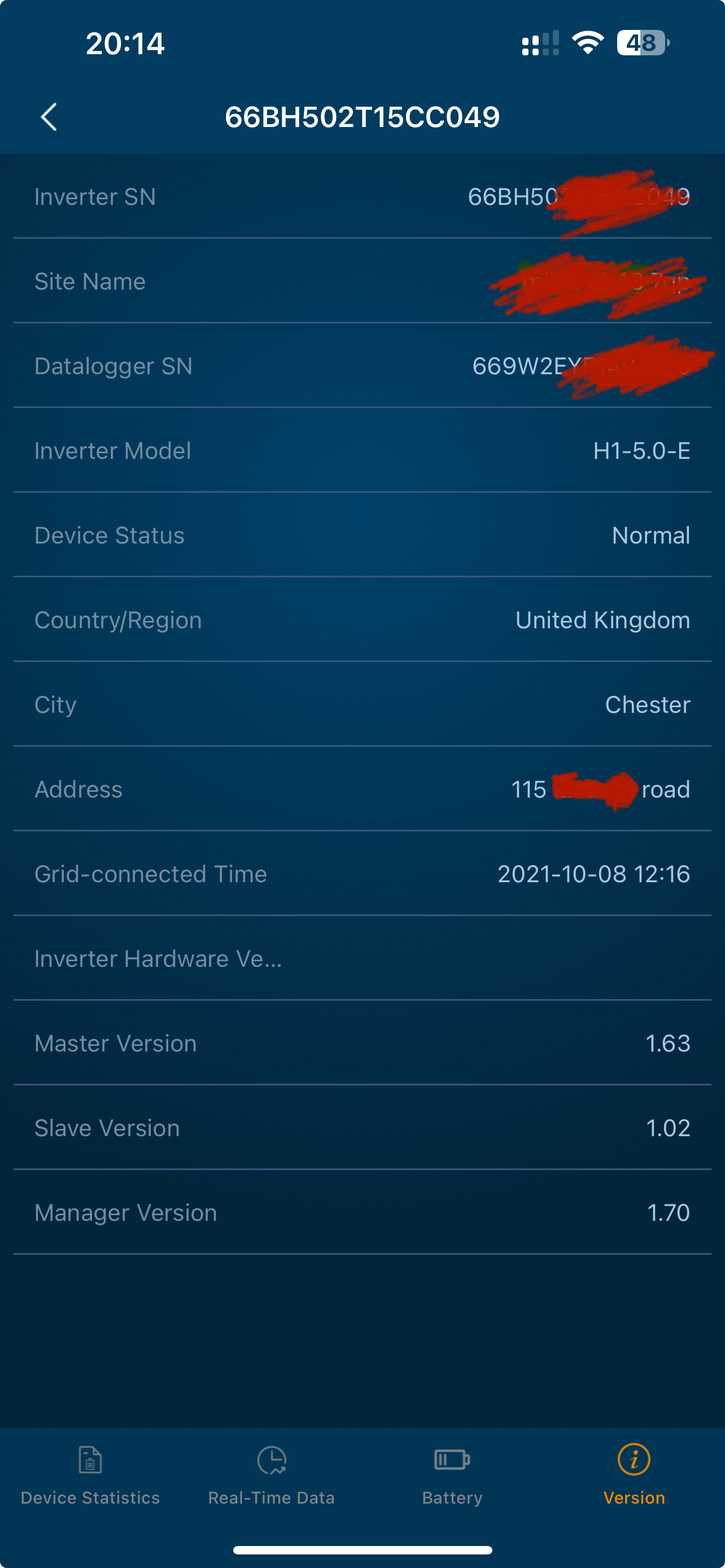

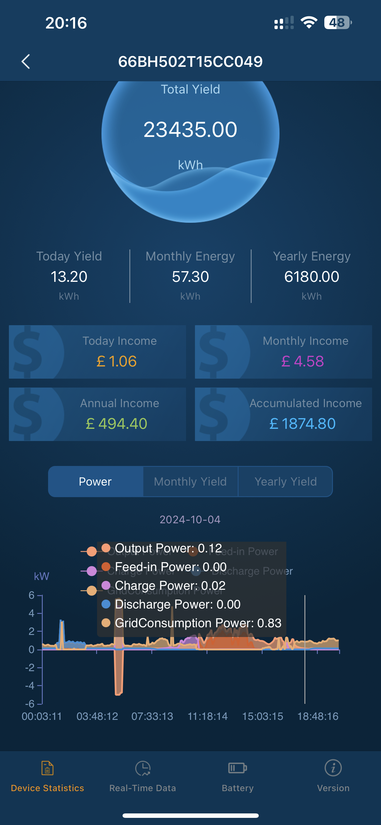

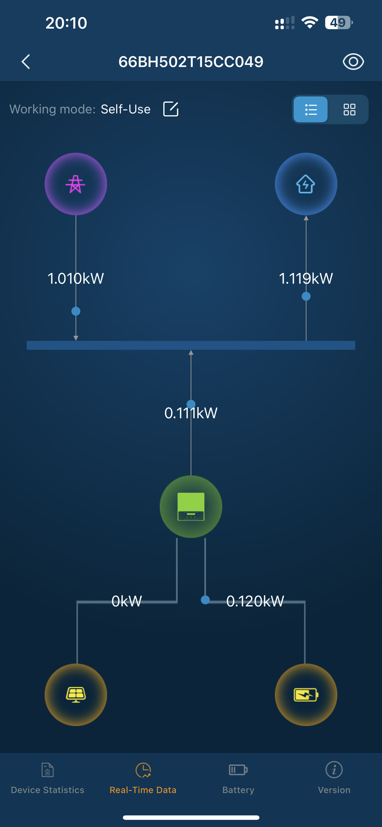

My system has decided it’s going to use the grid and only the grid. My 18kwh battery’s are just sat doing nothing!
Solar just tops them up and the usage come from the grid.
This has just started happening in the last 24 hours. I’ve rebooted the inverter and the battery’s.
Re: System not using battery storage
Ok I think I have figured this out. The fox app 1 (which I prefer) was all set ok but I must have opened the fox app 2 as the work mode in that app was set to disabled. A bit of fiddling around in fox 2 got it working again. Why are the apps so shite?
