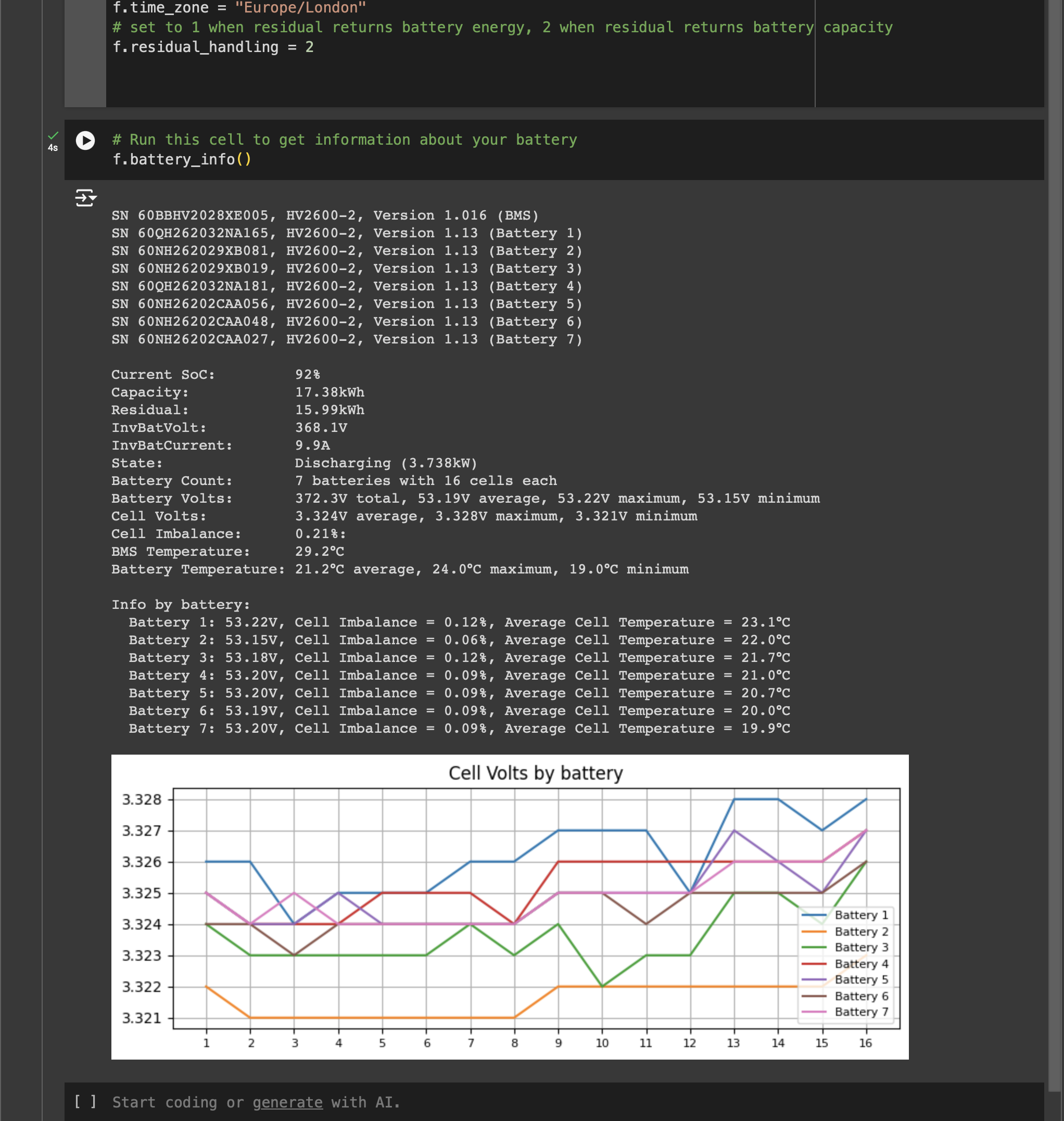

I've ran the battery.ipynb script from Tony's GitHub and can see that I need to set the residual_handling to 2 to get the residual to show kWh remaining.

In home assistant the sensor is reporting what it receives from the BMS, you'll need to add a 'new' sensor to your configuration.yaml file which calculates the value based on residual and battery soc - if you follow this link there is a code solution there https://github.com/nathanmarlor/foxess_ ... 2388489149

Yes it's the latest firmware for all 'V2' battery packs - the new BMS sensor reports the maximum available energy taking into account SoH so this multiplied by your battery SoC is the expected available energy.saleemkhalil wrote: Sun Oct 06, 2024 12:15 pm Is this something new with the latest firmware? It was working fine before.
