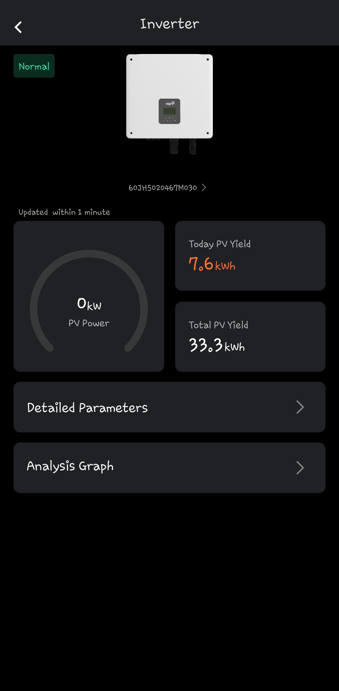

We are totally new to solar having had both air source and solar installed a couple of weeks ago.

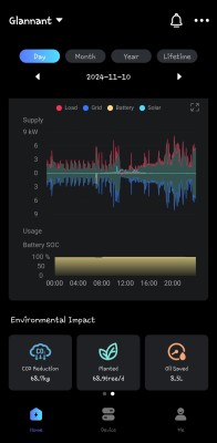

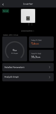

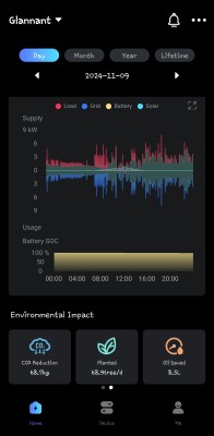

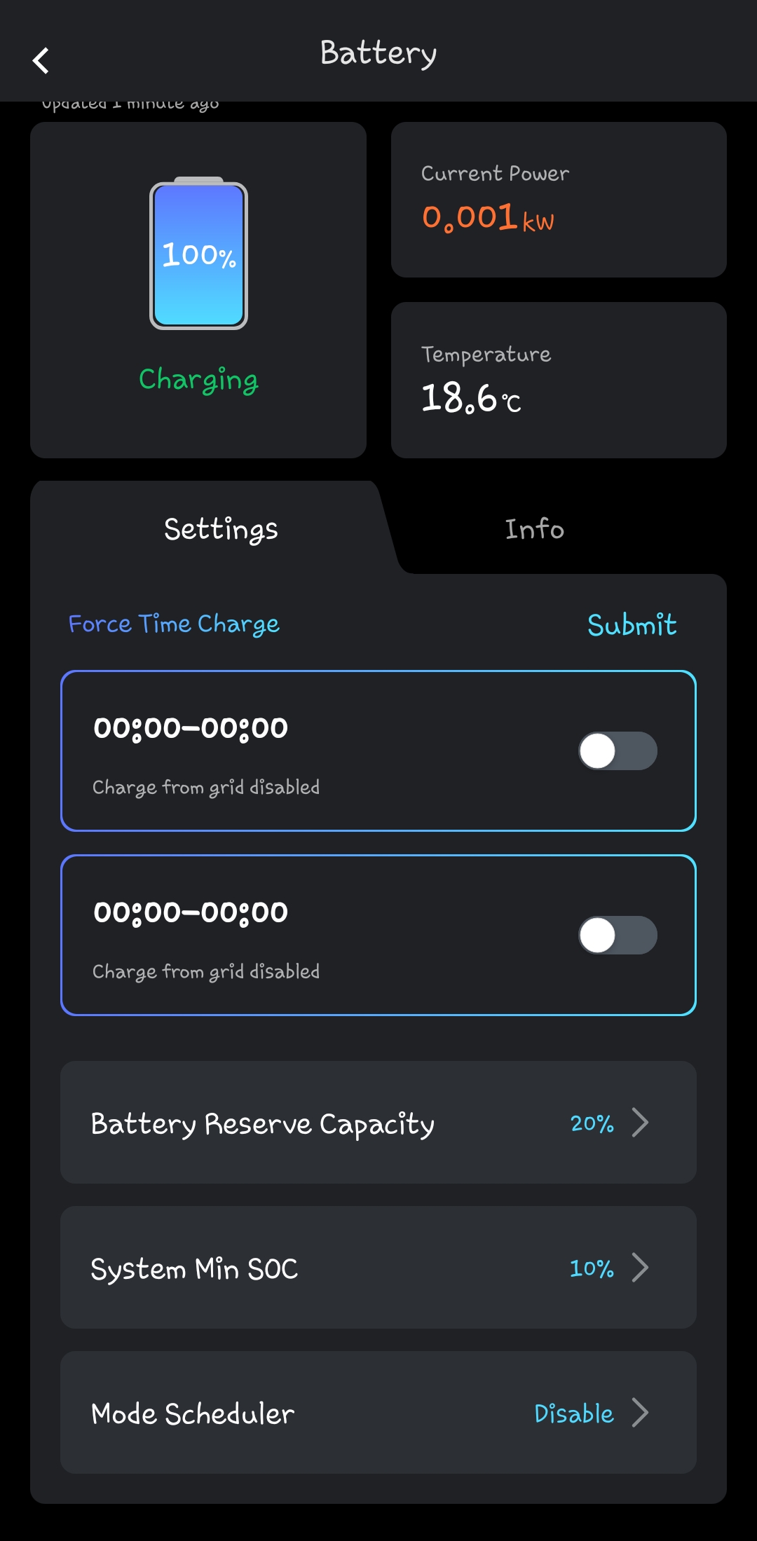

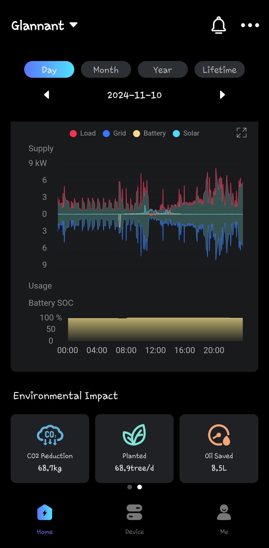

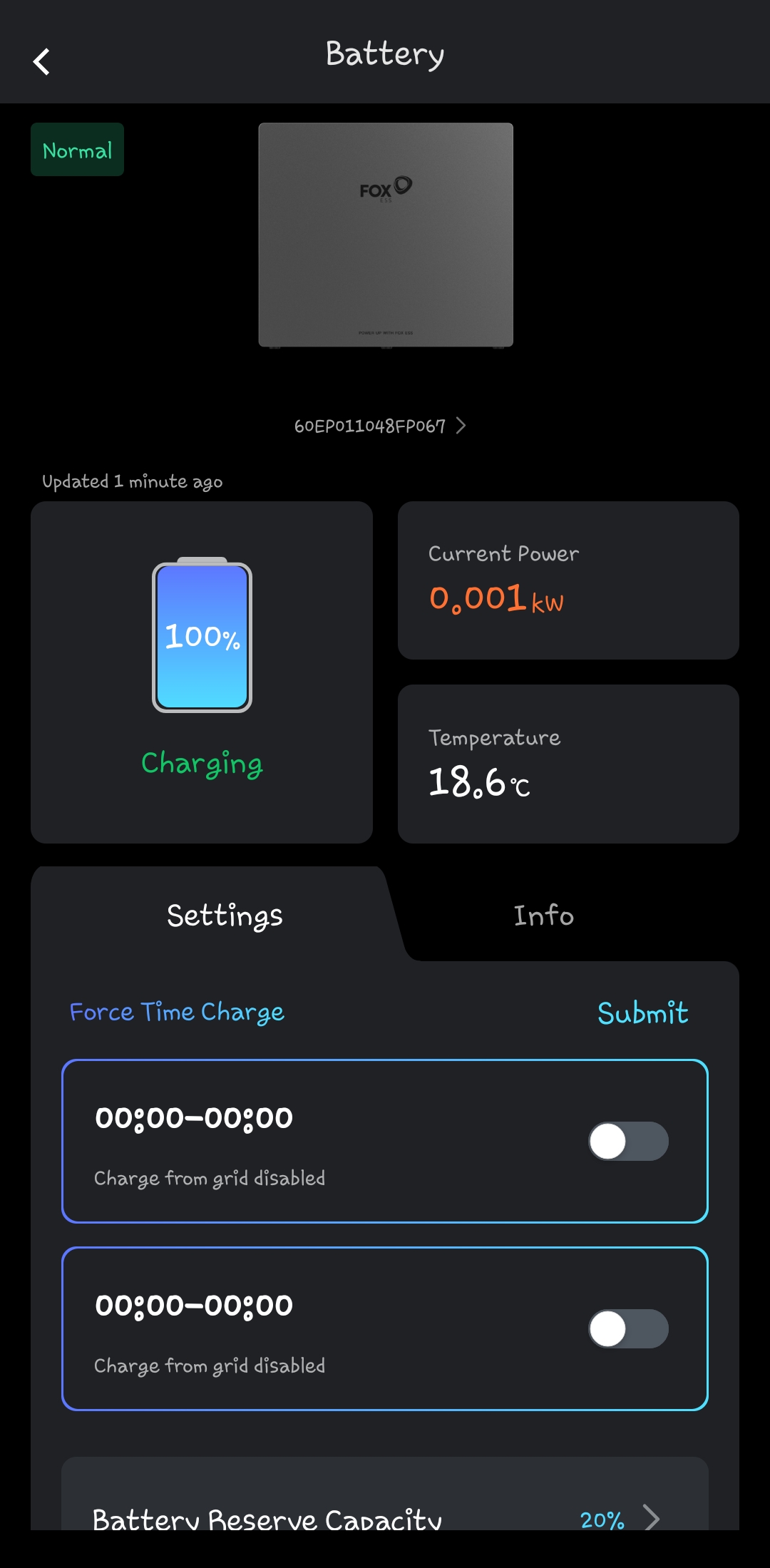

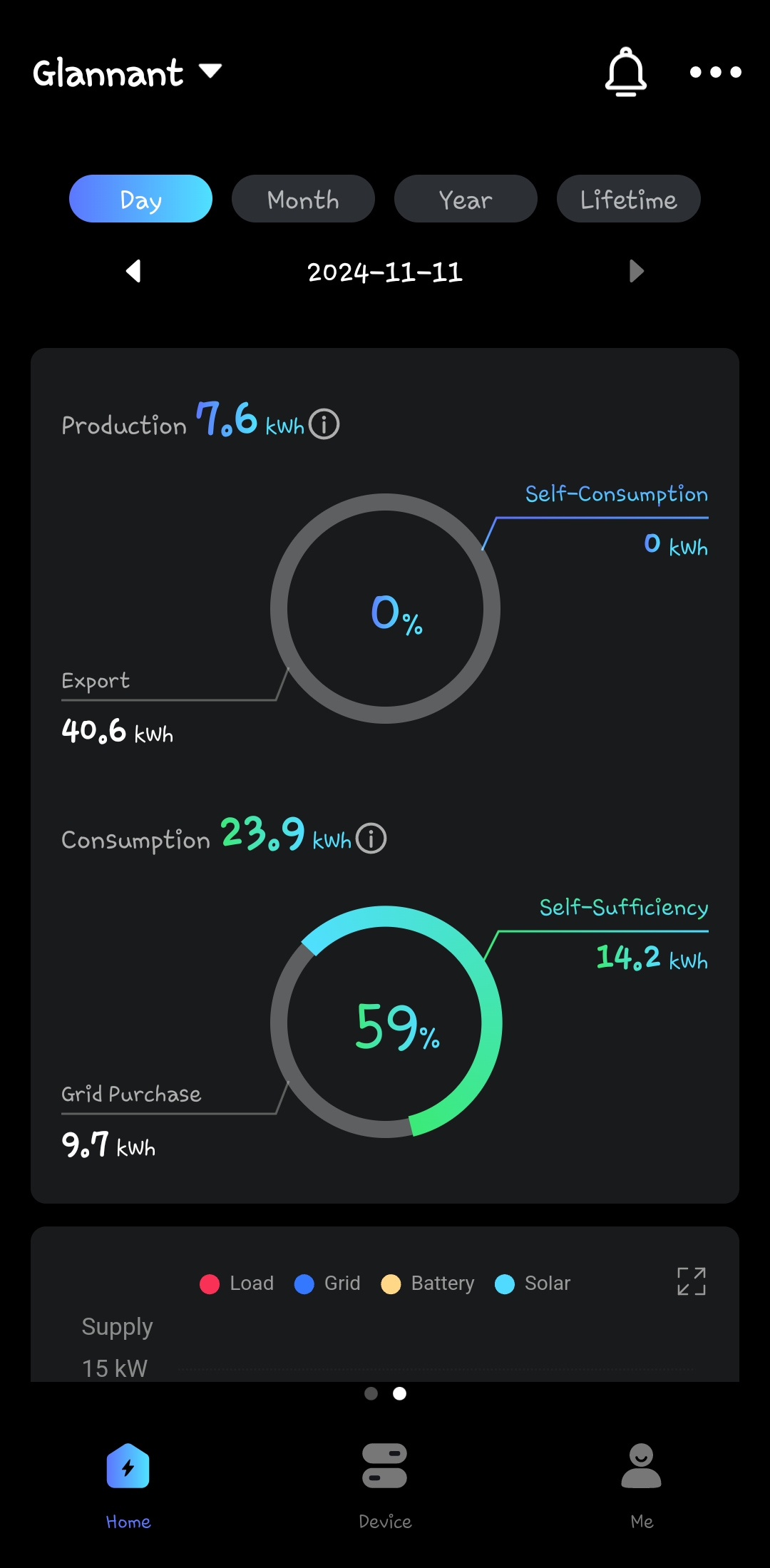

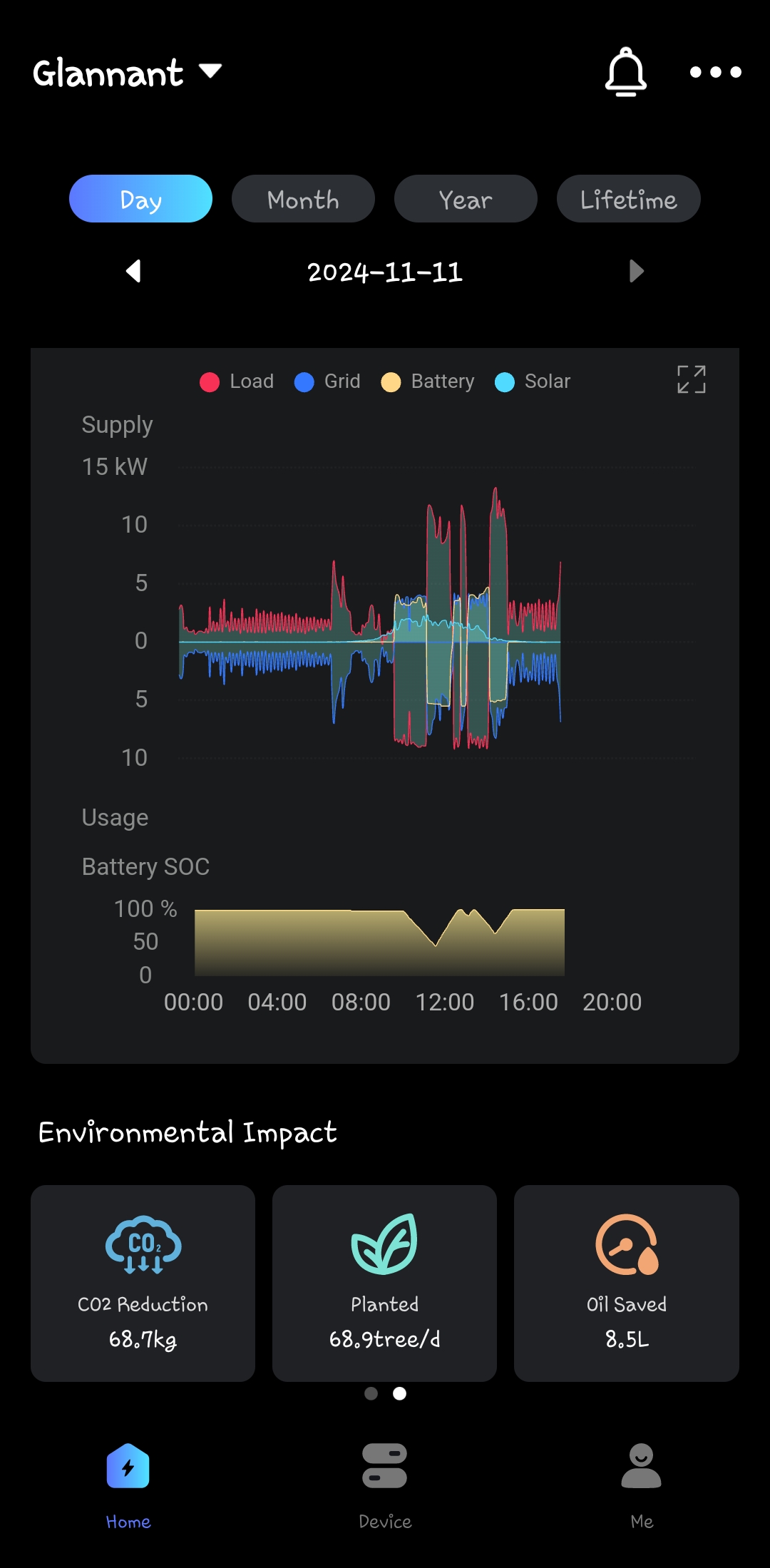

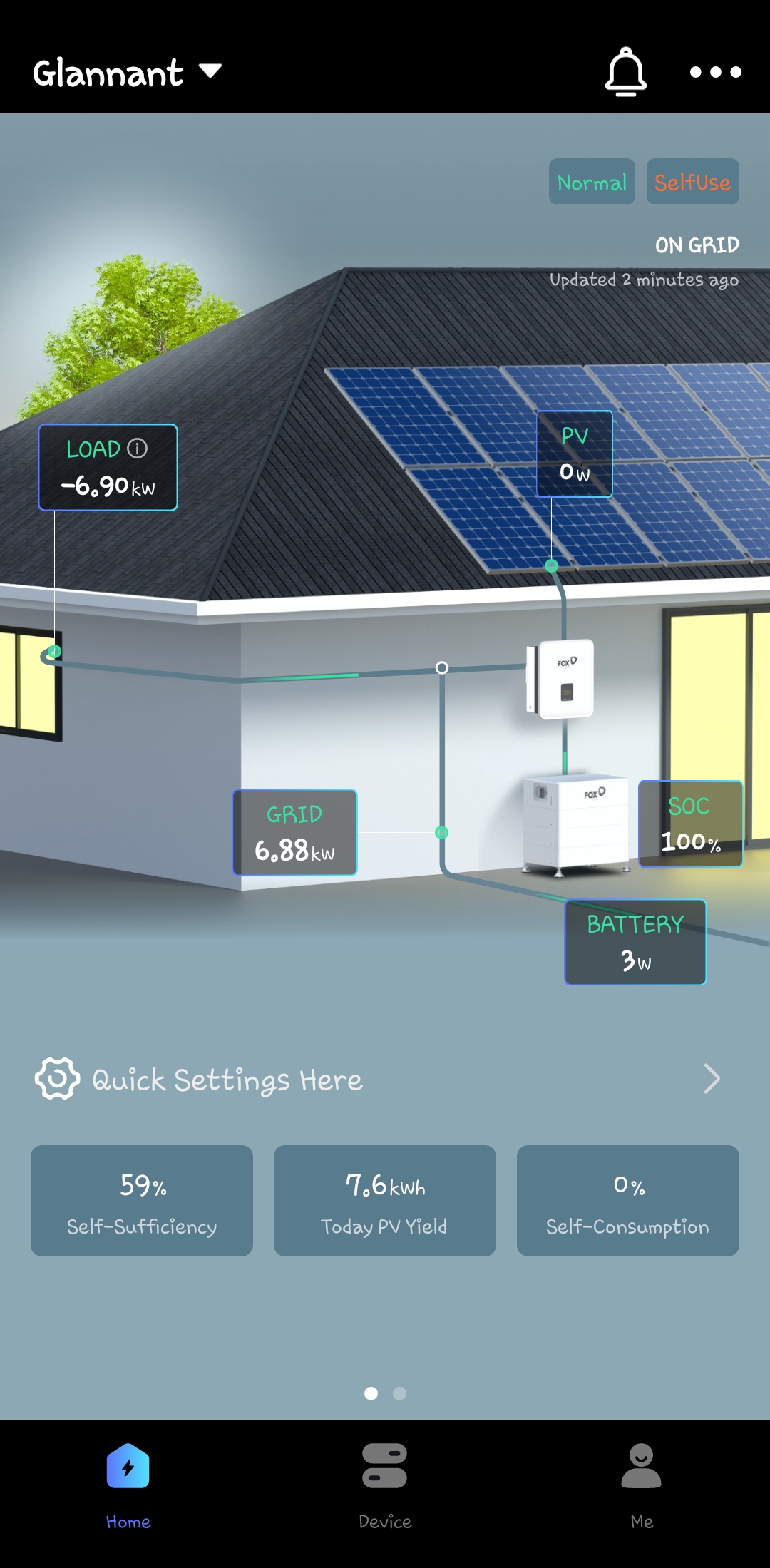

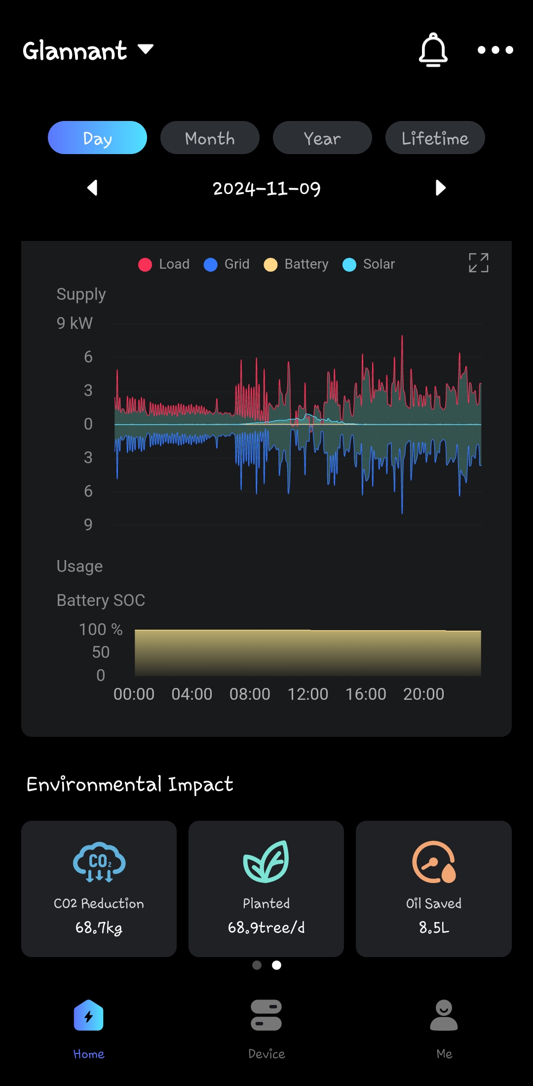

For the solar we have 18 panels, inverter and 10kw battery. I'll upload all the screenshot I have showing the system and our energy flow charts but from what I understand we are currently exporting everything we generate, none is coming into the house, and our grid usage has gone bonkers according to our smart meter/monitor - the installers have just said they don't know what's going on and seem totally uninterested, it's becoming very frustrating.

Your grid and load power lines are opposite to mine in the cloud app, so it looks like a CT clamp issue to me. I've only had mine a few months, so probably wait for someone more knowledgeable to confirm. If you have a picture of your CT clamp position and orientation, that may help someone confirm.
- Posts: 1855
Hi yes agree, you are showing a negative load which suggests the inverters meter/CT clamp has been fitted incorrectly.
The CT clamp is used by the inverter to measure the load, so it knows how much battery / solar power to use to compensate it - those traces are definitely incorrect.
You need to get your installer back and get them to correct the inverters meter/CT polarity.
