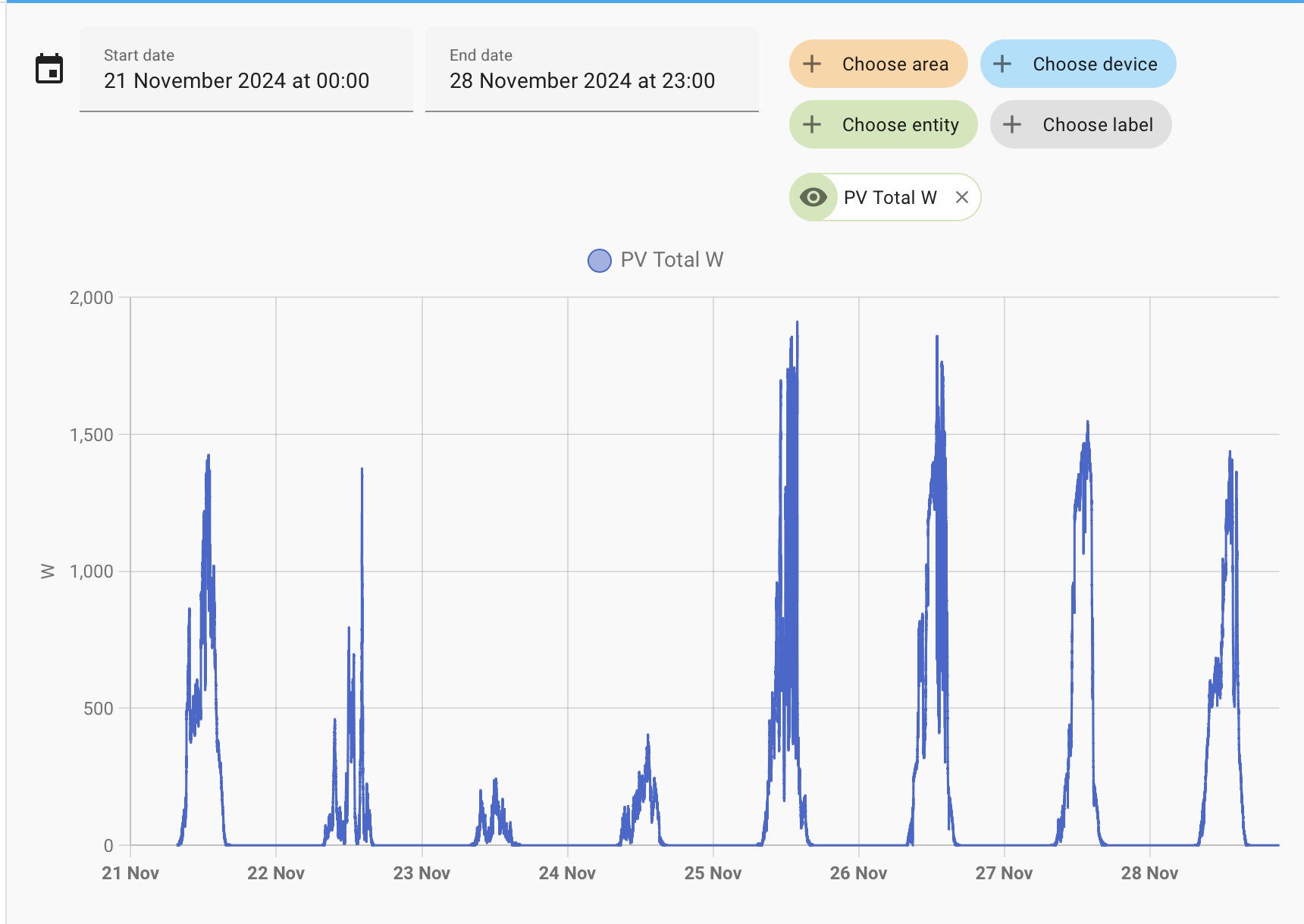

When you say 0.1 - 0.3 do you mean power generated per hour (kWh) or the total generated for the day.
At this time of year, with the suns elevation so low shadows will be a problem early and later in the day and the generation will be almost at the seasonal lowest.
To check for shadows take pictures of the array every hour on a bright day and work out whether any shadows are because of the suns low elevation or something that might occur all year round - if the latter you might want to consider optimisers on the affected panels.
For comparison this is for a 6kWh system over the past week, part east facing, part west facing
