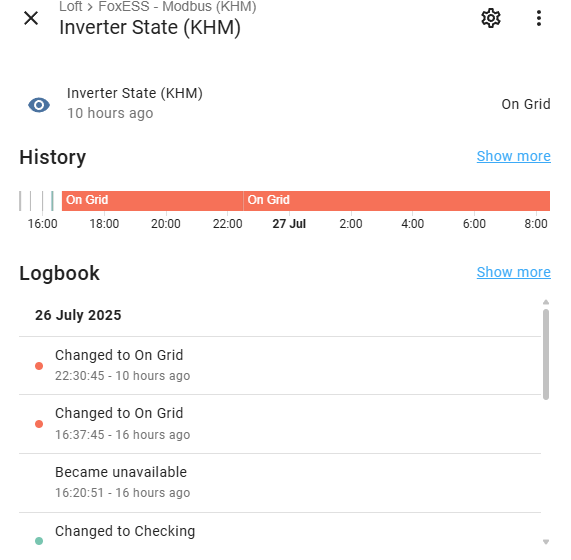

Hello all, I'm running an H1 Invertor, With Home Assistant hooked up to the MODBUS, And was wondering if there is anything for the Dashboard that will show whether there is a grid Outage and that I am running of the EPS? A simple on/off tally maybe? Just to save me going outside to look at the ATS. Had a number of outages recently, and obviously we didn't notice because the ATS kicked over and put us in EPS Mode.
Thanks in Advance
Morning,
Yes, you'll want to use the Inverter State value exposed by the modbus integration. I use it to change a smart bulb to red when offgrid.
