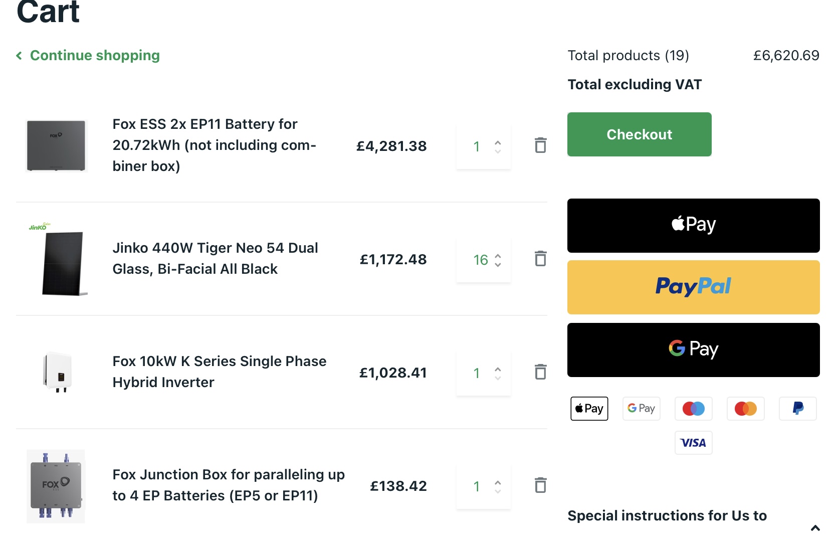

Just had a quote, obviously he will have to uninstall the old inverter and batteries, get the DNO, installation and scaffolding (£600 he told me) so almost £5,000 labour, is that the going rate? what do you guys think of it?

It's a very good quote if thats including the install. Under £12k for 16 panels, 10kW inverter and 20kWh of batteries is excellent.
