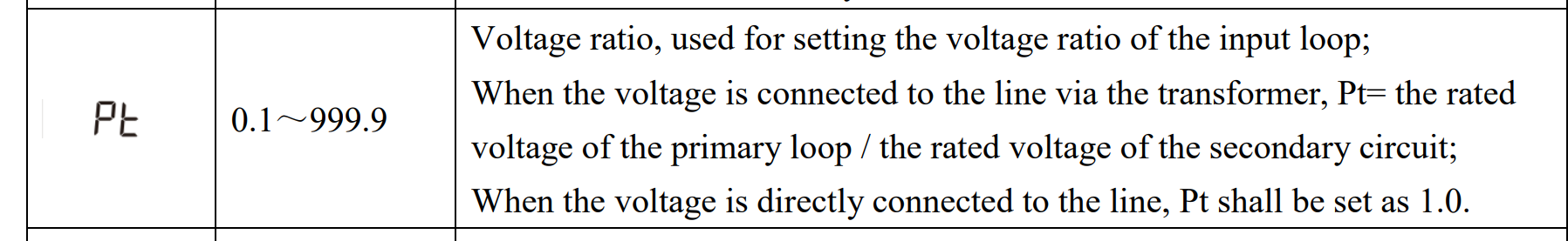

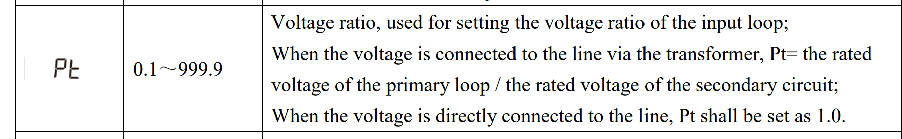

Ref the Chint PT , it is currently set to "1" after reading the Chint instructions i wonder if "1" is correct?

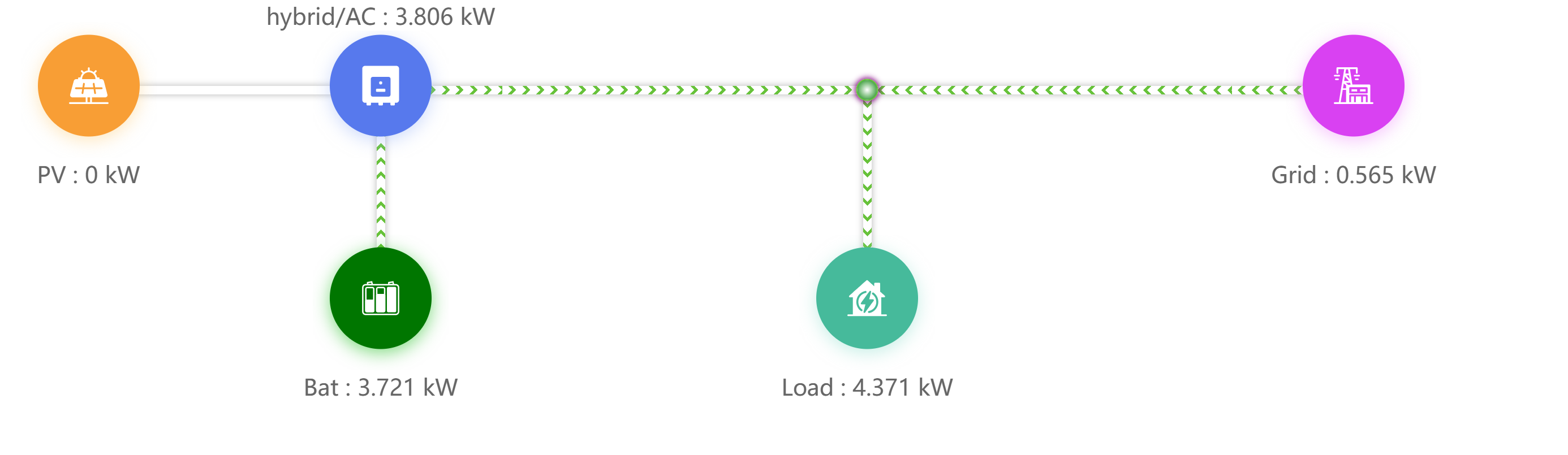

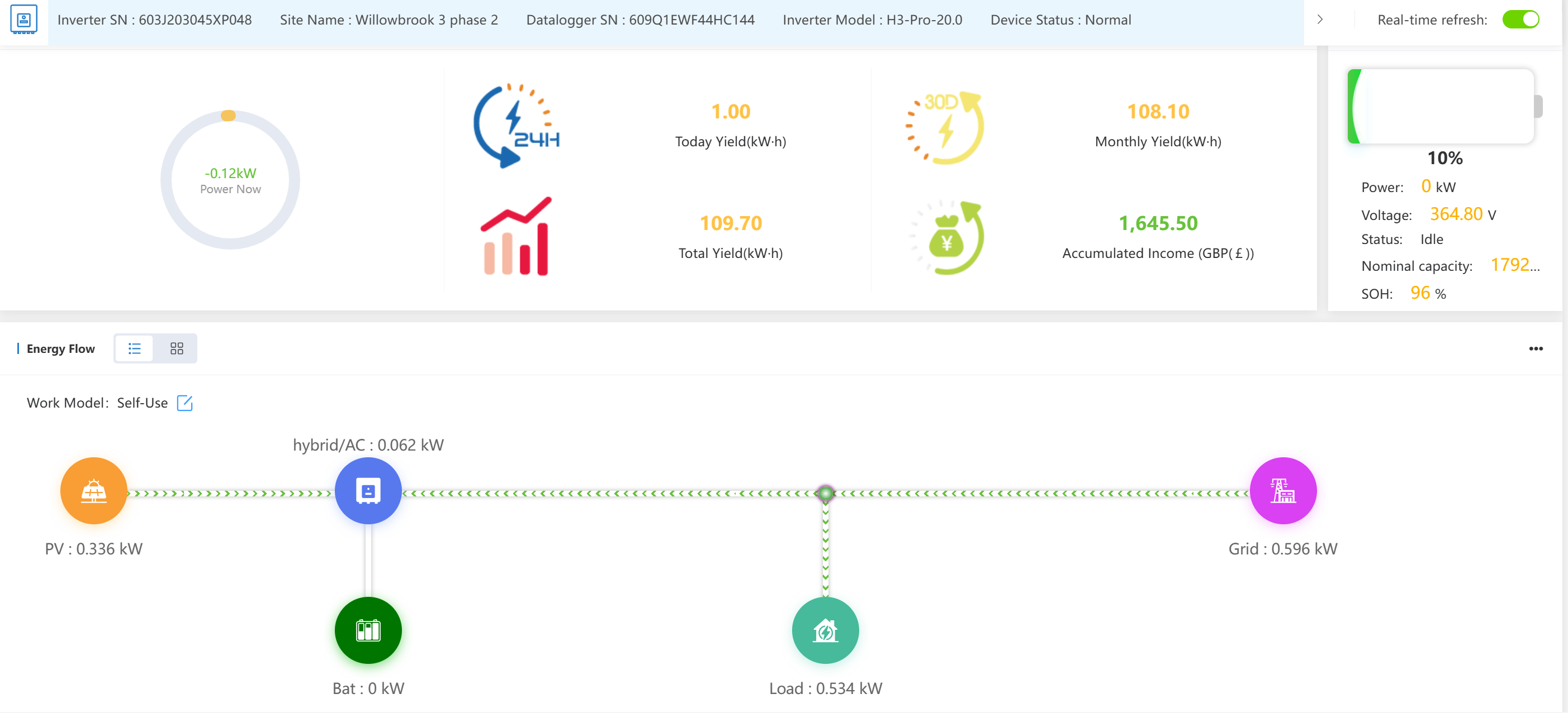

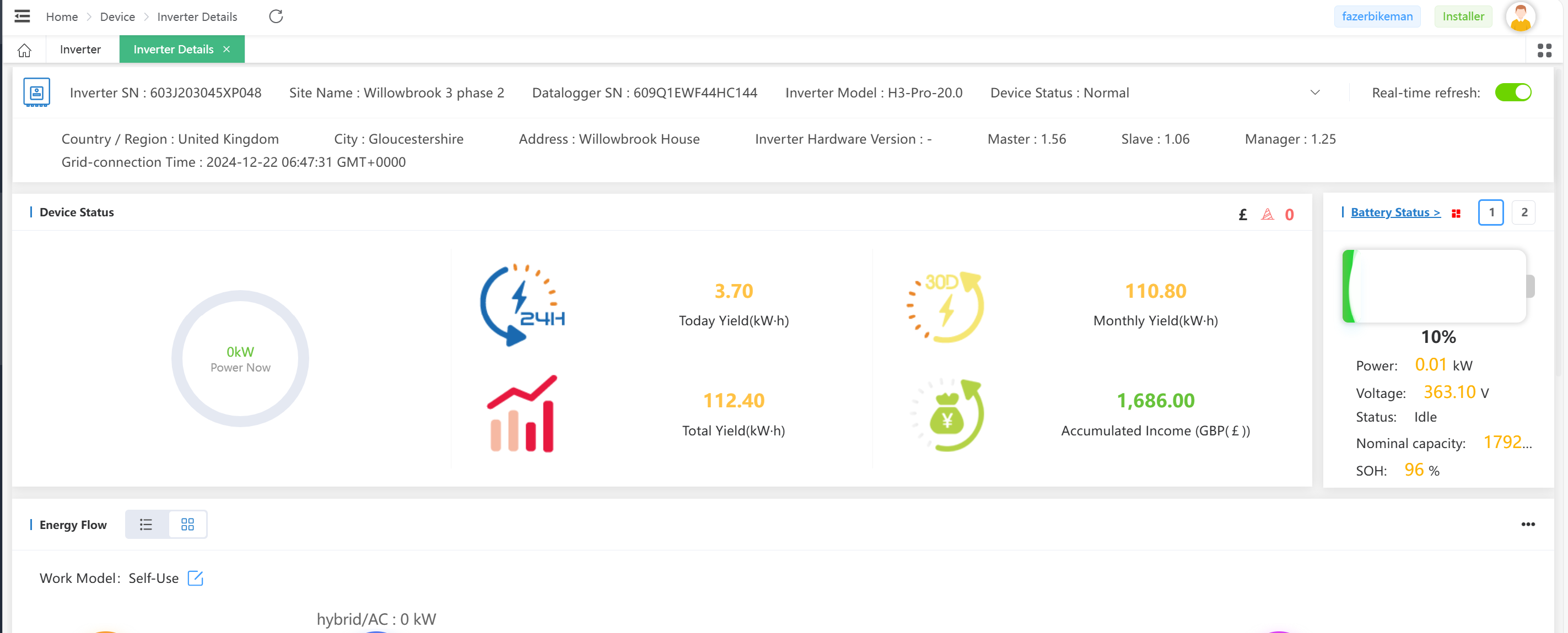

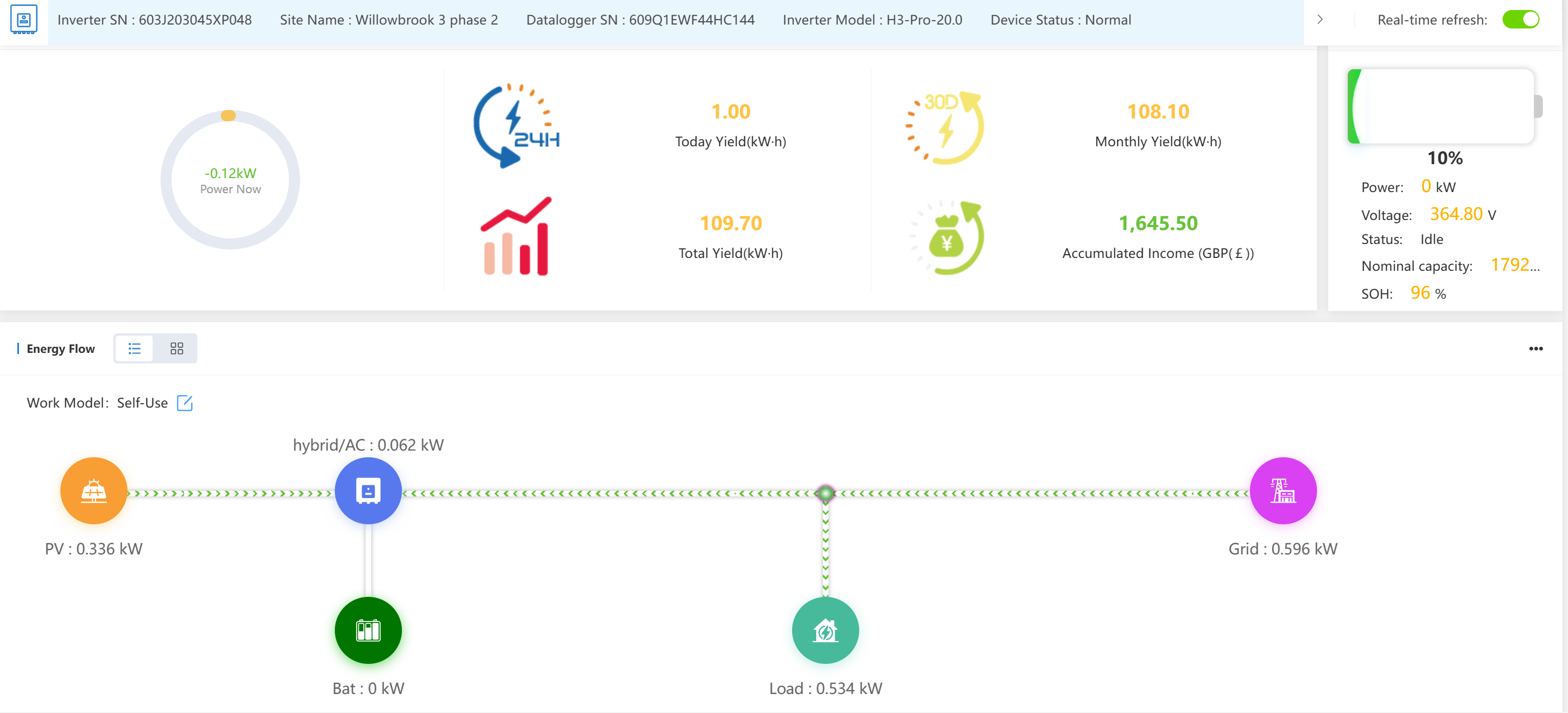

I am still a little concerned about the Gid value. currently there are no electrical items on in our house, no TV, Washing machine or Immersion etc, yet we seem to be pulling 1.29KW, Batteries are at 10% Min SOC, any idea?

If the batteries are at minsoc they will be cycling to maintain their 10% charge as they are slowly draining to power the inverter so they will be on for 10-15 minutes hour, off for an hour so and will repeat that until they get well above minsoc and with 2 batteries you can easily take a couple of kw's.
The thing to remember about the power flow graph is it isn't real time, it only updates the data every 5 minutes so you are mostly looking at an old snapshot - the better way to look at usage is on the website and see how the trend is changing across the day - it also shows when the batteries are charging (or maintenance charging) which might help to explain the grid usage - it's always better for the batteries to be charged above minsoc or you'll see the charger coming on occasionally and with 2 batteries even more often (you also get the affect when the batteries get very cold but it's mild at the moment so won't be that).
I'm not saying for sure that's right but it does appear to be working correctly so perhaps the ideal time to measure your loads with either the clamp meter or even better if your electricity meter can show the cumulative phase power being used that will be the most accurate answer you will get.
On the Pt setting, that is referring to the voltage (and not the current ratio which is the 40) - the voltages are read via the L1/L2/L3 which are connected directly to the meter and so the ratio is 1.

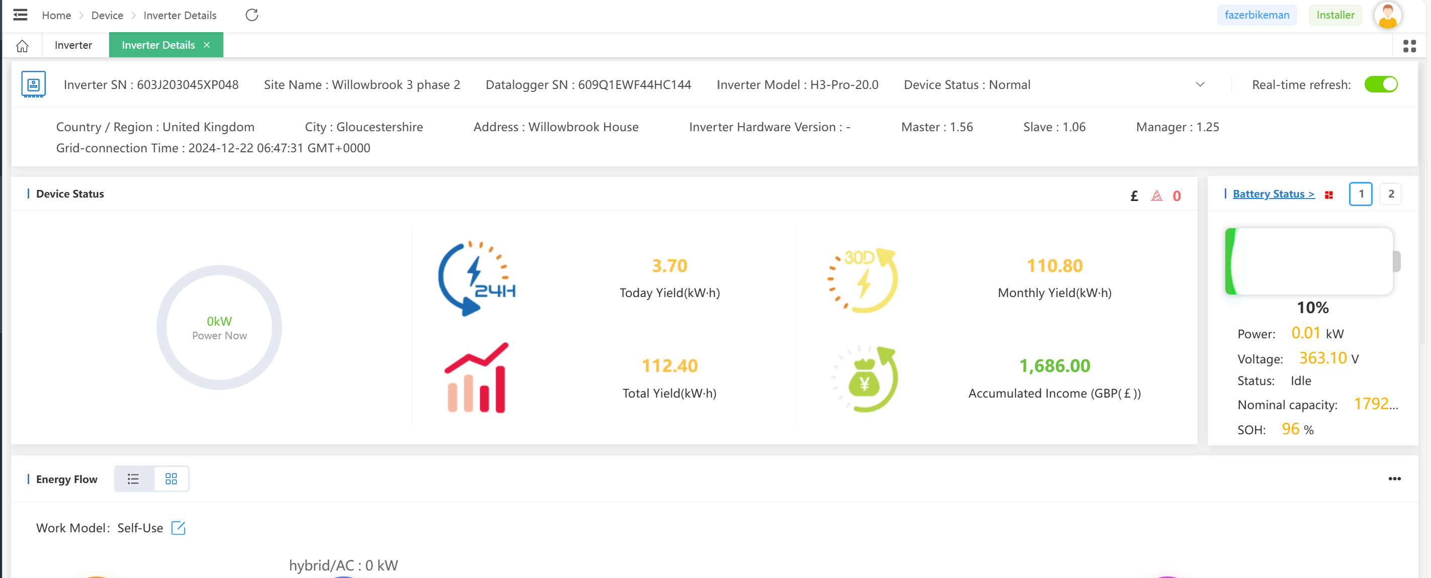

The one thing I hadn't asked before but now it's settling down I will, is, have you updated the firmware to the latest?. The H3 Pro is a very new inverter and there have been a number of releases to correct bugs and issues, so can you check your firmware is the latest.
At the top of the energy flow page where it shows the serial number and site name there is an arrow on the right hand side and when clicked it will list the Master, Slave and Manager versions - latest versions available are Master 1.56, Slave 1.06, Manager 1.25

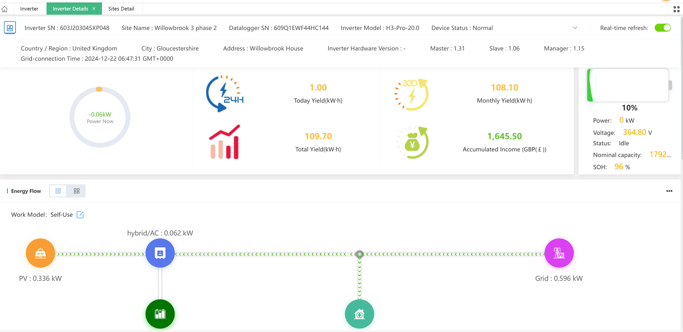

See the image below of the firmware.

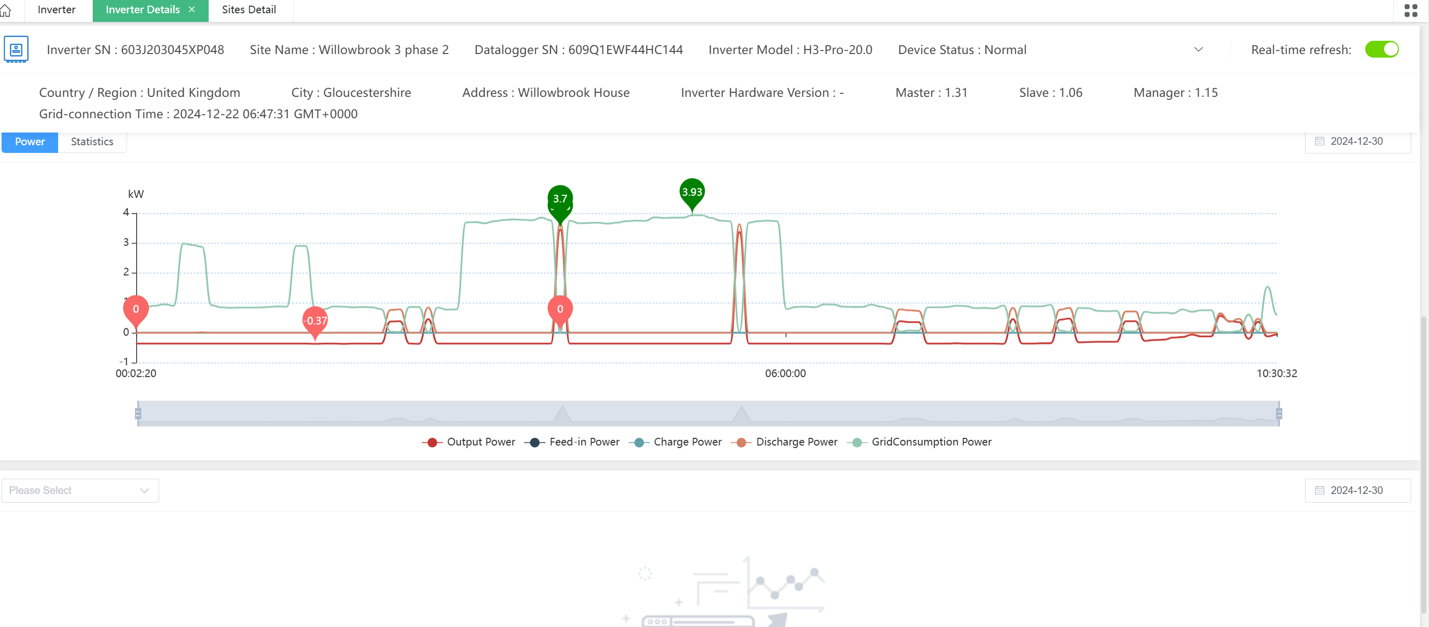

Master 1.31 Slave 1.06, Manager 1.15
I did think maybe the the firmware might need updating but i looking online and could not see how to update it.

ok great, be nice to get some decent charge in the batteries, I can see from your graphs they were taking .8 kw charge for quite a while in the early hours to maintain their minsoc's and keep the inverter operational - thursday's solar forecast is currently looking a bit better but there's not a huge amount about at this time of year.

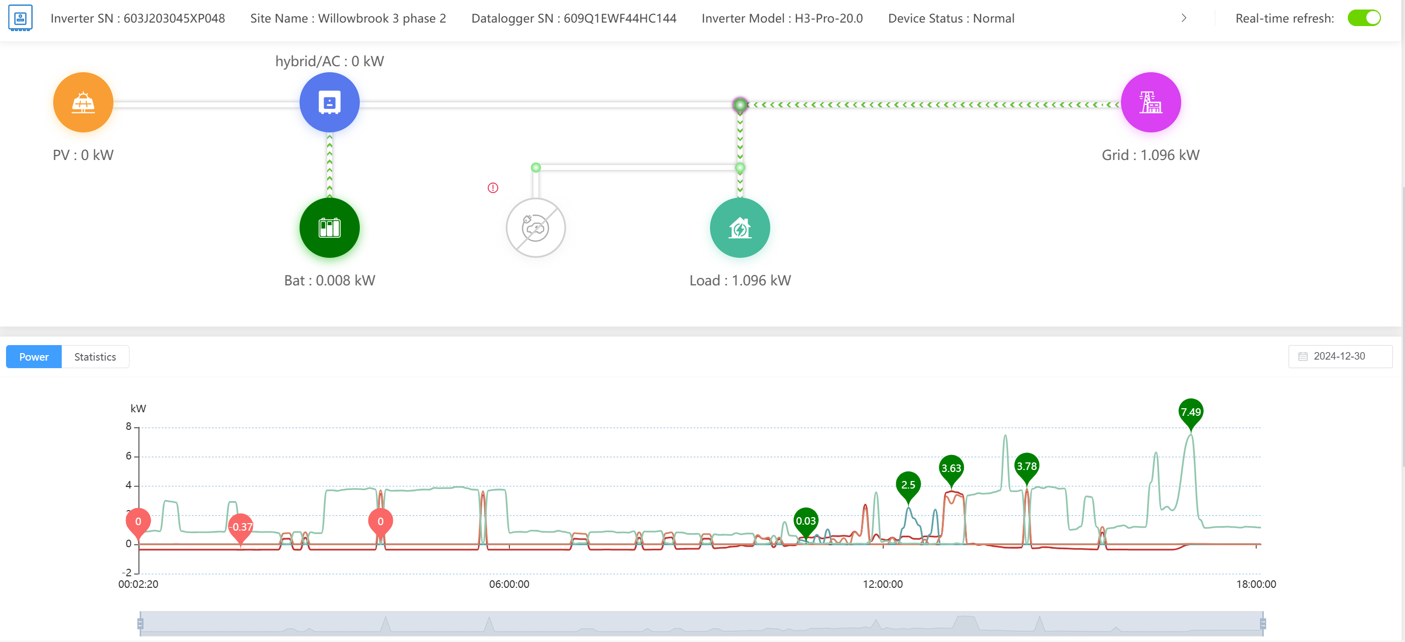

Thanks so much, it is now all updated.
lets hope for some sun later this week.

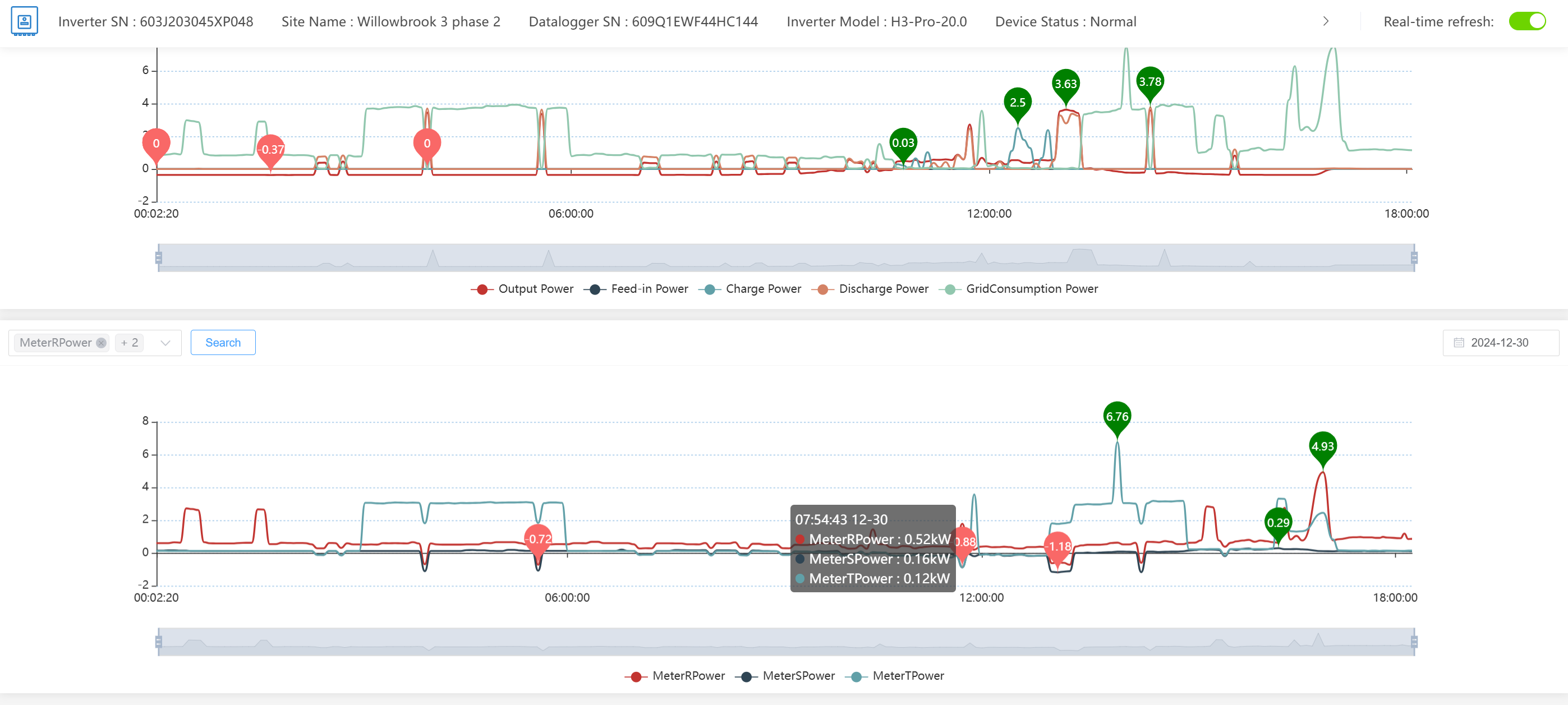

FYI of the 52 panels we have, only 7 on one mppt and 6 on another are currently connected. the other 39 are due to be connected early January. today for a short time we pulled in circa 3kw.
before we had 2 x H1-6kw with 42 panels and all worked great. the 2 invertors ran 2 of the phases, but now all 3 phases are on the new 3 phase H3.
a few screens shots for you to see the latest info.
