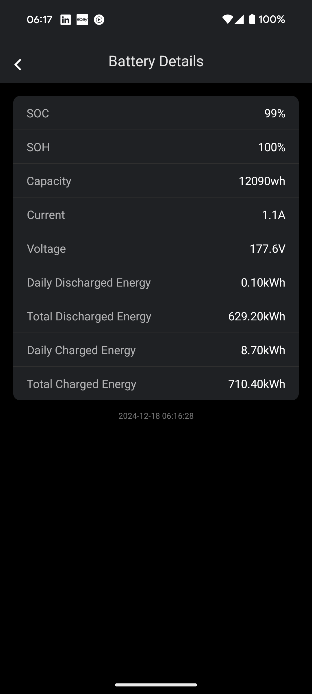

Hi. I've recently had another fox Ecs4100 battery added to my stack and it's not charging to the full capacity. I did notice when the installer added them they original batteries were at 75% soc. The daily charge energy is only saying 8.7kwh which varies a little but it should be way closer to the 12090 which 3 batteries take. I have taken the batteries down to 10% and then all the way up at night to try and cycle the batteries but it's been 14 days now with no luck.

Fox specify that when new batteries are introduced to the pack that the pack should be at 50% SoC as the new pack will be very similar.
If your pack was at 75% then it will be well out of balance and you will loose 25% of 2 batteries until the balance recovers and that will take some time (many weeks) but there are things you can do to help, charge cycling from 100% to 10% and back to 100% is the only way to speed up this process. Getting to 100% and back to 10% is an important part of this as that is where they do most balancing.
The batteries do a ‘top balance’ when they pass the pack SoC of 95% - the slower they charge these last few % the easier it is to balance - so rather than force charging, if you raise the minSoC on grid to 100% (called Battery Reserve in the V2 app) it will slowly charge from grid and allow a longer balance period (make sure you change it back to 10% afterwards).
Likewise allowing the battery to go to 10% and leaving it there for several hours will also help with the balance.
It’s quite a significant difference to start with and it takes time to recover, but if you do as many charge cycles as possible using the slower charge method it will get there faster.
