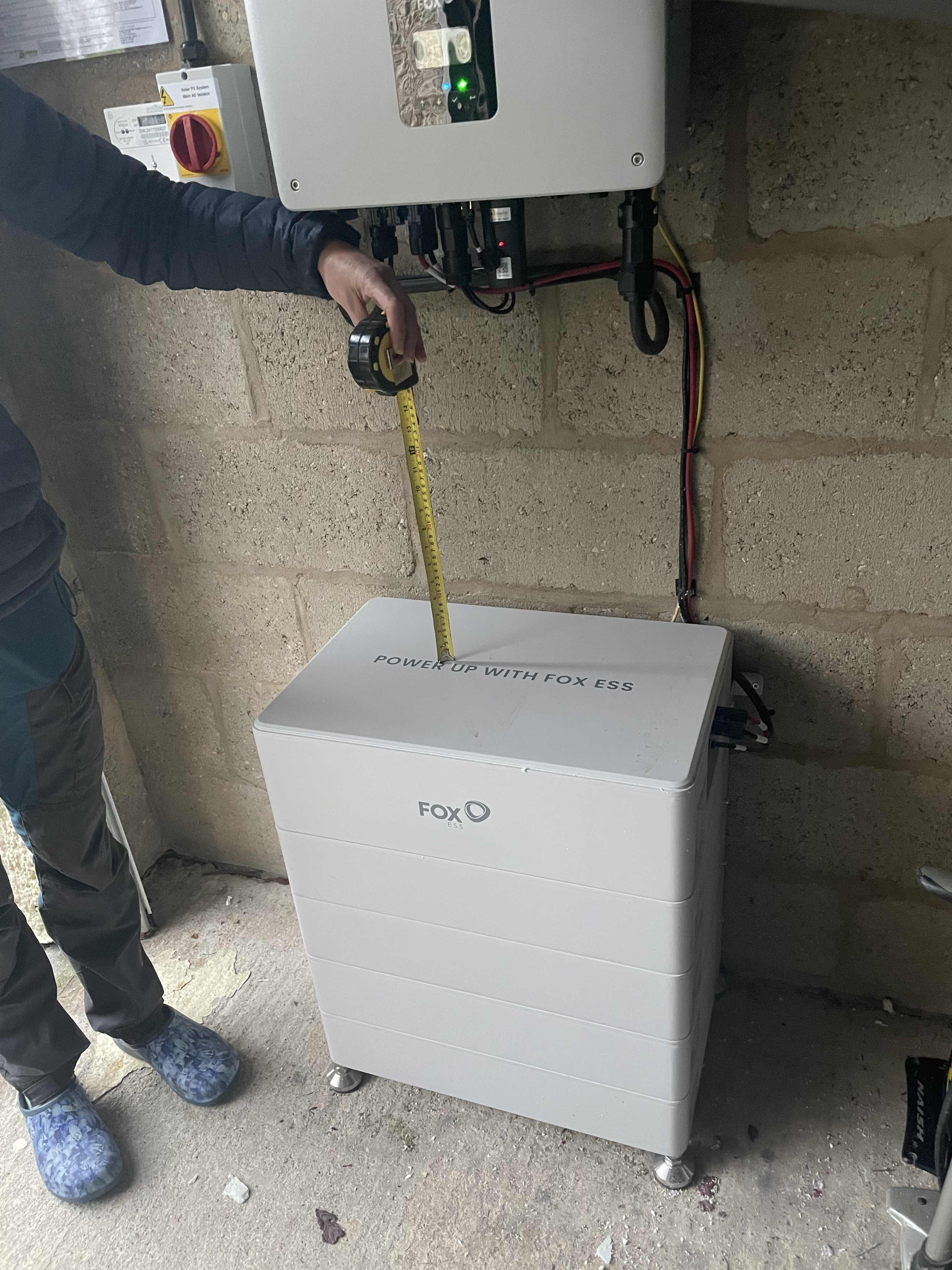

Ive added a couple more images

Ok, that makes sense - you had 1+4 which is 5*2.88kW=14.4kWh and at 10% minSoc you’d need to charge with 12.9kW which is what your graph suggests (I was close at 12.5kWh)
Now you have 2 more batteries once they have balanced you’ll have 20.16kW which with a 10% minSoc gives you 18.15kWh

With your extra batteries you won’t be able to fully charge them from flat in the 2am-5am slot, it’ll probably take that extra hour you are giving it to fully charge - but keep an eye on that, if you’re not hitting 100% by 6am you might need to extend it slightly, these batteries really need to get to 100% occasionally for them to balance properly.
