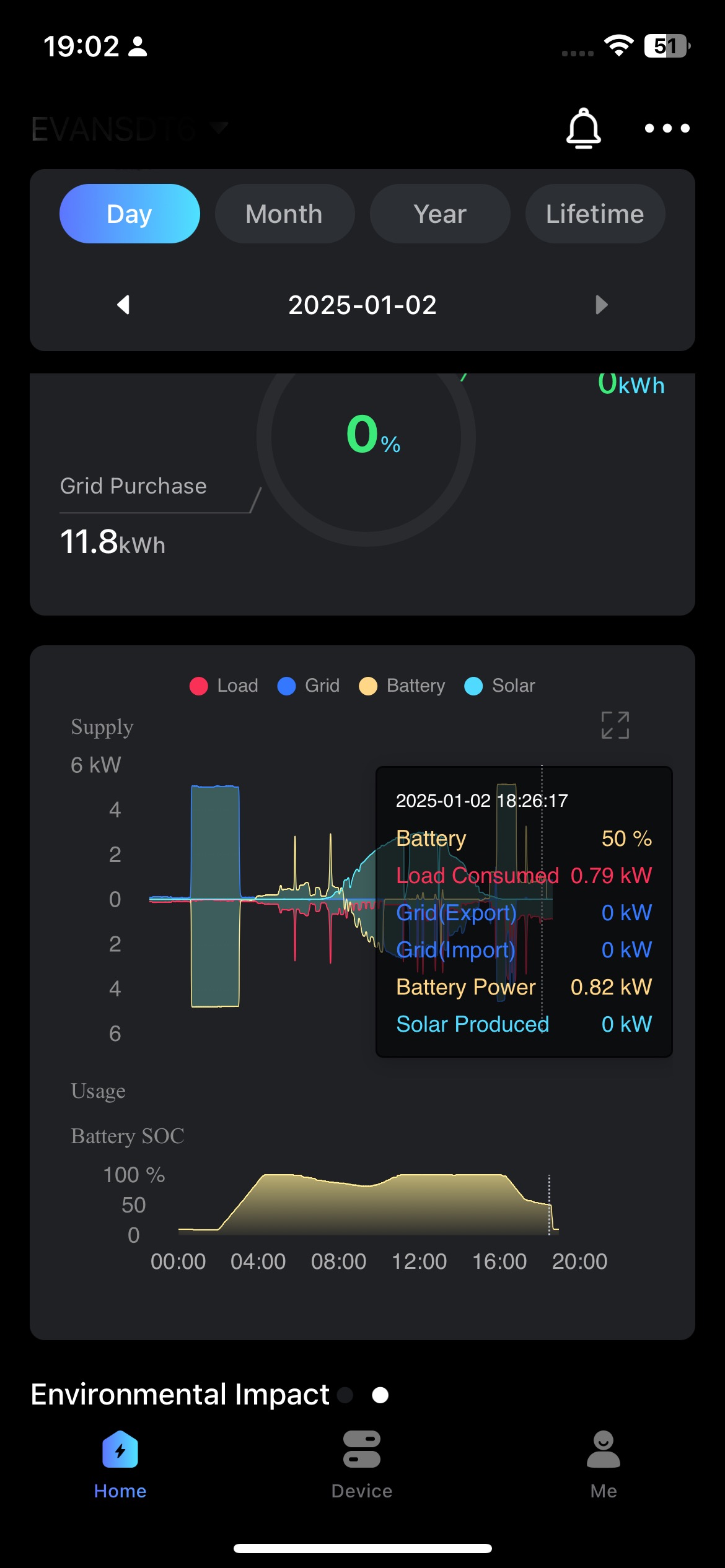

I decided to have an additional slave installed, and all appeared well until the evening of the installation day, when the SOC dropped from 50% to 10% over about 15 minutes. I do have a forced grid export setting that cuts off at 60% SOC but this had already functioned correctly earlier in the afternoon. I had no heavy load items running, just the TV and some lights, certainly nothing that would chug through nearly 6kwh in 15 minutes! I attach two screenshots from the Fox app that show the occurrence.

Concerning to hear your installer didn't follow the install manual by matching the soc to 50% prior to install. The 50% SoC during install of the additional slave while it has not hurt anything, it is important to do so that it aids balancing of the cells. The reason you're seeing large jumps in SoC over a short periods of use is down to him installing a half full battery into a fully charged system.
Balancing will now take somewhere between 2 to 3 weeks of daily cycling before the battery starts to behave normally again but it's really nothing to worry about or anything you can do.
