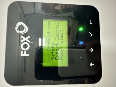

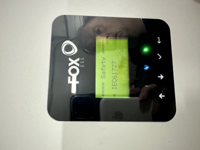

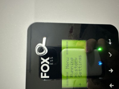

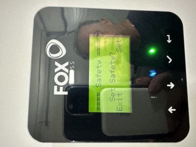

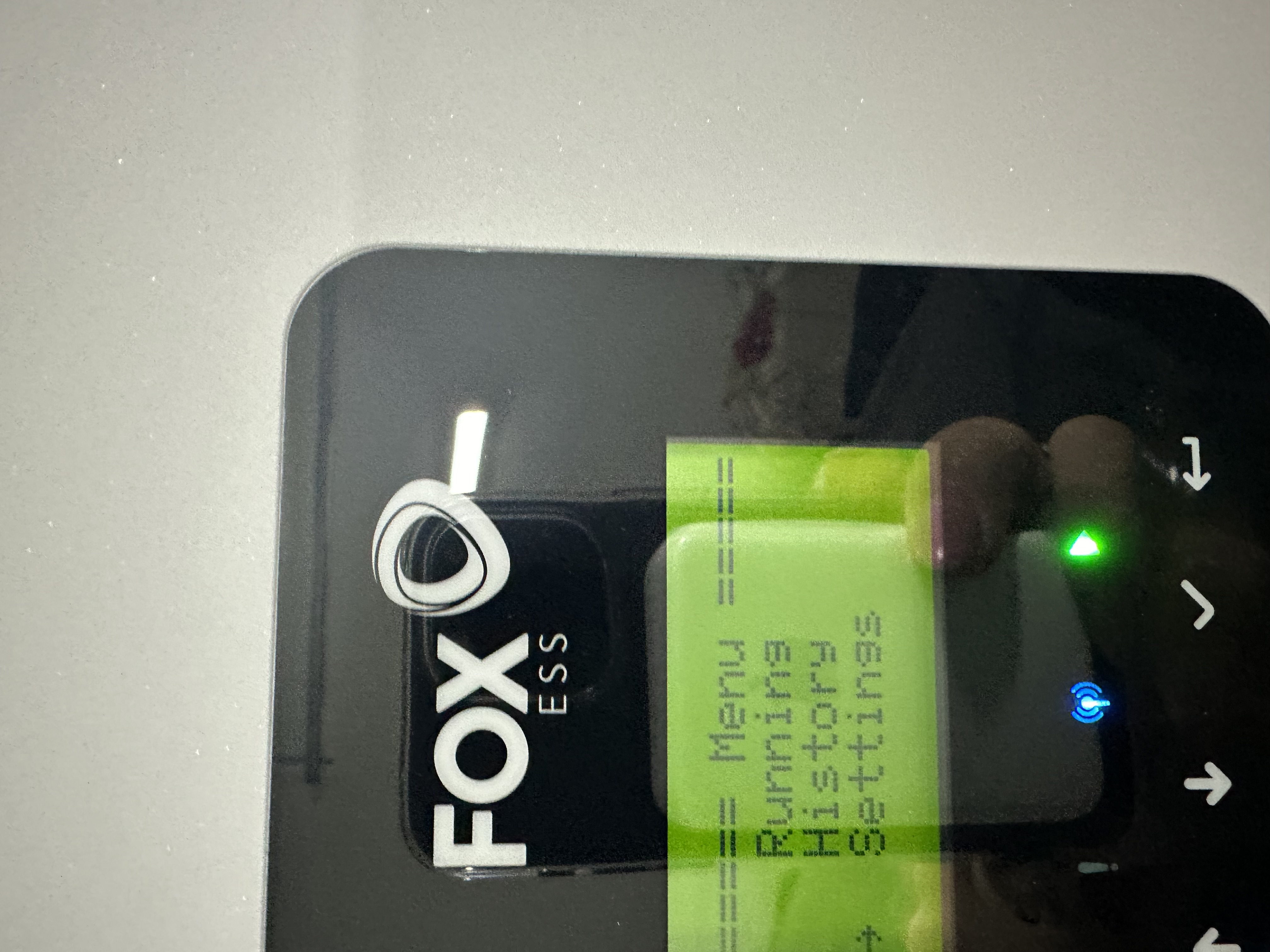

Hello, we have the same problem on H3-8-E but when we go into the menu it is totally different. Somebody an idea what to do?
Thank you.

On the latest H3, I believe it is found under the Safety menu.DianeAliseMonique wrote: Sat Dec 02, 2023 1:10 pm Hello, we have the same problem on H3-8-E but when we go into the menu it is totally different. Somebody an idea what to do?
Thank you.
Select Settings, the pin is 0[enter], 0[enter], 0[enter], 0[enter]
Scroll down to On-Grid and press enter
Scroll down to the bottom of this menu and select the item 'Safety'
Is there a menu item there called Safety Voltage Params ?
Alternatively call your installer or Foxess support, it can be set remotely.

- Posts: 1853
thanks for the photos, very helpful - it looks like the main safety voltage parameters are not available on your H3 from the inverter panel.DianeAliseMonique wrote: Sun Dec 03, 2023 10:25 am Good morning Dave, thank you for the quick response!
When I follow the steps and go to Safety I don't find what you are saying.
I put some pictures off the menu.
I am gonna call the installer.
Good idea, your installer will be able to change the settings for you on-line.
