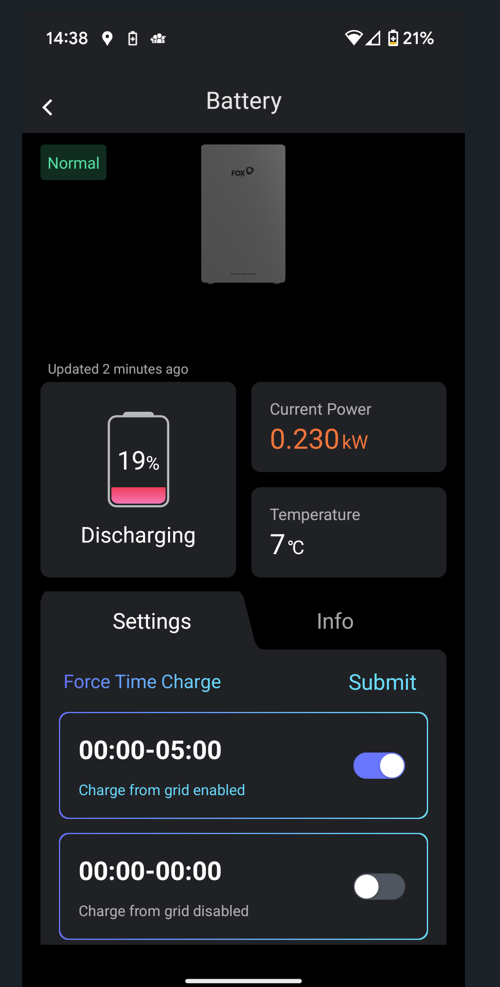

It's great, but I am really struggling to get the battery to charge from the grid overnight. When the installers were here, they said I just needed to set the battery to charge from grid during certain times, in the app. I've done that, but so far it has failed to charge (I get cheap energy between midnight and 5am each day, so want to top up my battery each day during these times).
I've tried to do this via the App and also on the online web portal but without success. I've attached some screenshots as below to show how i've set it up and was hoping the forum could tell me if I've done this correctly or perhaps missed some settings?

Your settings look correct but the one thing I can see is that your battery temperature is 7C which is low, charging will be throttled and erratic at this temperature and the batteries will stop charging altogether as they approach 0C.
