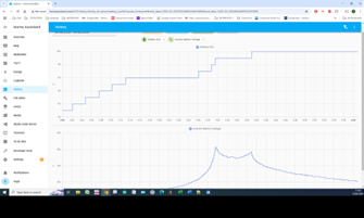

This is my EQ4800 battery stack charging to 100% SoC.
It shows the 15 minutes hold at 96% charge. The voltage curve is unexpected but clearly is being managed.

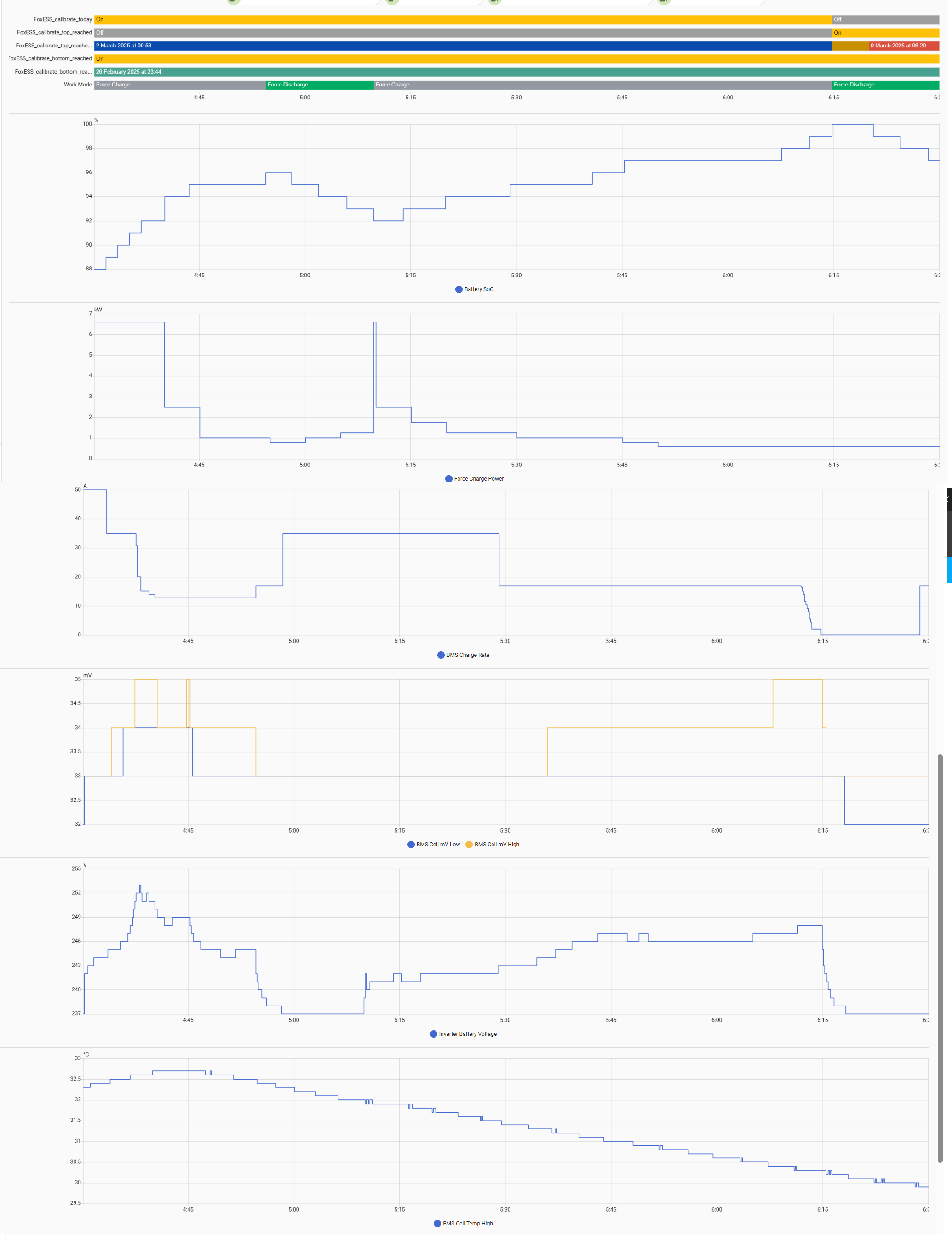

Here's the result of my calibration automation - I got brave and set it to 100%, and it reached it OK. This is with top calibration interval at 7 days, bottom calibration interval 28 days, charge current 2.7A via number.force_charge_power (600W on an EC4300-H4) >= 97% SoC. I guess the previous time when it got stuck at 99% was because the battery was cold (probably around 6-10c) & the power from the PV in January wasn't quite enough to push it over the edge into 100%.
I wasn't touching bms_charge_rate but it is interesting to see it automatically react to both the SoC and the battery cell temperature.
I changed my normal operating range from 20%-80% to 20%-87%. As noted previously this is all above&beyond the existing BMS protections, because I'm using the battery quite heavily.
