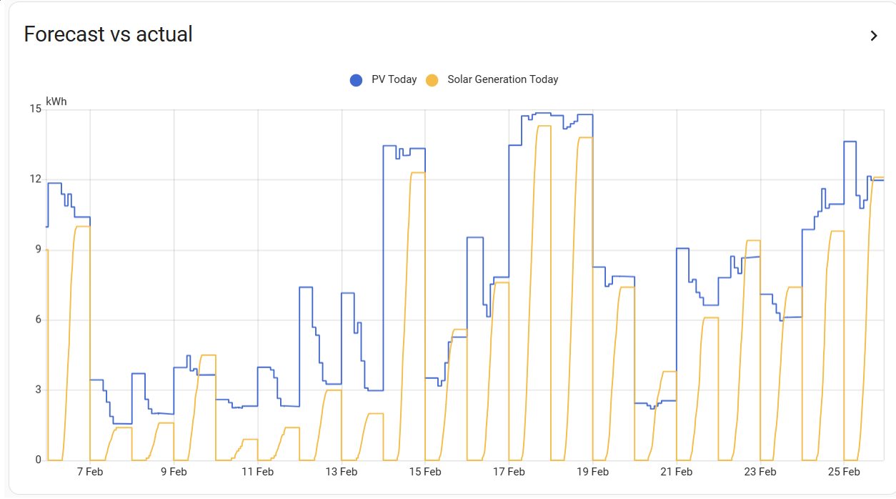

So here you can see the forecast being refined as the day progresses (blue), versus the actual generation (yellow). You can request the forecast up to 10 times per day. So perhaps once every 3 hours overnight, and once every couple of hours during the day.

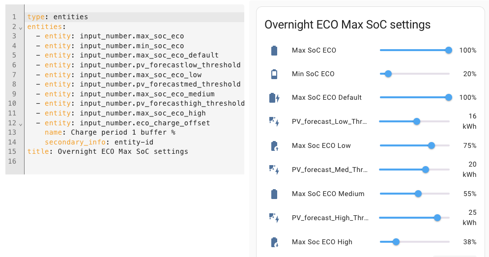

Had exactly same thoughts as yourself Hugh, I created a few helpers to play with slider input numbers for boundaries and set desired Max SoC % levels for the ECO 2am-5am period to avoid charging overnight just to start exporting the next morning
a snippet of my automation:
Code: Select all
alias: "Energy: set Max SoC ECO based on tomorrow's PV forecast"
description: Sets the Max SoC ECO according to the forecast for tomorrow
