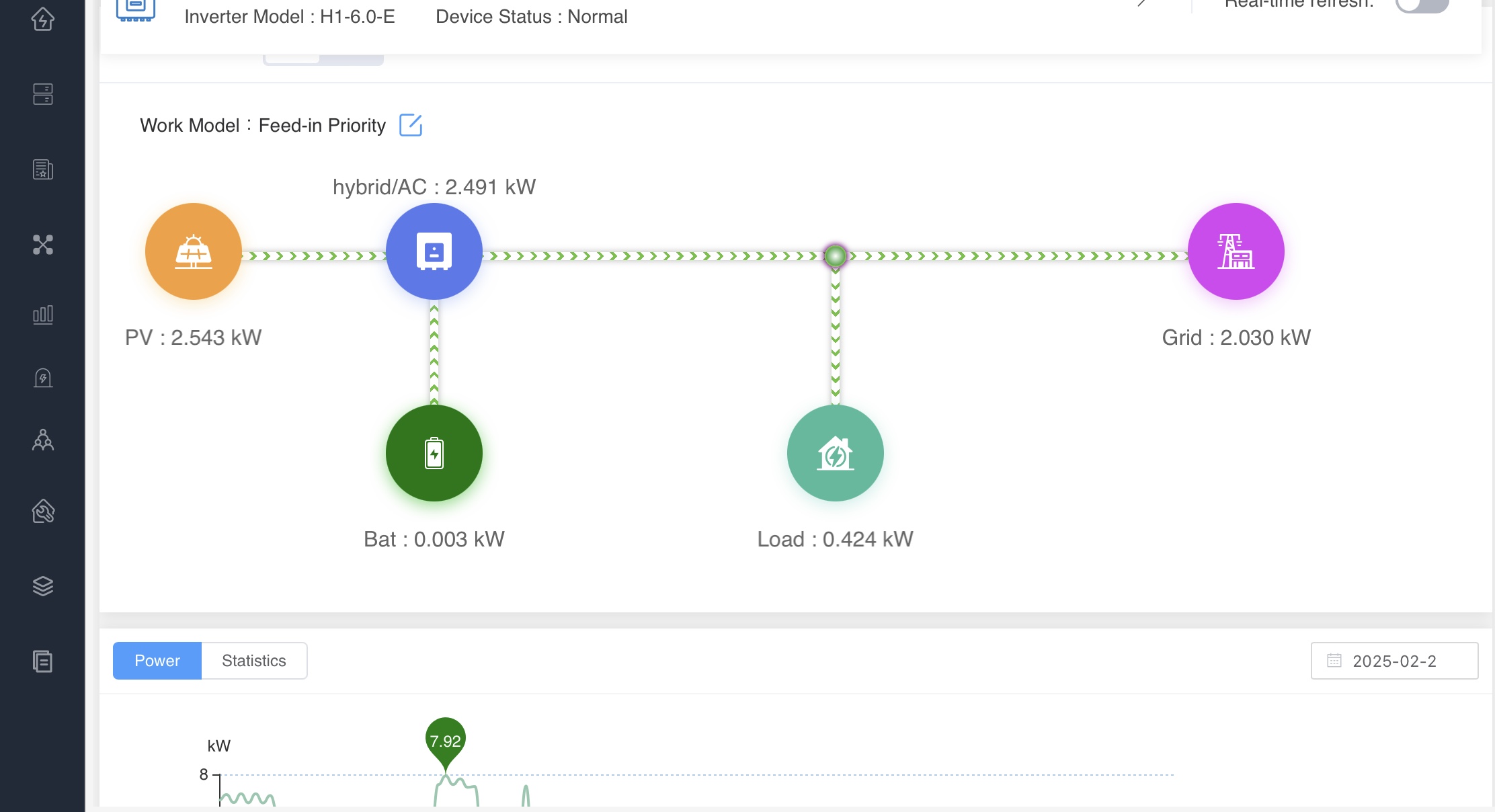

Good afternoon.
It's been a sunny day (but with a grid power outage for three hours this morning), it has been back on for about two hours now. I was unable to tell if the solar panels charged the battery (as perhaps they should have done) during the outage.
Here is a diagram from the website which I think is demonstrating the problem
https://photos.app.goo.gl/NWiCK3SEn4Typ7UH8
Other photo of app home page
https://photos.app.goo.gl/h1AguGjqvNbUTw336
Many thanks
Mandy
Re: New installation and confusion
The CT clamp is definetly not working correctly (if you really don't have a 7kW load in the house at the time you took it), it would be either located in the wrong place or is facing the wrong way - it's difficult to be sure, usually if you see PV causing the battery to discharge and increasing the load it is the wrong way round.
The best option is to get your installer back and have them check and correct the system - you could take photos of your meter cupboard and post them here and we can guide you but you would need to be able to identify the cables coming in and out and be willing to move / change the CT clamps position.

Thanks, just going back to your opening comment - you said it wasn't working well because the clamps were in the wrong place - do you remember where they were attached ?
The CT clamps are connected to the load cable and they should be connected to the grid (incoming) cable - see my attached (click on it to enlarge).
The only thing i've not been able to work out correctly is whether the CT clamp is orientated correctly, the arrow normally points towards the grid (whereas yours is pointing towards the load) - but if the wires have been crossed at the meter it would be correct. Without being there to check cable orientation or check what the meter itself is reporting i'm not entirely sure.
But the one thing that I am sure about is the location is wrong - can you please move each clamp (carefully) from where it is to the cable where I have shown on this image - for now keep the orientation the same i.e. arrow pointing towards the load. Once it has moved to the correct place you will be able to tell very quickly, should the house load be reporting as negative it is the wrong way round - in which case turn each one through 180 degrees so the arrow points in the opposite direction.
The CT clamps have a small clip on the side that when released allows its hinge to open and be removed - move it to the new location and clip it shut again.
Thank you. We have moved the clips and as you said, saw an immediate difference. We will go out for an hour and look again when back (so as not to obsess:))
I took a pre screenshot and post screenshot and will load these to the album .
Thank you is too little to say...
