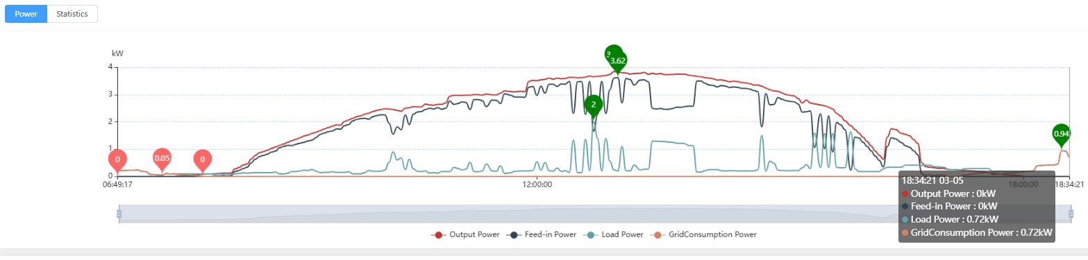

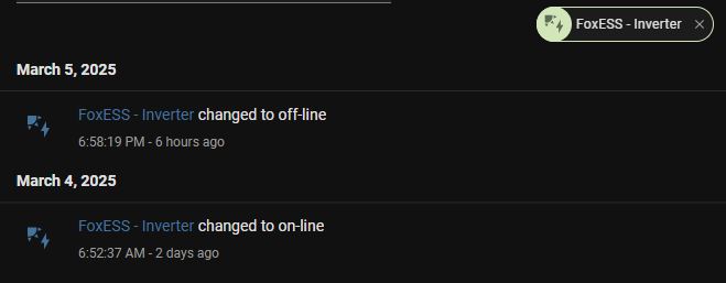

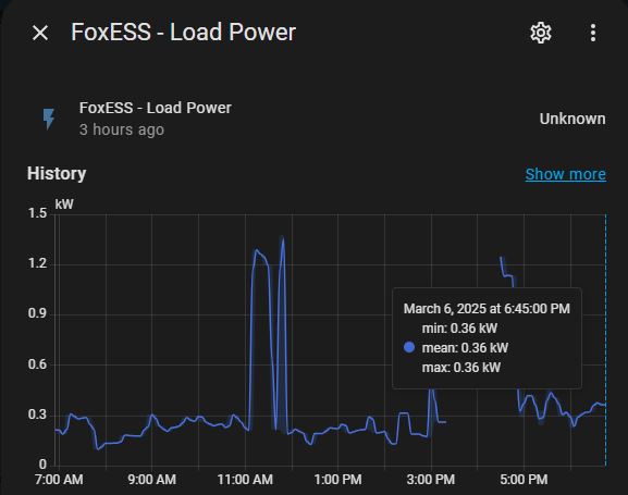

Re: T10-G3 Inverter Status during non-solar hours

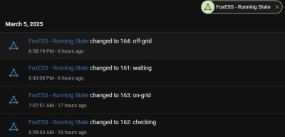

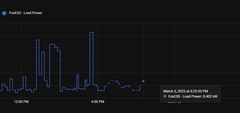

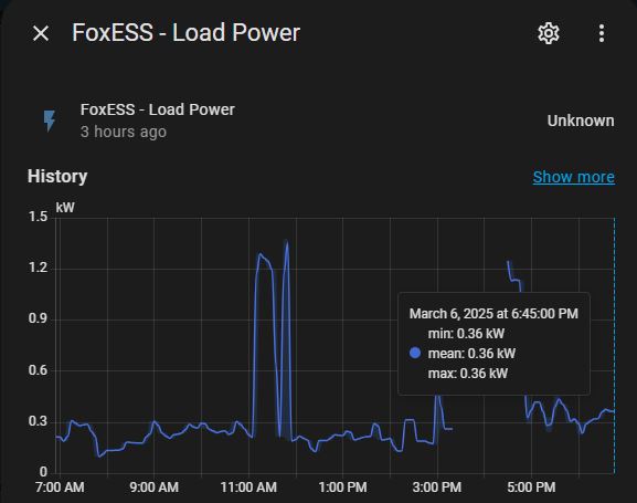

Hey Dave,
I have some observation from today.

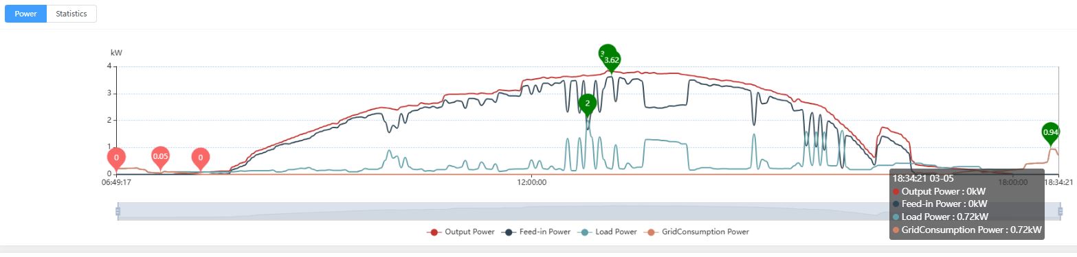

I have added the screenshots below, however in summary, the last pull was at 6:53PM when StateTest was 1 and load values were updated as well (from logs), however, HA did not recognize that as an update and went to "Unknown " at 6.23PM.
Snapshot from FoxCloud:
Logs:
[2025-03-05 18:53:14.676 DEBUG (MainThread) [custom_components.foxess.sensor] Main Poll, interval: 603T*******, 40
[2025-03-05 18:53:14.676 DEBUG (MainThread) [custom_components.foxess.sensor] Statetest 1
[2025-03-05 18:53:14.677 DEBUG (MainThread) [custom_components.foxess.sensor] getRaw OA request: {"sn":"603T*******" }
[2025-03-05 18:53:16.000 DEBUG (MainThread) [custom_components.foxess.sensor] OA Variables time: 2025-03-05 18:34:21 PKT+0500
[2025-03-05 18:53:16.000 DEBUG (MainThread) [custom_components.foxess.sensor] OA Variables tsrcv stamp: 1741181661.0, offset: 18000
[2025-03-05 18:53:16.000 DEBUG (MainThread) [custom_components.foxess.sensor] OA Variables time: 2025-03-05 18:34:21 PKT+0500 timestamp rcv:1741181661.0
[2025-03-05 18:53:16.000 DEBUG (MainThread) [custom_components.foxess.sensor] OA Variables time: 2025-03-05 18:34:21 PKT+0500 vs 2025-03-05 18:53:16.000959 timestamps r:1741181661.0 now:1741182796, age: 1135
[2025-03-05 18:53:16.001 DEBUG (MainThread) [custom_components.foxess.sensor] OA Variables invalid age: 2025-03-05 18:34:21 PKT+0500 vs 2025-03-05 18:53:16.000959 timestamps r:1741181661.0 now:1741182796, age: 1135
[2025-03-05 18:53:16.001 DEBUG (MainThread) [custom_components.foxess.sensor] OA Variables Good Response: [{'unit': 'kW', 'name': 'Load Power', 'variable': 'loadsPower', 'value': 0.72},
[2025-03-05 18:53:16.005 DEBUG (MainThread) [custom_components.foxess.sensor] Var: loadsPower, SN: 603T******* set to 0.72
[2025-03-05 18:53:16.010 DEBUG (MainThread) [custom_components.foxess.sensor] Var: runningState, SN: 603T******* set to 161
[2025-03-05 18:53:16.010 DEBUG (MainThread) [custom_components.foxess.sensor] TestState: 161, hasBat: False online: True
[2025-03-05 18:53:16.010 DEBUG (MainThread) [custom_components.foxess.sensor] Waiting so set off-line state, TestState: 161, hasBat: False online: False
[2025-03-05 18:58:17.471 DEBUG (MainThread) [custom_components.foxess.sensor] OA Device Detail System has No Battery: False
[2025-03-05 18:58:19.477 DEBUG (MainThread) [custom_components.foxess.sensor] Statetest 3

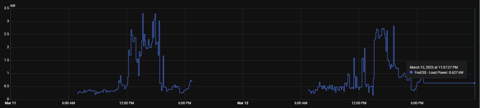

Load Power from HA
Inverter Status from HA

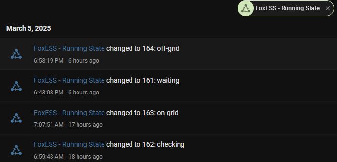

Running State from HA
I’ve just had a quick look at the logs for today, there have been some issues with the Foxcloud (quite a few posts about this on the forum) and it looks like this had been interfering with getting data - there were are number of errors on and off, and quite a few at the time your inverter was going off-line.
You can see the data interruptions in your loadpower trace as the cloud went on and off-line.
From your logs this is a sample of some of the (many) errors the Openapi was returning which is why the samples failed.
2025-03-05 13:22:21.640 DEBUG (MainThread) [custom_components.foxess.sensor] OA Device Variables Bad Response: {'errno': 0, 'msg': 'Unrecognized msg:0', 'result':
2025-03-05 13:27:29.232 ERROR (MainThread) [custom_components.foxess.sensor] OA Device Detail Bad Response: {'errno': 0, 'msg': 'Unrecognized msg:0', 'result': {'deviceType': 'T10-G3', 'masterVersion': '1.49', 'afciVersion': '0.00', 'hasPV': True, 'deviceSN': '603Txxxxxx', 'slaveVersion': '1.02', 'hasBattery': False, 'function':
You would be +5hrs on this so the time this was recorded was 18:22:21 and 18:27:29
I think we’ll have to write off today’s data as being a Fox own goal and wait for normal service to resume :(

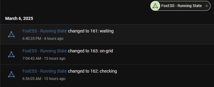

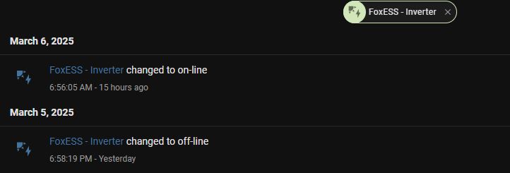

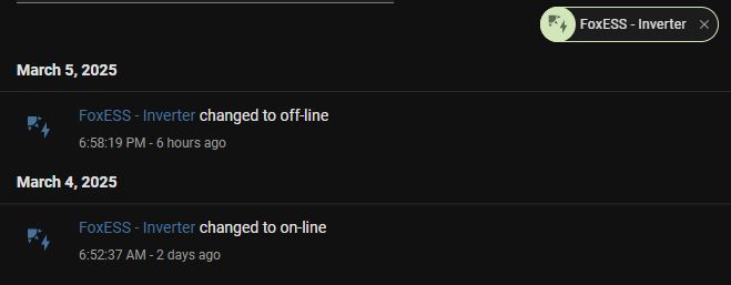

Hi Dave,
Yes you are absolutely right. It was due to Fox Cloud.
Today the inverter decided to stay online and another special case occurred but luckily you have already placed guard rails to handle such situations. :D
So as the inverter state is still online, the StateTest is still showing "1" even at 10PM in the night, however, we also have a check on the Running state, and as the inverter moved to Waiting, the Load Power stopped populating data.
Even though Fox Cloud website shows last pull at 6.35PM, we agreed that it may do another sneaky pull in the background, so HA recorded last value at 6.45PM and then moved to Waiting -> Unknown. One thing to note is that the Running state changed to Waiting at 6.40PM and Load power shows last value populated at 6.45PM, but as the fetch duration is 5mins, I could expect that the value populated at 6.45PM is indeed the "last" one.
In Summary, no red flags, just posting for your awareness & acknowledgement
Screenshots & Logs below:
[2025-03-06 21:59:38.790 DEBUG (MainThread) [custom_components.foxess.sensor] OA Device Detail System has No Battery: False
[2025-03-06 21:59:40.791 DEBUG (MainThread) [custom_components.foxess.sensor] Statetest 1
[2025-03-06 21:59:40.791 DEBUG (MainThread) [custom_components.foxess.sensor] getRaw OA request: {"sn":"603T*******" }
[2025-03-06 21:59:41.558 DEBUG (MainThread) [custom_components.foxess.sensor] OA Variables time: 2025-03-06 18:35:56 PKT+0500
[2025-03-06 21:59:41.564 DEBUG (MainThread) [custom_components.foxess.sensor] OA Variables tsrcv stamp: 1741268156.0, offset: 18000
[2025-03-06 21:59:41.564 DEBUG (MainThread) [custom_components.foxess.sensor] OA Variables time: 2025-03-06 18:35:56 PKT+0500 timestamp rcv:1741268156.0
[2025-03-06 21:59:41.564 DEBUG (MainThread) [custom_components.foxess.sensor] OA Variables time: 2025-03-06 18:35:56 PKT+0500 vs 2025-03-06 21:59:41.564827 timestamps r:1741268156.0 now:1741280382, age: 12226
[2025-03-06 21:59:41.564 DEBUG (MainThread) [custom_components.foxess.sensor] OA Variables invalid age: 2025-03-06 18:35:56 PKT+0500 vs 2025-03-06 21:59:41.564827 timestamps r:1741268156.0 now:1741280382, age: 12226
[2025-03-06 21:59:41.565 DEBUG (MainThread) [custom_components.foxess.sensor] OA Variables Good Response: [{'unit': 'kW', 'name': 'Load Power', 'variable': 'loadsPower', 'value': 0.362}
Inverter Status
Running State
Load Power Values
Ok great, it’s looking good.
I just took a quick run through the logs, the last valid sample was received from the cloud at 18:35:36, the data sample was 277 seconds old so must have been sent a few minutes before and it was valid.
As the statetest was 1 (on-line) the integration took another sample 5 minutes later at 18:45:36 but the data age was now 580 seconds and as it was runningState 161 it updated just the status, didn’t update the sensors and switched off-line.
I’ll give it a few more days and then update the release to reflect the last manual change you made and that should be a wrap :)

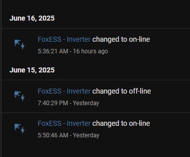

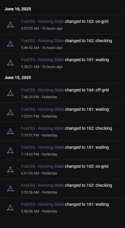

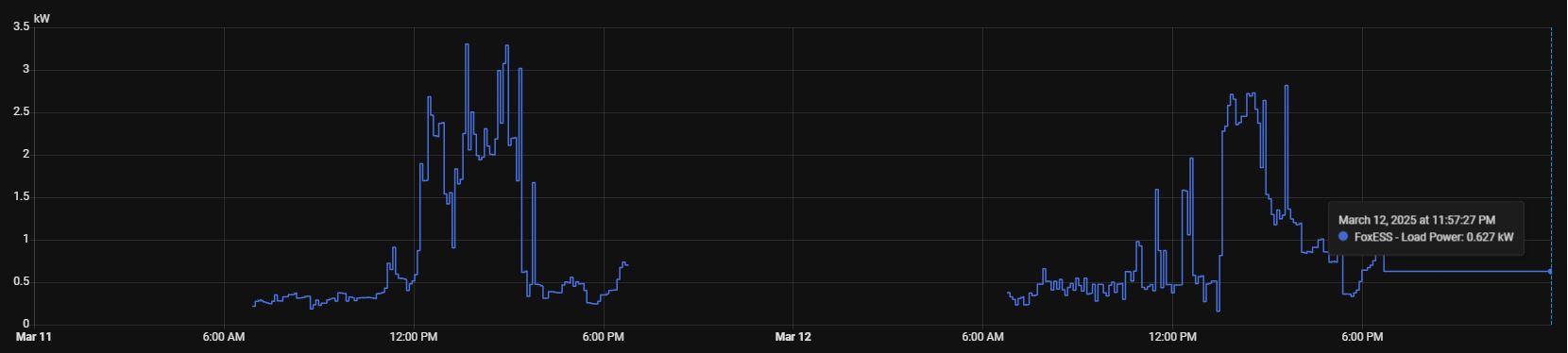

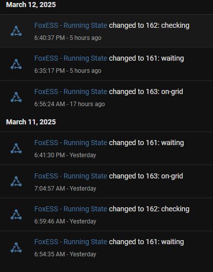

Hey Dave,
Hope you are doing well and rocking!
Noticed a bit of an odd behavior today, and I most likely think it is due to maybe FoxCloud this time.
My inverter didn't move from On-Grid to Checking or Off-line today. The Inverter status on the FoxCloud website is also showing Normal instead of Offline.
Attaching screenshots here for your review :D
I’ve still got your apikey so ran that to check and yep, the cloud is thoroughly confused not only is it returning status 1 (on-line) in the device detail, but also running state 163 (on-grid)… not much I can do about that one.. :?
I’ll monitor for the next day or two to see if it’s a one off or some new behaviour it has added.
