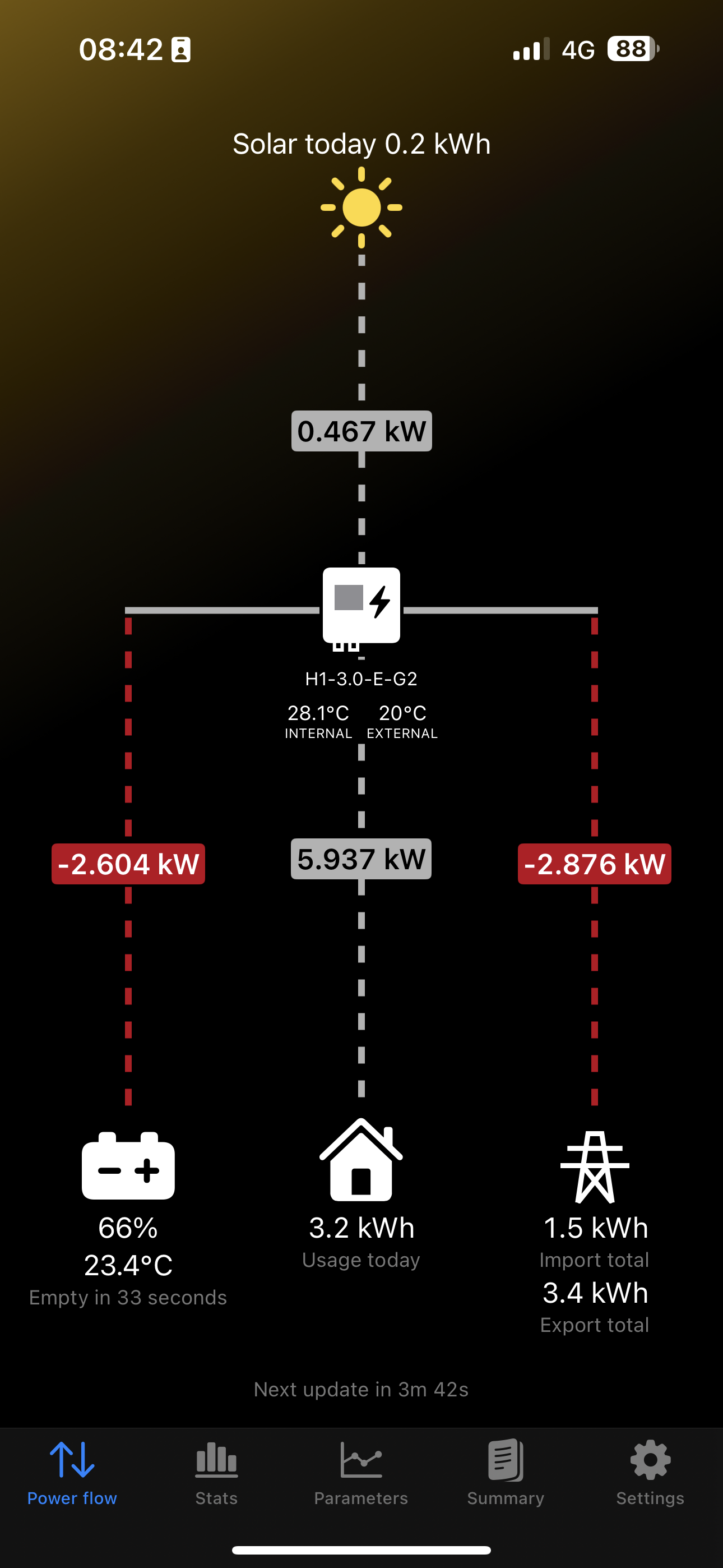

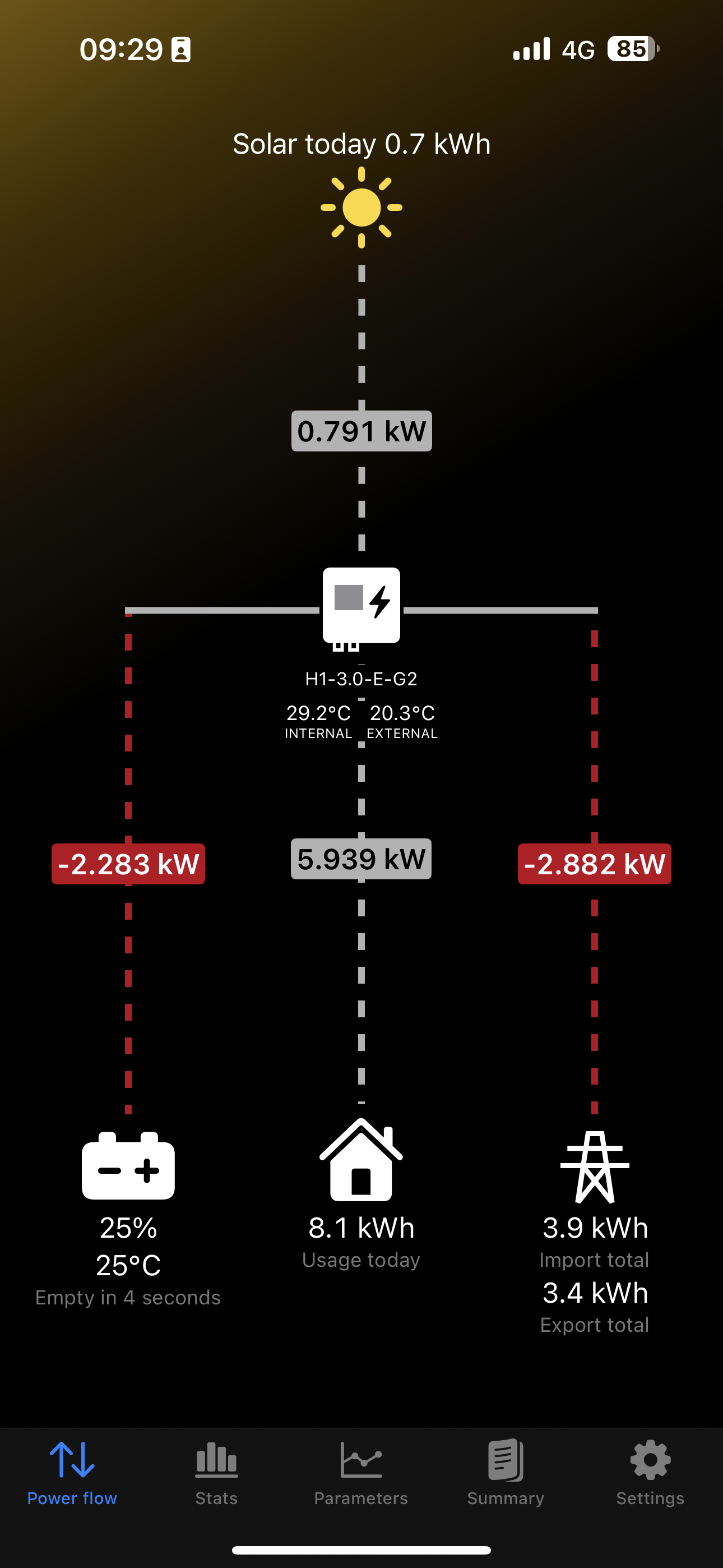

I am wondering why my battery is discharging from 100% down to 20% every day and at the same time it looks like I’m importing from the grid when I have nothing using much power on in my house.
Yesterday it seemed to drain down to 20% and then recharge from the grid which costed me more.
