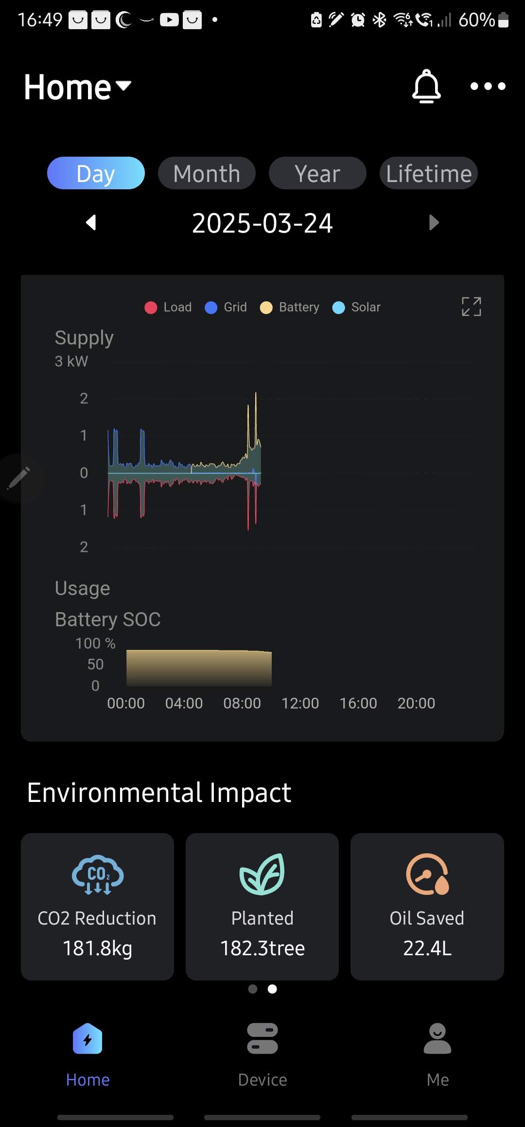

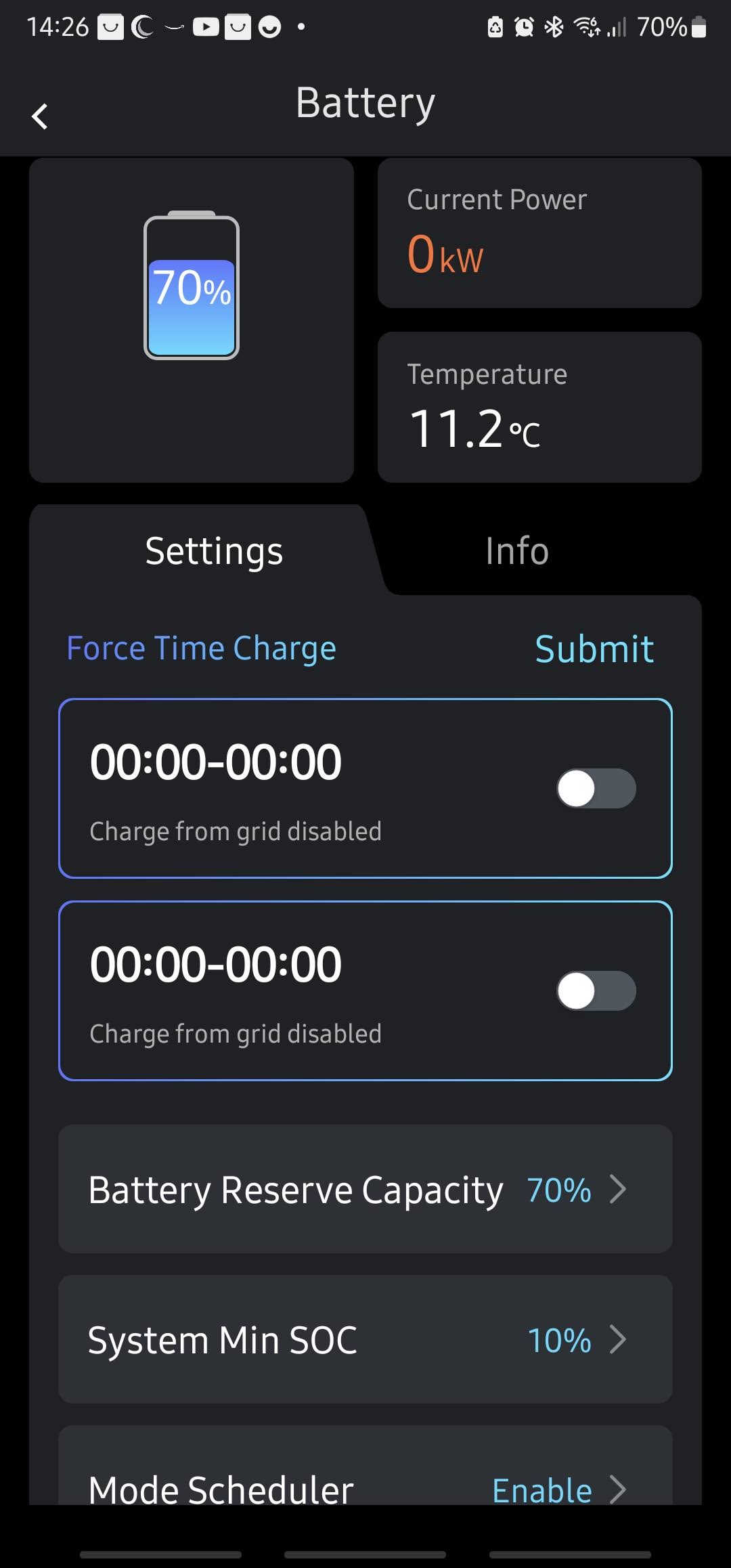

The traces you have posted don’t appear that unusual, although i’m not sure what you are trying to do with the 2 schedules that set self use from 05:30 to 16.15 and 16:45 to 23:30.
If you are setting a minsoc of 70% the batteries won’t be used unless they get above that value when charging from solar.
Normally you would just force charge you batteries in the early hours and then leave them in self use with minsoc at 10% for the rest of the day.

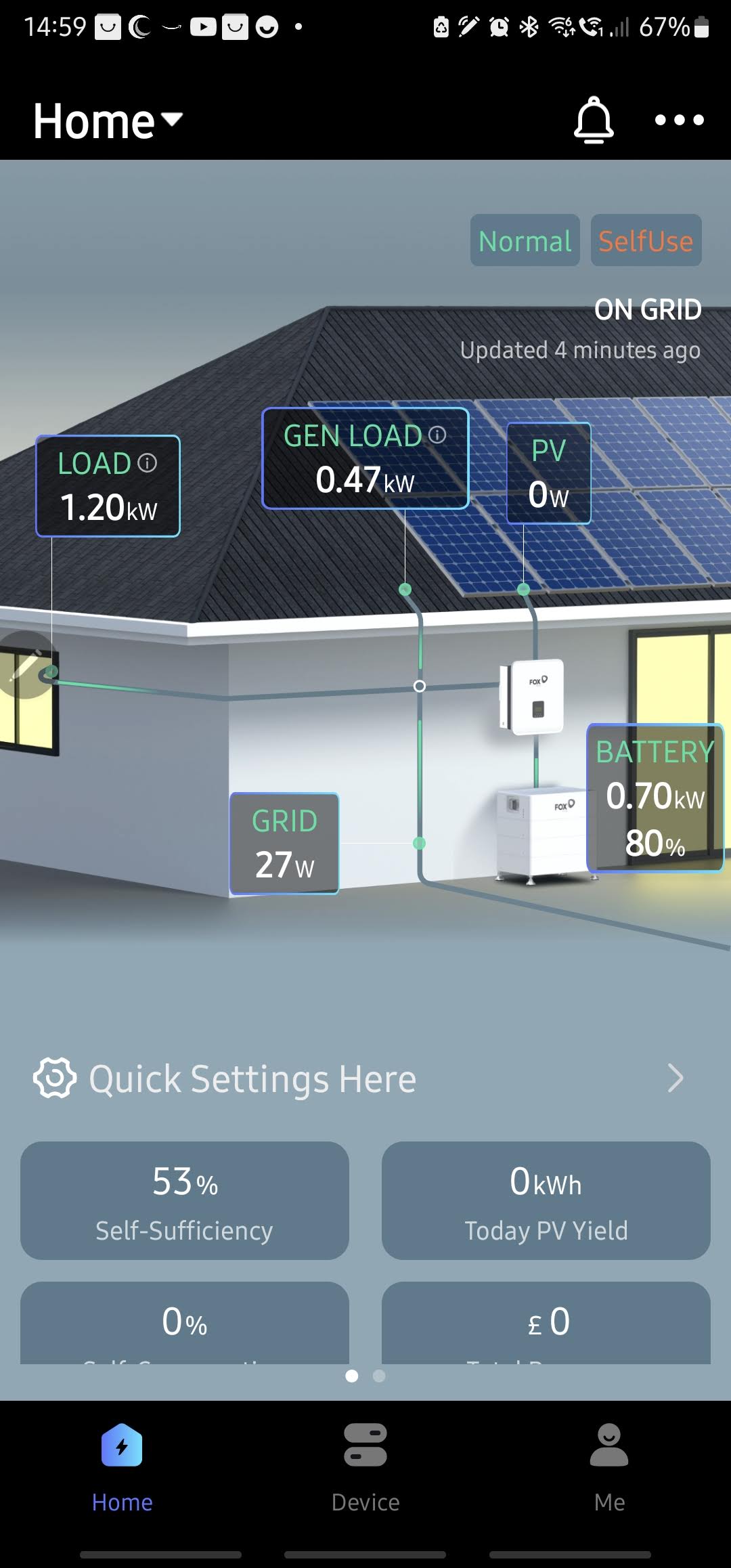

On the picture of the house, if you swipe left you will see the pv production, self sufficiency etc.. but at the bottom of the page is the daily graphs for load, grid, battery and solar and below that your state of charge - it would be helpful if you could post that so I can see how the system behaves during the day.
Sorry - I should have clarified those settings - the batteries stop charging at 0530 (at 85%) and then seemed to want to keep discharging to the grid no matter what the PV's were doing. As they weren't being charged by solar I decided to set a limit on this vampire drain from at 70% and then once the PV stopped generating (around 1630 ish) the batteries could kick in until 2330. If the PV charged the batteries as I would have expected this wouldn't be necessary. I can show previous days where this has been the case ie., both the batteries and the PV both merrily discharge to the grid.
