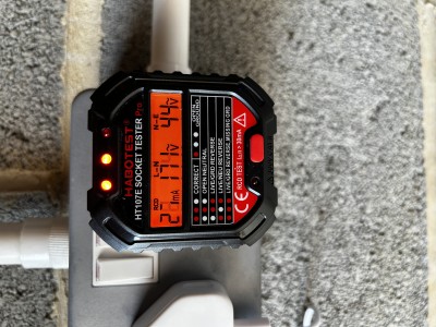

We got a fox hybrid inverter fitted and I've just gone to connect a battery system to it (Fox ess) and discovered that the installer never even earthed the system. Is this usual practice in the UK if inverter is in the attic?
I checked in the inverters handbook and it mentions the red led being on if there is an earthing fault, yet the engineer said it was on because we had no battery system.
- Posts: 1854
The inverter will be earthed via the ‘grid’ connection - this is the main LN-E feed from the grid, if you mean the earth point on the right hand lower side, that is the earth take off point to earth the battery pack - it can also used in off-grid connections where no earth is presented to the grid connector.NorthernLad wrote: Tue Aug 13, 2024 9:52 pm We got a fox hybrid inverter fitted and I've just gone to connect a battery system to it (Fox ess) and discovered that the installer never even earthed the system. Is this usual practice in the UK if inverter is in the attic?
If the inverter detected an earthing fault it would disconnect and stop operating.
The red light is simply an ‘error’ light which would be illuminated if there were no battery pack fitted.
As you are connecting a battery system, you simply connect from the earth point on the lower right hand side to the earthing point on the battery pack (if you have the HV series you have to daisy chain it between each battery pack).
