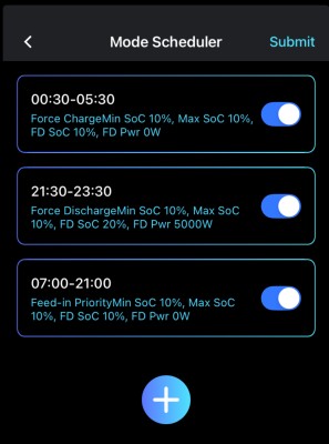

I setup so that my battery charges in the cheap rate and will discharge a couple of hours before. It did discharge but then this morning it was at 10% and had not charged. Can you help and let me know if these settings are incorrect?

The MaxSoC on the first schedule between 00:300-05:30 should be set to 100%, at 10% it will not charge at all.
MaxSoC only affects gird charging and when the batteries are at or above this the charge schedule will be ignored - change that to 100% and all will be good.
