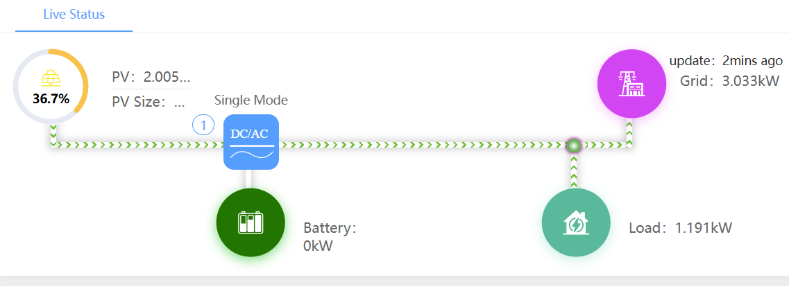

That didn't work still, but I have been playing around with the work modes, to see what actually does what and have managed to really confuse my inverter software :lol:
The inverter now considers power over 2kw as coming from the "load", which in my case at least is impossible.
I've emailed Foxess to see if they can sort this out.
If no reply I may try a inverter restart.

Re: Prevent battery use in a given period
It sounds like your Manager may have crashed, make sure all your schedules are clear and do an inverter restart (PV off, AC off, Battery off - wait until the screen goes blank and then battery on, AC on, PV on)
I’m suspecting you may have older firmware, so I would recommend you get updated to the latest.

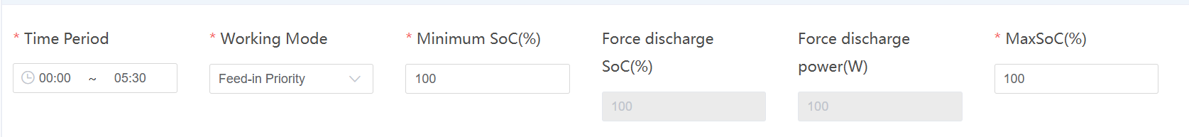

On the latest firmware I have, which is:
Model: KH10.5 - Master: 1.43 - Slave: 1.01 - Manager: 1.42
Last night I had this work model, see screenshot. Min SOC 100% is the key component - I was wondering what it would do.
At midnight the battery started to charge from the grid at a rate of 1.25kw.
My question is, why 1.25kw?
Thanks!
if42 wrote: Fri May 16, 2025 11:10 am On the latest firmware I have, which is:
Thanks!
When you raise minSoC above the current SoC level the BMS requests a maintenance charge to bring the SoC up to the same level (i.e. not a full power charge), this is the same as would happen should SoC drop below 10%.
The maintenance charge is at approx 4A and is hard coded - it which would suggest your battery voltage was approx 312V at the time.
