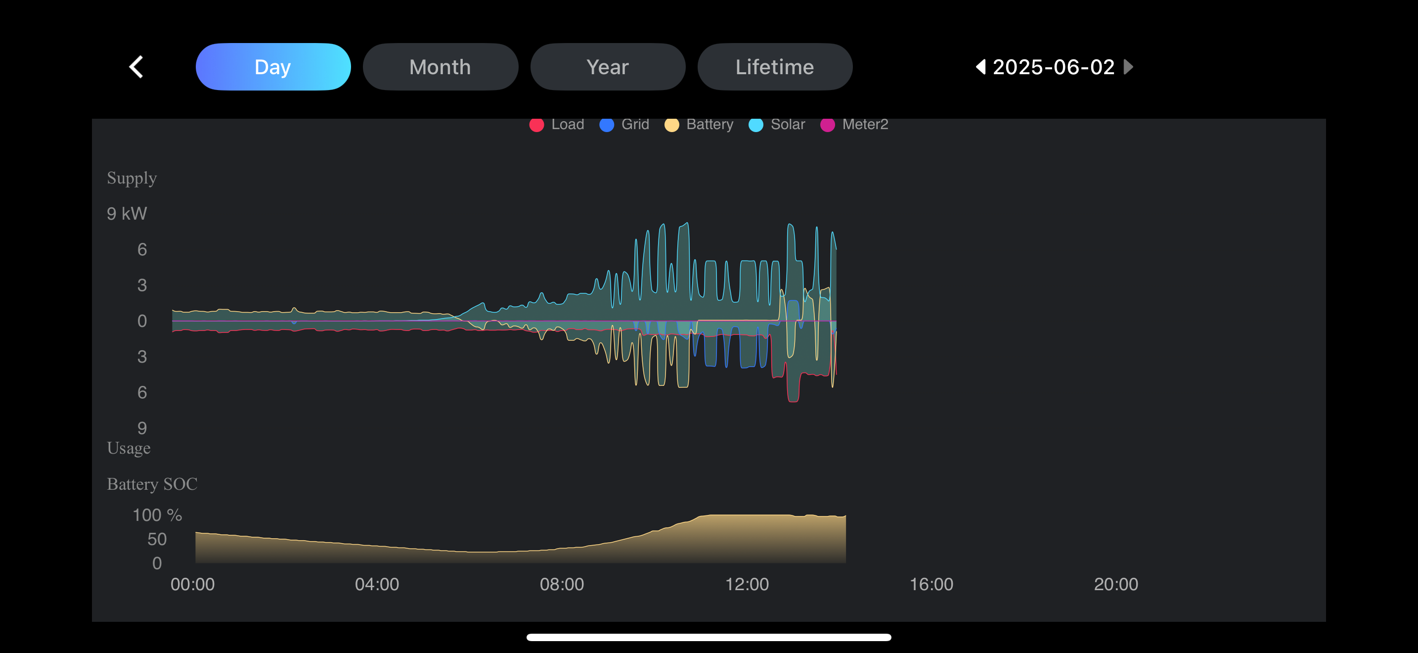

2) Second issue is I noticed there is clipping of solar export to grid at 5kW (see below). During sunny days/10am-4pm. The energy coming off the roof seems limited to 5KW for export if I don't use it, and everything generated above this is wasted, whereas if I do use it, the roof can send 8-9 kW down through the inverter and send some of it to load and up to 5 kW of the rest to grid. Is this right? Have they given me an underspecified inverter? Or is this limit set by UK Power Network? Or can it be manually altered on the inverter settings?

What size inverter do you have is it H1 5kW or 6kW ? (this is likely what your G99 limit will be) and how is the string setup - 2 strings of 9 ?
Normally you would spec an inverter approx 15%-20% over the maximum inverter capacity so 8.1kWp is a big array and will be prone to clip on the very sunny days as the AC output of the inverter can never be more than it's maximum capacity (but great in winter when irradiance is low)
You can charge the batteries and have max AC output at the same time which is why in the morning the peak power is higher but as soon as the battery is full it will clip at the inverter rating.
The only way to change your AC output is to increase the size (and probably model) of the inverter; that will need you to re-apply for a larger G99 export limit which could be rejected by your DNO.
