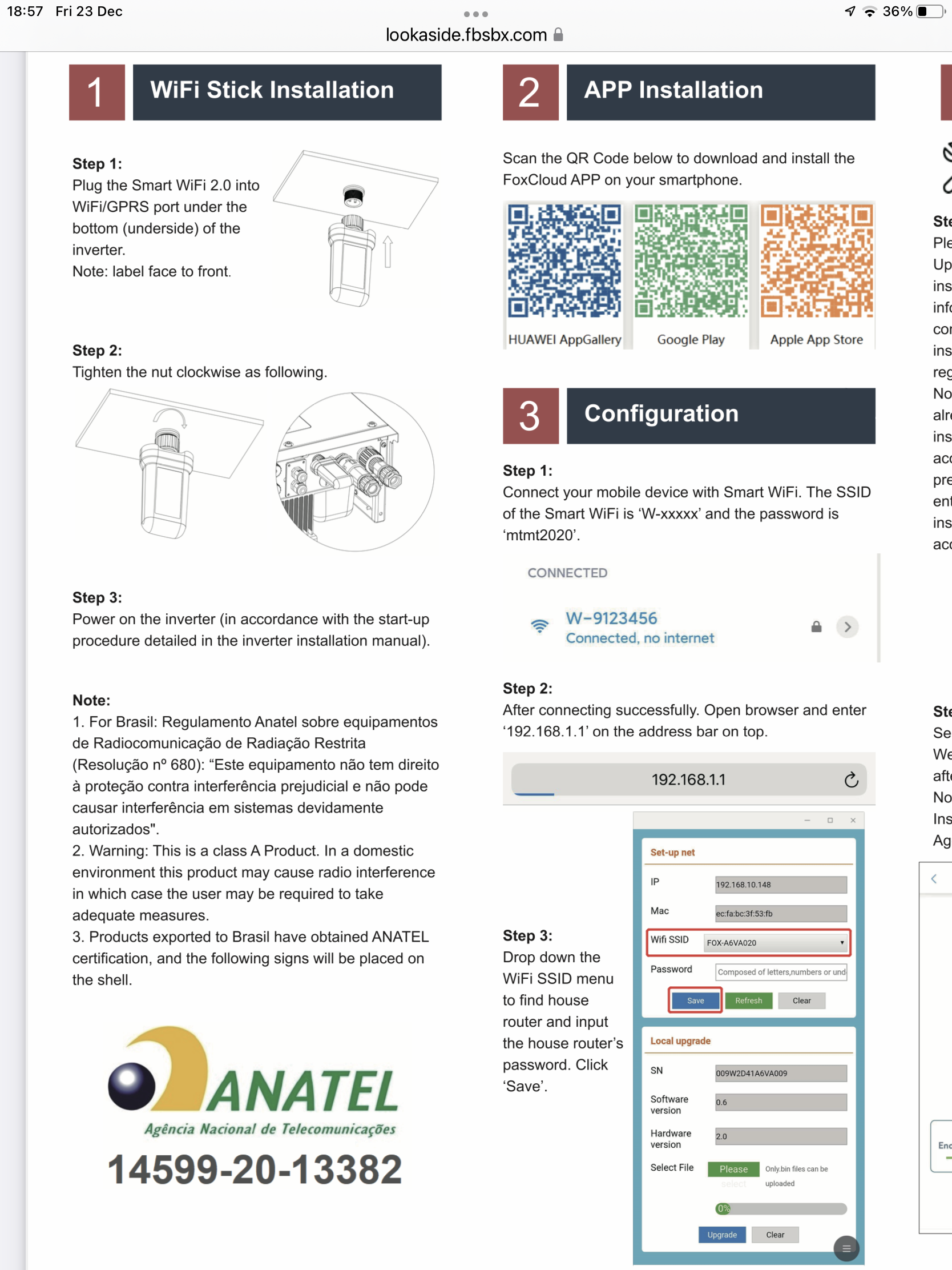

There should be a wifi network showing with a name in the form `W-....` - for instance 'W-AAA1AAA'. Connect to that network (default password is 'mtmt2020'). You will get a warning saying the network has no internet - choose to connect anyway.
Once connect, go to 192.168.1.1 in your web browser. You can then change the WiFi details the datalogger will connect to on that page.

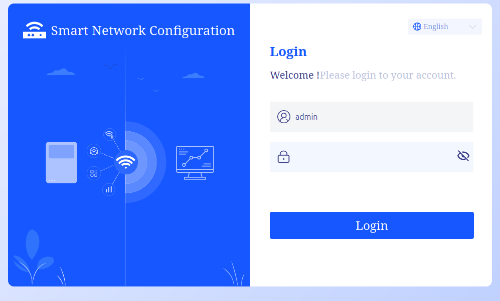

Update - had an IP engineer on the phone to set up phoneline. Apparently 192.168.1.1 needs the admin password not the WiFi one.

As long as the screen looks like the below guide (from step3), it’s the datalogger password - but you have to connect to the dataloggers ssid itself first not via your wifi.
Wow thanks - at first got " cannot connect " but then it did ! and it even looked like the picture

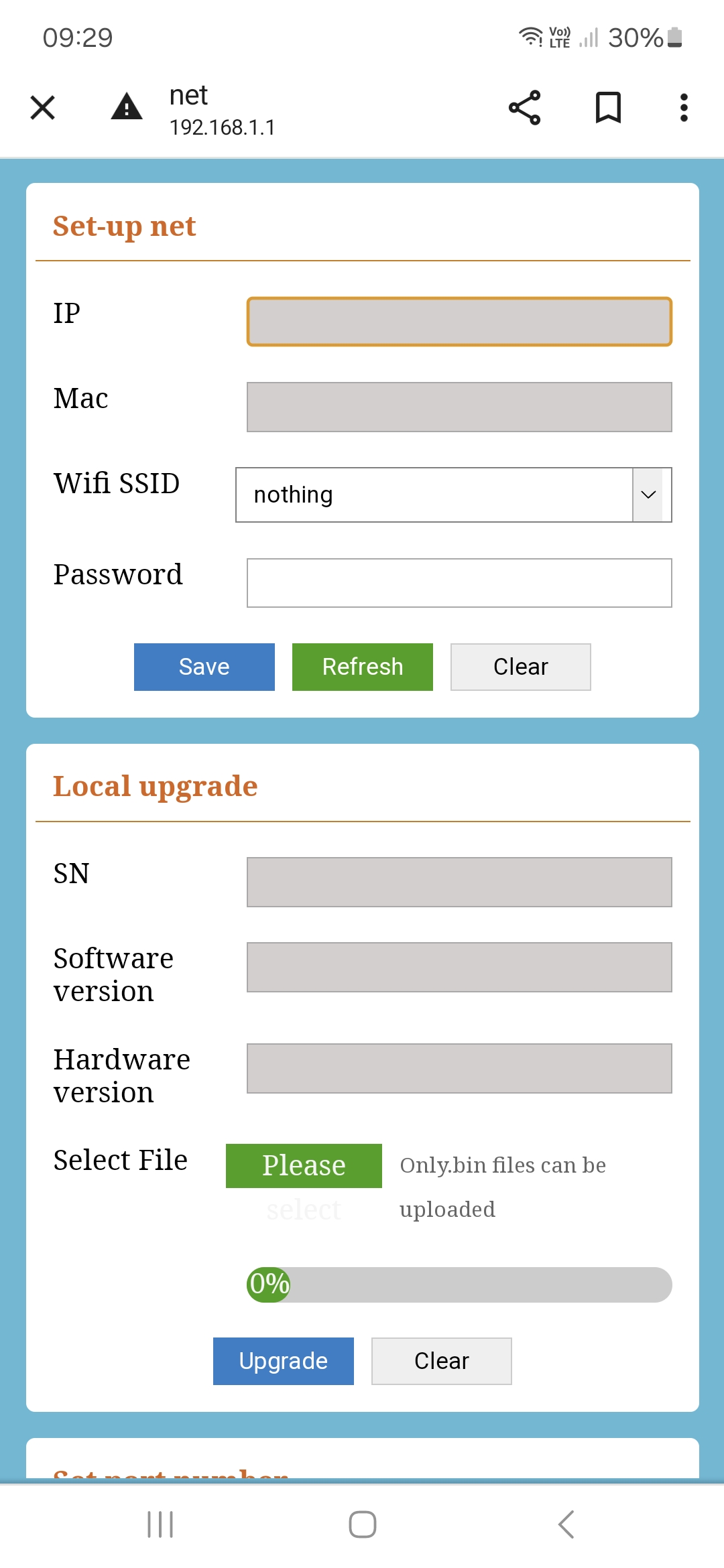

I've had the same issue after a IP change, but when I get to the details page all the fields are blank and there's no option for my house WiFi, it just says "nothing".
Can anyone help with how to populate the details?

That suggests that the new router might not have the range the previous one did.
You can try a reset on the datalogger to see if that improves things, it's fiddly to do it as you have to unscrew the collar at the top of the datalogger and then pull downwards, leave it 30 seconds and then plug it in and tighten the collar up. If you can't get access to collar the other way to do it is a full shutdown, restart of the inverter - there's a video guide here that explains that viewtopic.php?t=5
If that doesn't resolve it, you'll need to get a wifi range extender to increase your range, I use this one https://www.amazon.co.uk/gp/product/B08V5KZCXV which is very reliable, I disabled the 5 Ghz band, named it uniquely for my inverter and it's never let me down.

I cannot change the wifi SSID, it shows nothing. I tried all above but the 192.168.1.1 page keep initializing data but with no success, no IP nor Mac shows up. How to reset the wifi dongle?
I’ve found with some phones you have to forget your local internet connection - because the dongle doesn’t provide an internet connection the phone disconnects part way through and re-connects to your normal wifi, try forgetting your normal wifi connection.rafal.baranowski5 wrote: ↑Thu Aug 29, 2024 3:54 pm I cannot change the wifi SSID, it shows nothing. I tried all above but the 192.168.1.1 page keep initializing data but with no success, no IP nor Mac shows up. How to reset the wifi dongle?
You can totally reset the dongle by unscrewing the collar at the top, pulling down to remove it - wait 15 seconds, then re-connect and screw the collar back up.

Hi , i am stuck !
I get to the login screen but not sure what password to use (see screen shot )
the new router is a Lynksys SPNMX55 provided by connect fibre
