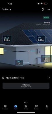

I have H1 Hybrid inverter (no hub, US Series) with a battery. I also have AC coupled (enphase) solar system. I have had the solar feeding through the inverter for a year now and just got the battery hooked up. The inverter will successfully read the Solar power using the single solar CT, but I have the grid shows zero always. This means I can not use Self Use mode. Mandatory mode works and I can successfully charge and discharge the battery. I also have a consumption meter (enphase) on the grid power so can confirm when I am pulling or pushing power to the grid.

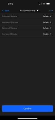

I have seen a few places that sometimes the CTs need enabled, but I can just determine where that is in the new Cloud 2.0 app. One setting that I did find in R&D (other) -> Grid CT communication check. That was enabled, but the solar CT communication check was disabled. So I disabled the grid one too, not sure if maybe I need to power cycle the inverter now? Unfortunately I have not found a simple setting to enable/disable.

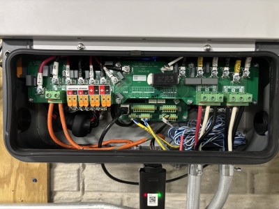

I swapped the two grid CTs in the solar input and both showed power flowing in the app so I know that they work. It just seems the inverter isn't reading them.

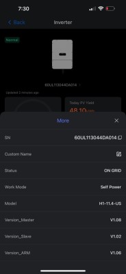

My inverter software version is in an attached image as well.

I do have installer access (self install) so have the whole settings. For whatever reason my settings only allow me to enable and disable the solar CT. I am putting in an official support request, I am hoping I have old software.
In the US we actually have 3 CTs. One for solar and then 2 for our split phase 240 AC system. We have circuits that run only on one phase (120Vac) so the current between phases can be unequal. Either way I am 100% certain the CTs function and are wired correctly.
