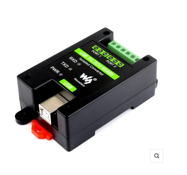

I'm going to try this unit: https://thepihut.com/products/usb-to-2- ... -converter
I am hoping to see /dev/ttyACM0 and /dev/ttyACM1 in system hardware, representing virtual serial ports created by the above device. I'll select them manually in the Foxess setup wizard (see attachment... but it might work automatically on ACM0 without needing to re-run the setup). The ACM1 will then service the RS485 sensor slaves in the airing cupboard.
