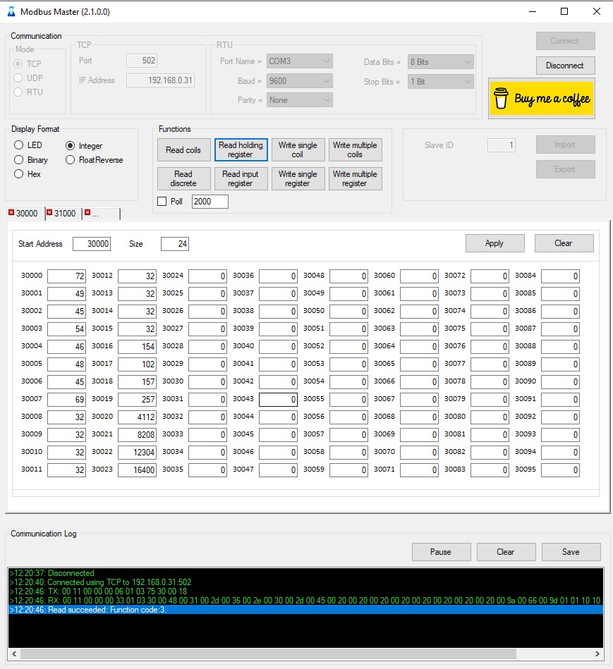

Probing my H1-6.0-E inverter at modbus address 30000 and finding a bank of 24 registers with values like this:
This thread is intended to look at these values and to try and work out what they might be.

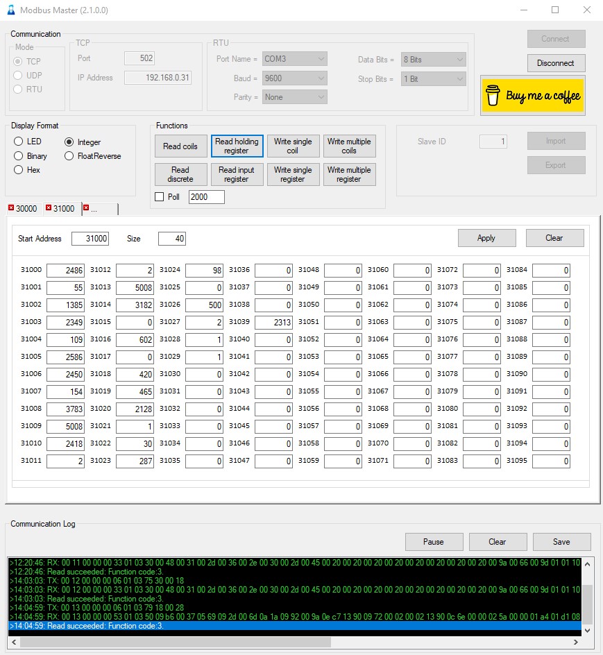

Looking at this, its hard to work out if there are new values here, so I've captured my HA dashboard (connected via RS485) and taken screen shots of the 30000 and 31000 LAN registers at about the same time:
For example, RS485 is reporting BMS kwh remaining at 8990 but this does not appear in the values.
This capture is a few hours later and none of the values for registers 30000 - 30023 have changed, so I'm tending towards the conclusion this might be a red herring and we could be looking at static data of some sort?
