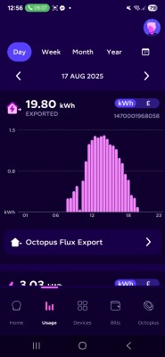

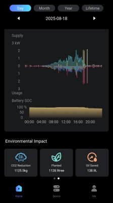

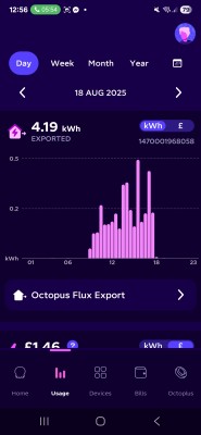

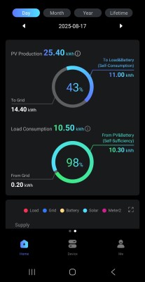

Can you post some screenshots from your app (swipe left on the main page) for a good sunny day and an over cast day (you can change the date at the top) - that should show your typical usage vs generation to give you a better view.

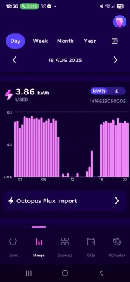

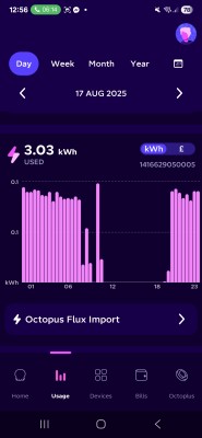

these are the screenshots from the Octopus app and the Fox app, they don't seem to tie up
You are definitely generating a lot of power which is being exported straight to the grid, the power you are using overnight appears to be your normal base load and the battery is not being used to run the house - so something wrong there.
For the same time periods can you screenshot the app but scroll the screen up so I can see the graph and battery soc please.

The inverter traces appear to show correct operation, it doesn’t look like you use much power in your house the 18th suggests 10.5kwh and the 17th only 4.3kwh - do they seem credible values.
The stats also intriguingly show your grid import is very low on both days, yet your octopus shows a small trickle of power being used that is not being recorded by the inverter stats which suggests that your CT clamp may be mis-reading.

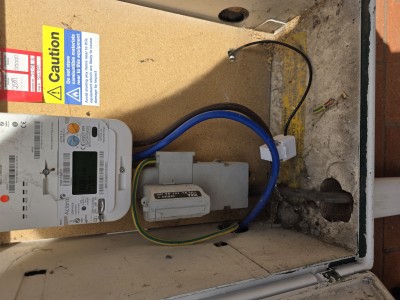

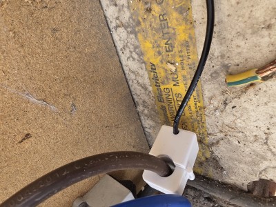

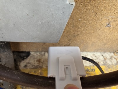

The CT clamp is not perfectly accurate - possible 1-2% different from your smart meter but that level of inaccuracy suggests a problem - perhaps the wrong CT clamp used or it is placed too close to another CT clamp (such as an EV charger) that is affecting it. Would you be able to take a couple of pictures of your meter cupboard - one that shows the overall cupboard and it’s contents, the second a closer shot of the CT clamp (usually a small white or black clamp clipped to the live feed from the smart meter).

See attached photos, thank you

Ok it doesn’t get much simpler than that for a meter cupboard, the CT clamp is the correct type and located in the correct place.
I can see why they would have got the CT orientation wrong, you would normally expect the arrow to be pointing in the opposite direction but as it is reading correctly they must have crossed the wires over at the inverter when it was installed so that also answers that mystery.
So other than the slightly high grid use it appears to be working fine and on sunnier days is exporting well to the grid.

No it’s definitely reporting correctly all the metrics are in the correct phase - it’s not the easiest to read the graph but you get used to it.
i.e. your grid (blue) is below the ‘0’ line during the day which is correct for export, your load (red) is also below the line which is correct, you have some battery charge (yellow) below the line and some battery discharge above the line and you can see the battery respond to load (as an example on the 18th you have 3 large ‘red’ load spikes around 6pm and 3 equal sized battery discharge spikes) so it’s measuring and working correctly.
