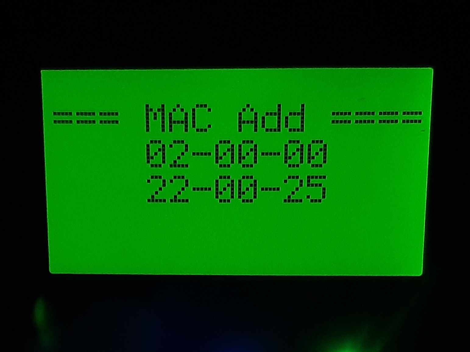

First, go to your inverter front panel, About, MAC Address and make a note of the MAC address for the ethernet port on your inverter.
Now, login to your router, find it's DHCP settings and add a static lease for your inverter using the MAC address. If you don't do this, there is a risk the router will assign the inverter's IP address to another device and wierd stuff will happen.
