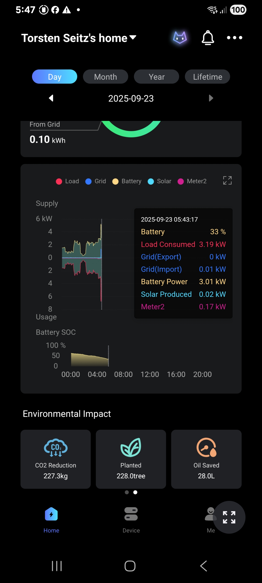

Re: Battery draining overnight
Really need to see your data, can you post the graph from the app, swipe left on the home page and screen shot the graph at the bottom of the page that shows the load, grid, battery and underneath it the battery soc.
