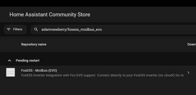

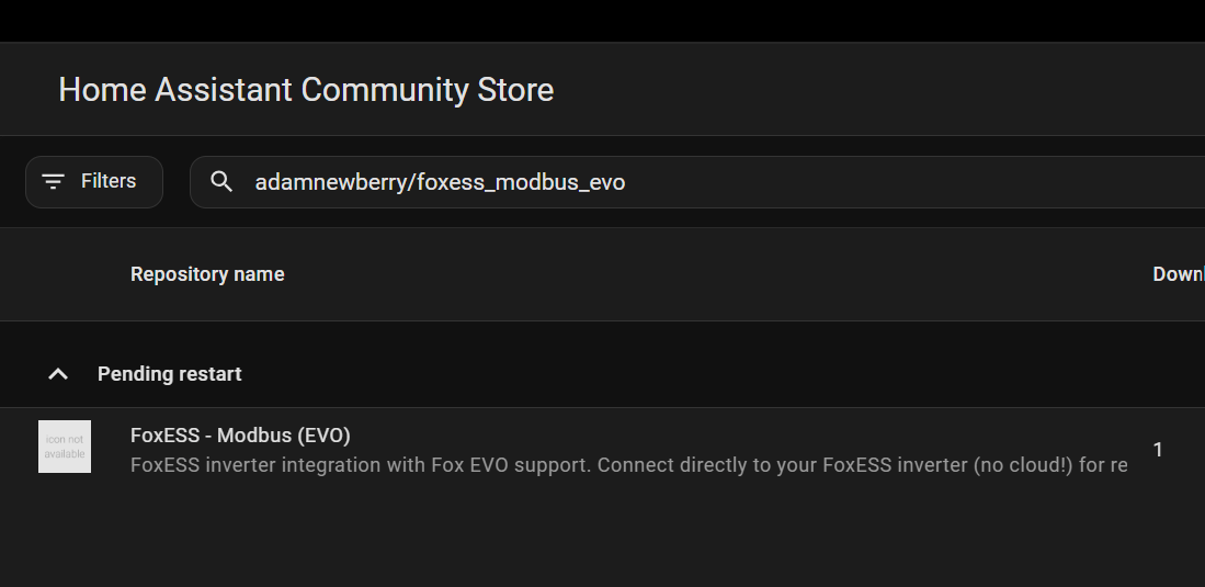

can you try again - i fixed a couple things!
My fork should appear in the HACS store along side Nathan's original.
i just downloaded it fine from the hacs store.

It Worked! :) Thank you so much for your hard efforts! It's great to finally have real data without relying on the cloud.
I've connected my Evo 10 with a LAN cable (for those of you who are interested).
Thank you again!

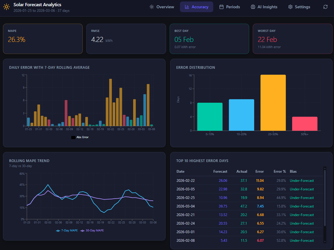

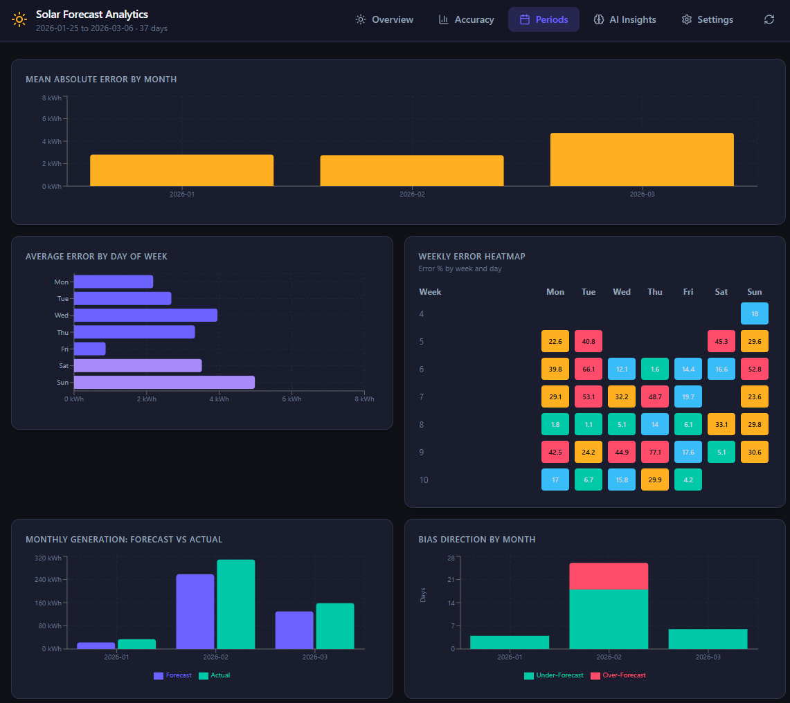

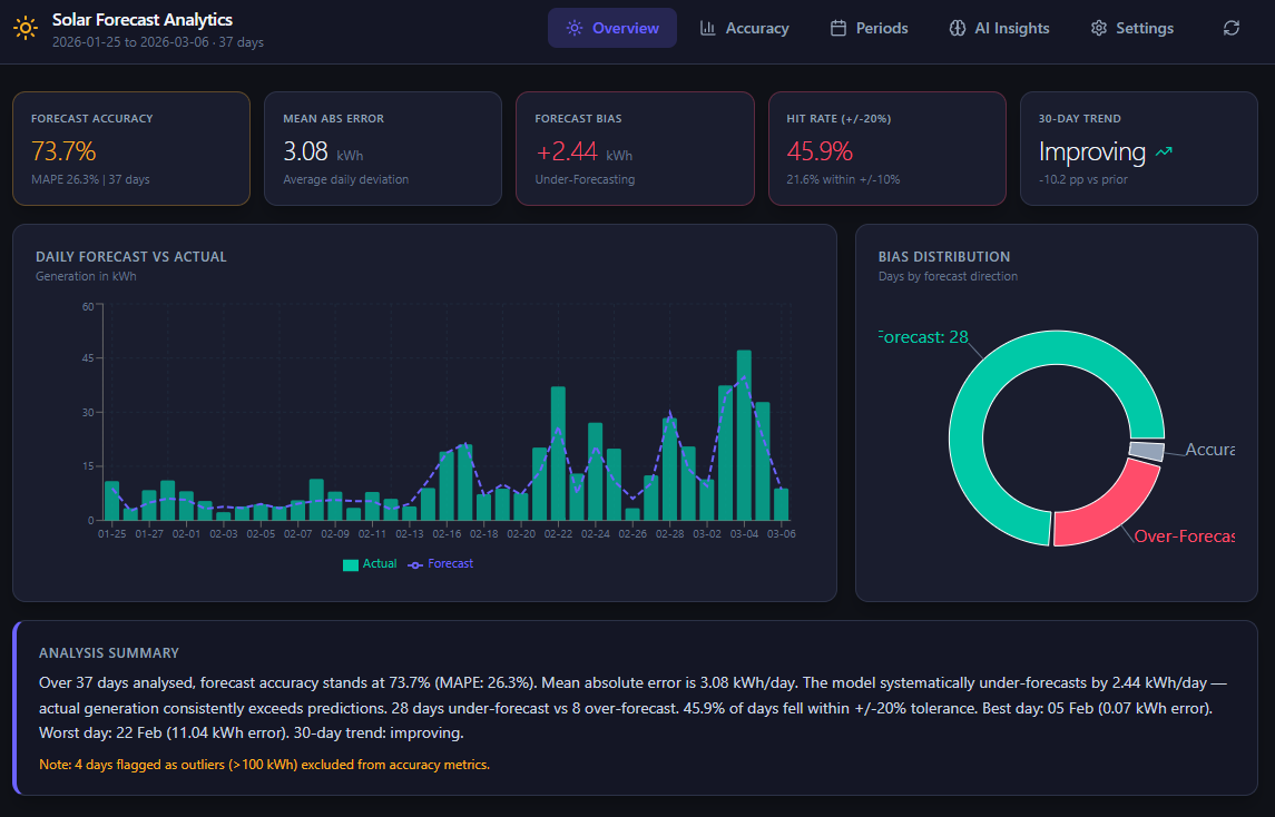

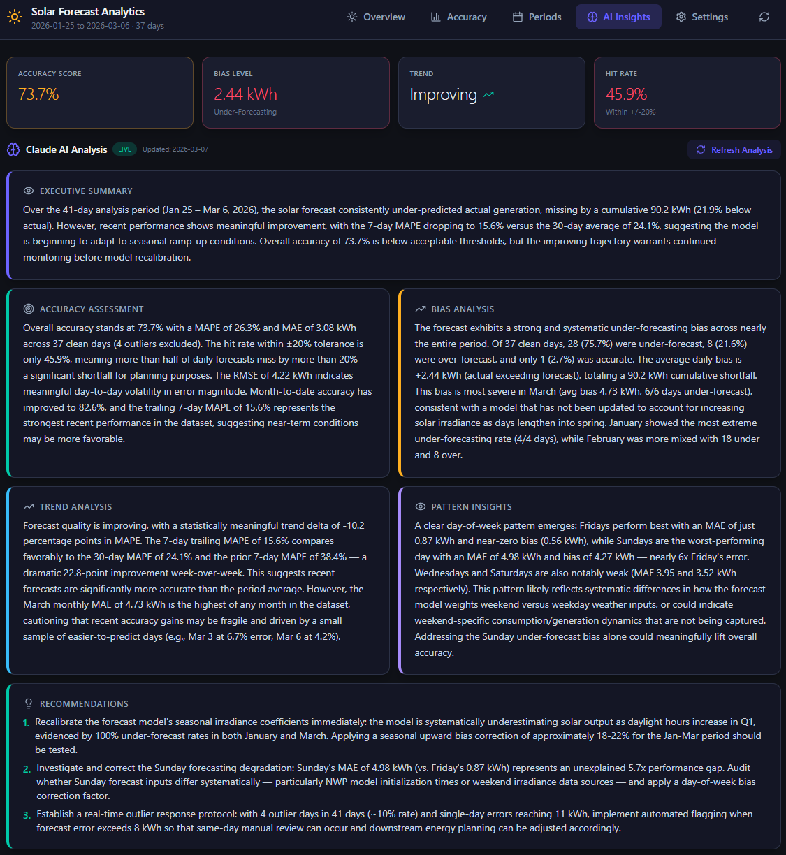

I built an app that does some analysis on forecast accuracy for me... only got a months worth more or less, but its interesting data. my system is consistently over producing vs forecast from Solcast!
whacked in my claude API key to see if it could give some recommendations too!

I haven't looked at my forecast tool built into HA too much, I just needed a rough figure to program a discharge if it thinks there's going to be enough solar. I do this as my export limit is 3.9kW on 6.16kWp, and I clip in Summer naturally.
I have it dump power if it forecasts above 12kWh for the day, seems to work and I can adjust this figure up and down.
That does look mighty good, and even more impressive is getting better than expect performance.
