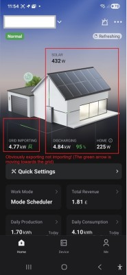

2) Forced Discharge imports at ~200W after the discharge target is reached even though there's solar and the battery is at 94%. Would expect it to switch back to Self-Use mode.

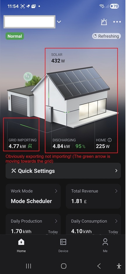

3) Minor issue with the app/web showing "Grid Importing" when the unit is obviously exporting.

Hi, not unless the installer set it, and I don't think they did. This is when the battery was force exporting 4.84kW and the display says "Grid Importing" !
From memory the 1.09 firmware used to say "Grid Importing" and "Grid Exporting" - the 0.23 version either says "On Grid" or "Grid Importing", so I guess maybe someone inserted a string rather than editing it ?!

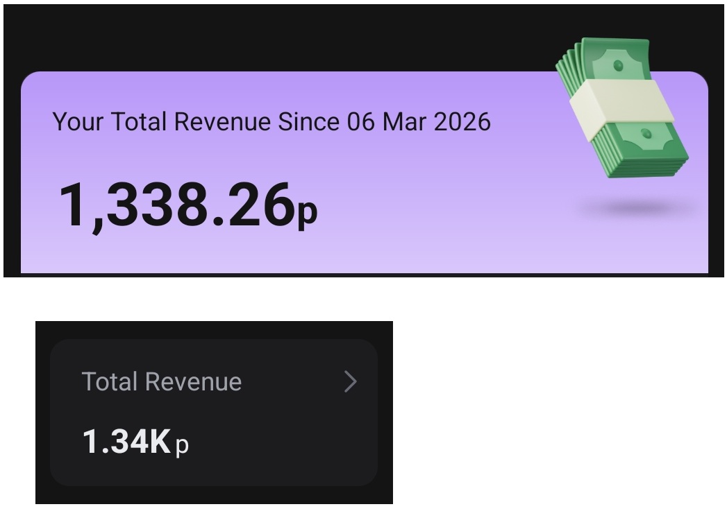

Found another display bug - I've now made £13.38 from solar savings and FiT revenue according to the app, but the app shows it as either "1,338.26p" or "1.34Kp". Silly little issue but easily fixed...

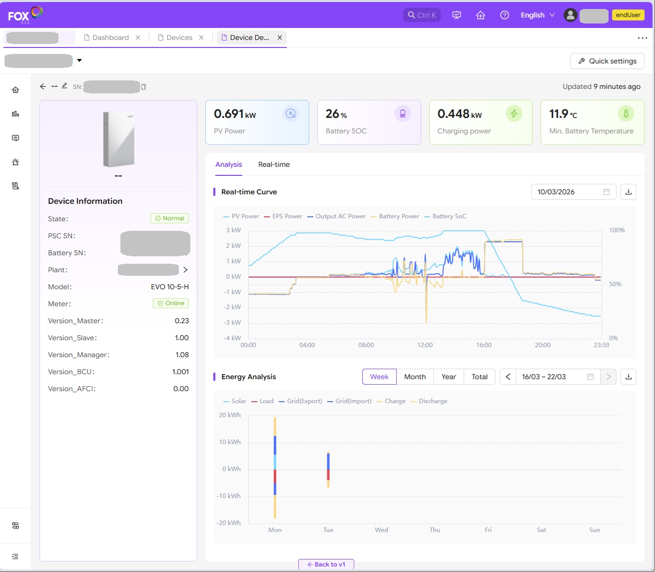

Unfortunately I don't get the filter button...
(Screenshot attached)
The two download buttons just give CSVs of the values shown in the graphs - battery temperature isn't one of them.
The "Real Time" tab doesn't show the bat temp or have any download/history option.
I'm downloading all variables from the history_query() API, but none of the temperatures available seem to match the currently reported 11.9C Min. Battery Temperature...

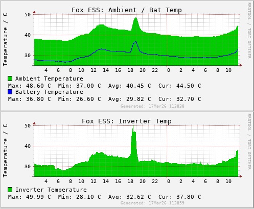

And looking at the data "Ambient Temperature" is rubbish! It's about 11C outside...
{"data":[{"time":"2026-03-17 10:31:01 GMT+0000","value":41.8}],"name":"AmbientTemperature","unit":"℃","variable":"ambientTemperation"},

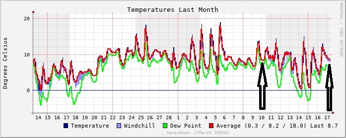

If Min. Bat Temperature is close to the outside temperature then the first test was run at about 9C and the second at about 9C as well...

Not sure about where the Ambient sensor is located, but in a cold garage with no Sun, it sits nearly always above 30°C day or night. Currently at 33°C, and the garage will be cold for sure.
Wondered if maybe it was reporting in Farenheit, but the dashboard is currently showing 12.8C which is 55F and the API is reporting 43.5 which would be 6.1C...

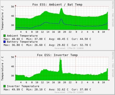

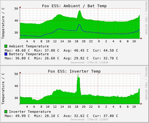

Just for fun this is what the API has been reporting for temperatures over the last day or so. The 6PM peak is when it was exporting to the grid at ~5kW...
