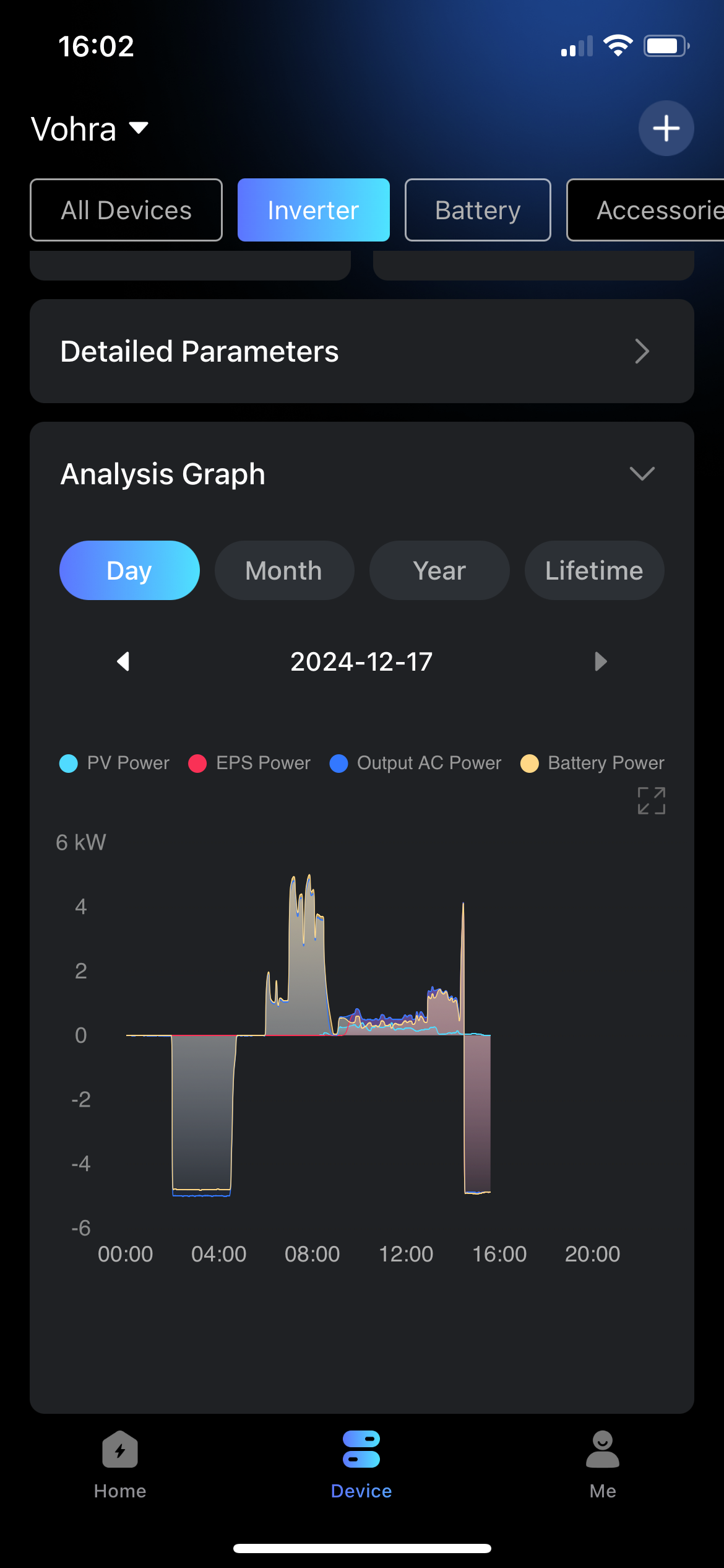

Can anyone make sense of what is happening with our current set up?
At present we produce little or no solar due to the time of year. We are on Octopus Flux so I am charging the batteries overnight from 0200 to 0600 (lower rate of elec from 0200 to 0500) aiming to use them rather than drawing from the grid. The Oil fired heating comes on 0630 to 0830 and very little else is used , kettle boiled once, a few lights on, thats about it.

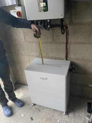

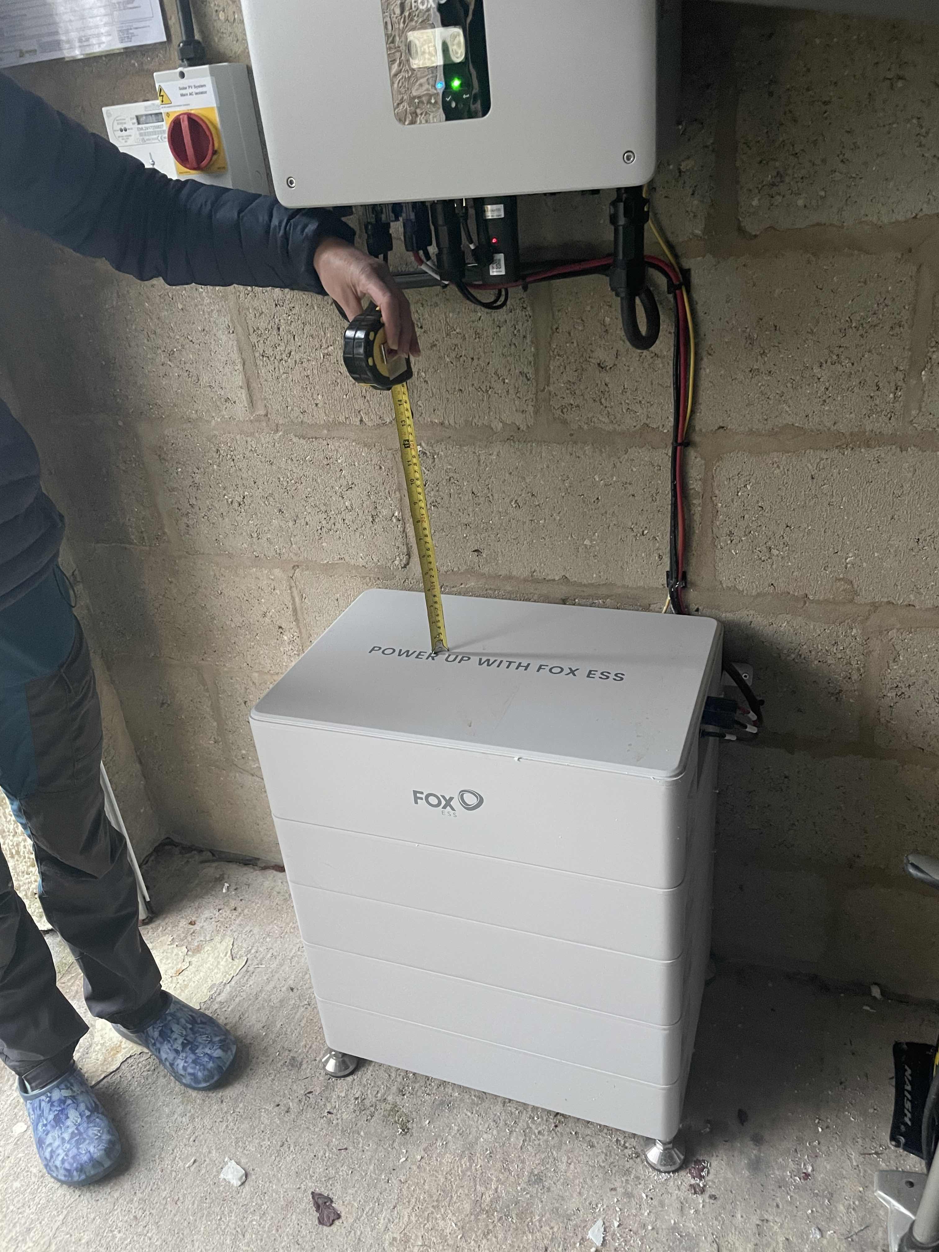

I can't understand why the battery charge drops so quickly. The batteries are now in an insulated box (after seeing the post here) and the temperature is not dropping below 10 degrees. There is nothing on in the house that would draw loads of electricity .
I would be grateful for any input because I am so frustrated with this. Could Octopus be exporting from our batteries ??

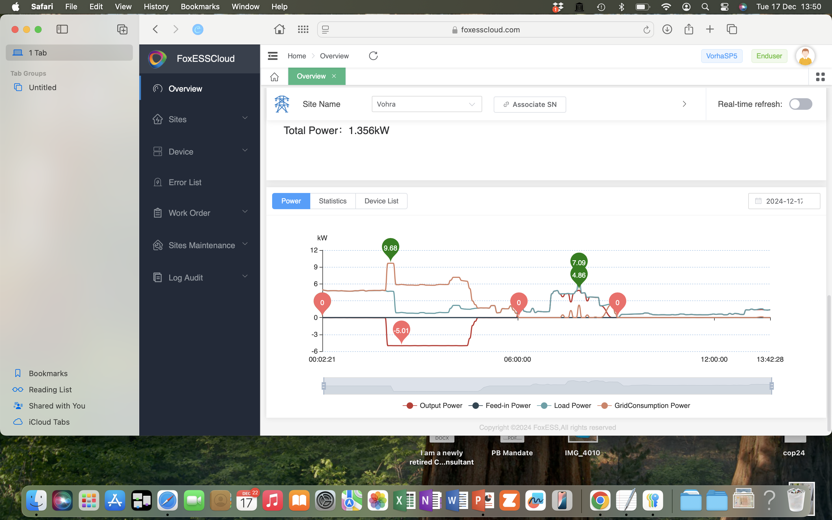

I have attached a screenshot of the Fox Ess graph
Hopefully you can see it
Many thanks
Belinda
Battery discharging ...not sure why

Can you tell us which inverter H1-5, KH7 etc.. and what batteries you have (the type HV, ECS, EP the number of packs and if you know what the battery capacity is), also what your System MinSoC and Battery Reserve (also called MinSoC on grid) are currently set to i.e. 10% ?
From the graph I can see you are charging the batteries at around 5kW for approx 2.5 hours which suggest a battery capacity of 12.5kW
But from midnight your load appears to be just over 5kW and it continues until approx 2.30 - this is very high, storage heaters, water heater, EV charging ?
Your load then continues between 1kW and 2kW until 06.30 which seems to be more than the load from a few lights on - what else is in your base load ~ fridge, chest freezer, wine cooler ?
What I can see from the graph - from approx 07:00 to 08:30 there is a substantial load in the order of 5kW reducing to a base load of approx 500 watts at 9am
From approx 9am to 1pm it continues at ~ 500 watts with a slight uplift towards 1.5kW at the end of the trace - there is no grid consumption up til then so likely your batteries are still supplying the power - from my rough reckoning you've used approx 10kW which is a substantial load - is that what you are expecting ?
There is no evidence of any export to the grid, your feed-in remains at zero

Hi Dave,
Thank you so much for replying
Inverter H1-5.0-E-G2
Battery : ECS2900-2
1 Master
4 Slaves but had 2 more installed today so now 6 slaves.....not sure what total capacity that now gives ?
Min SOC is 10 %
Base load
1 small chest freezer
1 small drawer freezer
1 large American style fridge freezer
I am lucky enough to have an endless swimming pool which I don't heat as I like open water swimming but if will not allow the temperature to drop below 15 degrees C so it may be the heater kicking in from time to time.
No EV charger being used
We also have a small separate annex that has electric heaters that come on in the morning and evening and it has a fridge thats on all of the time.
Maybe with all of that lot on thats what the drawer is thats depleting the battery. It just seems too vary. Sometimes Ill look in the morning at the app and the battery will be at 90 % other times, eg this morning it was at 59%
Maybe any expectations are just too high

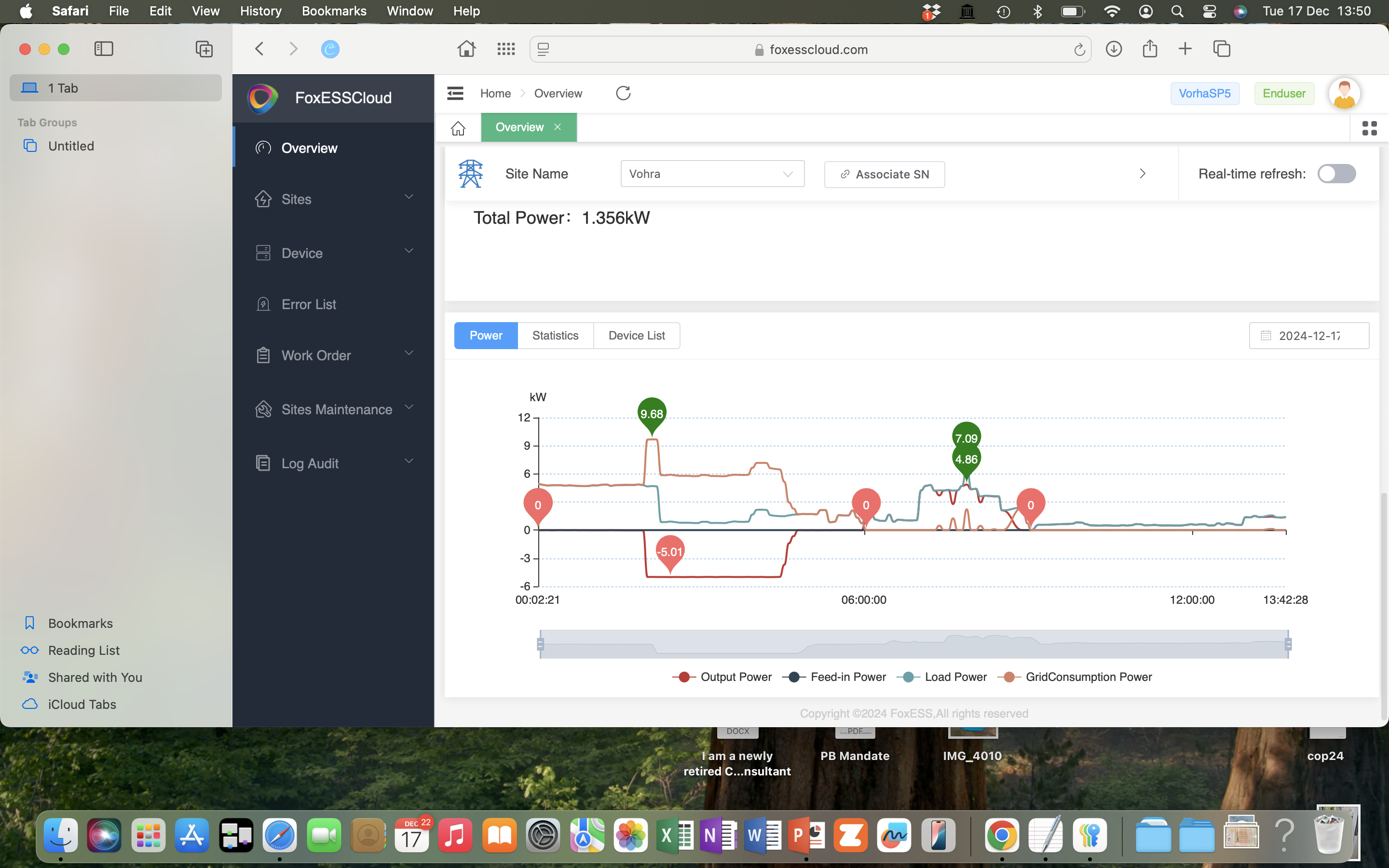

Ive added a couple more images

Ok, that makes sense - you had 1+4 which is 5*2.88kW=14.4kWh and at 10% minSoc you’d need to charge with 12.9kW which is what your graph suggests (I was close at 12.5kWh)huminga1 wrote: Tue Dec 17, 2024 4:05 pm Hi Dave,

Now you have 2 more batteries once they have balanced you’ll have 20.16kW which with a 10% minSoc gives you 18.15kWh
The american fridge freezers are quite power hungry but nothing in the league of those big loads from either the swimming pool or the annex electric heaters.huminga1 wrote: Tue Dec 17, 2024 4:05 pm Base load

I suspect the variable behaviour you are seeing is just down to lower temperatures, it only takes one of those ‘big’ heating elements to come on and you will burn through your batteries very quickly so if there’s any way you can limit them to come on between 2am and 6am it would make a big difference to your battery soc when you wake up.
With your extra batteries you won’t be able to fully charge them from flat in the 2am-5am slot, it’ll probably take that extra hour you are giving it to fully charge - but keep an eye on that, if you’re not hitting 100% by 6am you might need to extend it slightly, these batteries really need to get to 100% occasionally for them to balance properly.
If you have any heavy loads where you can control when they run, the other thing worth considering is switching to Octopus Go. The tariff has a longer "off peak" period and they have recently increased the "feed in" rate to 15p/hr.huminga1 wrote: Tue Dec 17, 2024 4:46 pm Hi Dave,

The battery is below 15 degrees today despite all of my insulation bur it is -2 here today .
