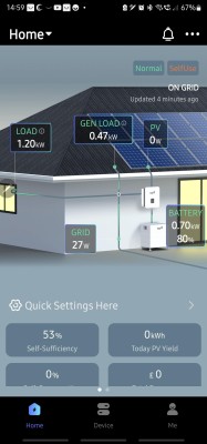

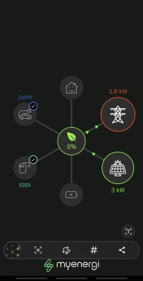

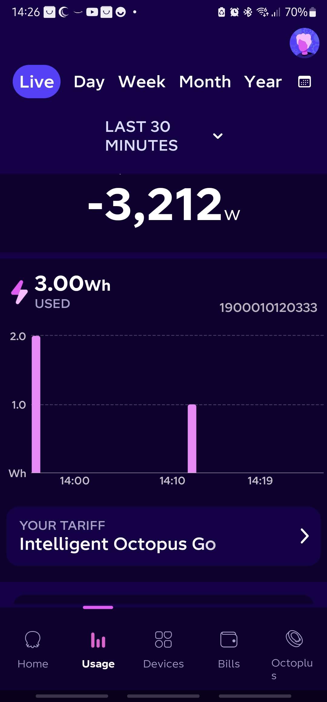

CT clamps to the Myenergi devices were incorrectly re-placed by the installers (the PV's were taking in power rather than generating it) so I did have some fiddling to do to make things work as expected. I say this in case I've inadvertently cocked things up. My problem now is that the batteries do not take any surplus energy from the PV's. The FoxESS inverter sees them as a generating 'load' but it's all going to the grid. The installer either doesn't know or isn't interested in a solution. Can anyone give me some help/advice please?

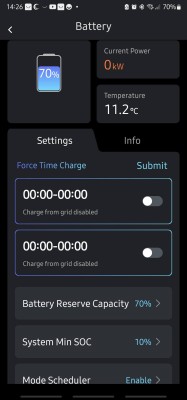

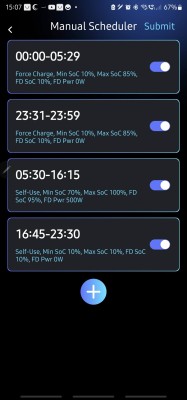

The traces you have posted don’t appear that unusual, although i’m not sure what you are trying to do with the 2 schedules that set self use from 05:30 to 16.15 and 16:45 to 23:30.
If you are setting a minsoc of 70% the batteries won’t be used unless they get above that value when charging from solar.
Normally you would just force charge you batteries in the early hours and then leave them in self use with minsoc at 10% for the rest of the day.

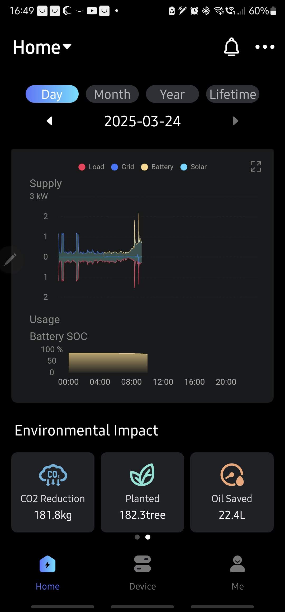

On the picture of the house, if you swipe left you will see the pv production, self sufficiency etc.. but at the bottom of the page is the daily graphs for load, grid, battery and solar and below that your state of charge - it would be helpful if you could post that so I can see how the system behaves during the day.

Sorry - I should have clarified those settings - the batteries stop charging at 0530 (at 85%) and then seemed to want to keep discharging to the grid no matter what the PV's were doing. As they weren't being charged by solar I decided to set a limit on this vampire drain from at 70% and then once the PV stopped generating (around 1630 ish) the batteries could kick in until 2330. If the PV charged the batteries as I would have expected this wouldn't be necessary. I can show previous days where this has been the case ie., both the batteries and the PV both merrily discharge to the grid.

This is what DOESN'T happen. The PV sends to the house load and the remainder goes to the grid as if there is no battery. If the Eddi is switched on then it will divert there too.
If the batteries are not charging from the solar (and there is no sign of it on your traces) that suggests the inverters CT clamp might not be in the right place and it isn’t measuring the generation correctly.
You are correct in that the Zappi is on separate tail so is not seen by the batteries. The interesting thing is that if I move the battery CT clamp that is measuring grid i/o to the feed directly from smart meter to the main consumer unit then all is well: the battery and PV and Zappi see eachother: the batteries are charged by the PV as expected. The big drawback is once an EV is plugged in the battery drains out! I am therefore having to leave it in this position and then set the battery to either force charge overnight (a pain with this sunny weather) or force discharge at 0 during sunlight hours with the EV plugged in.
