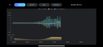

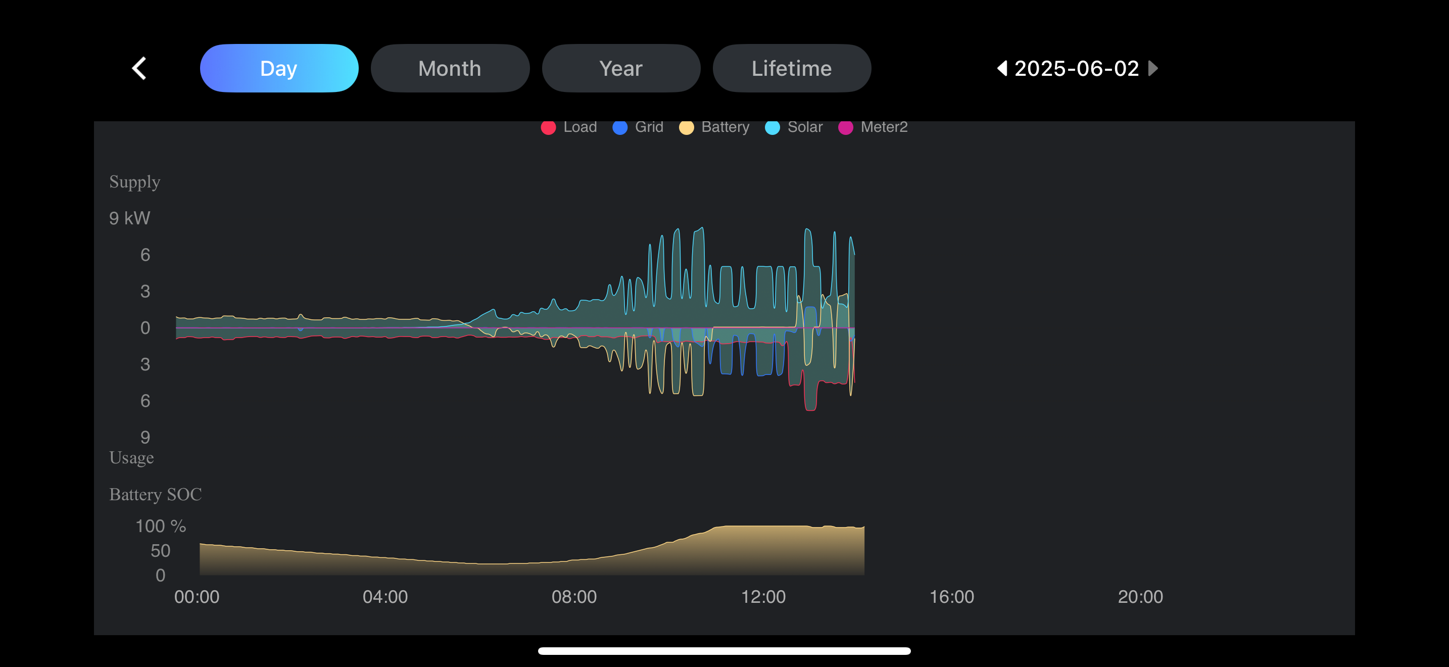

2) Second issue is I noticed there is clipping of solar export to grid at 5kW (see below). During sunny days/10am-4pm. The energy coming off the roof seems limited to 5KW for export if I don't use it, and everything generated above this is wasted, whereas if I do use it, the roof can send 8-9 kW down through the inverter and send some of it to load and up to 5 kW of the rest to grid. Is this right? Have they given me an underspecified inverter? Or is this limit set by UK Power Network? Or can it be manually altered on the inverter settings?
