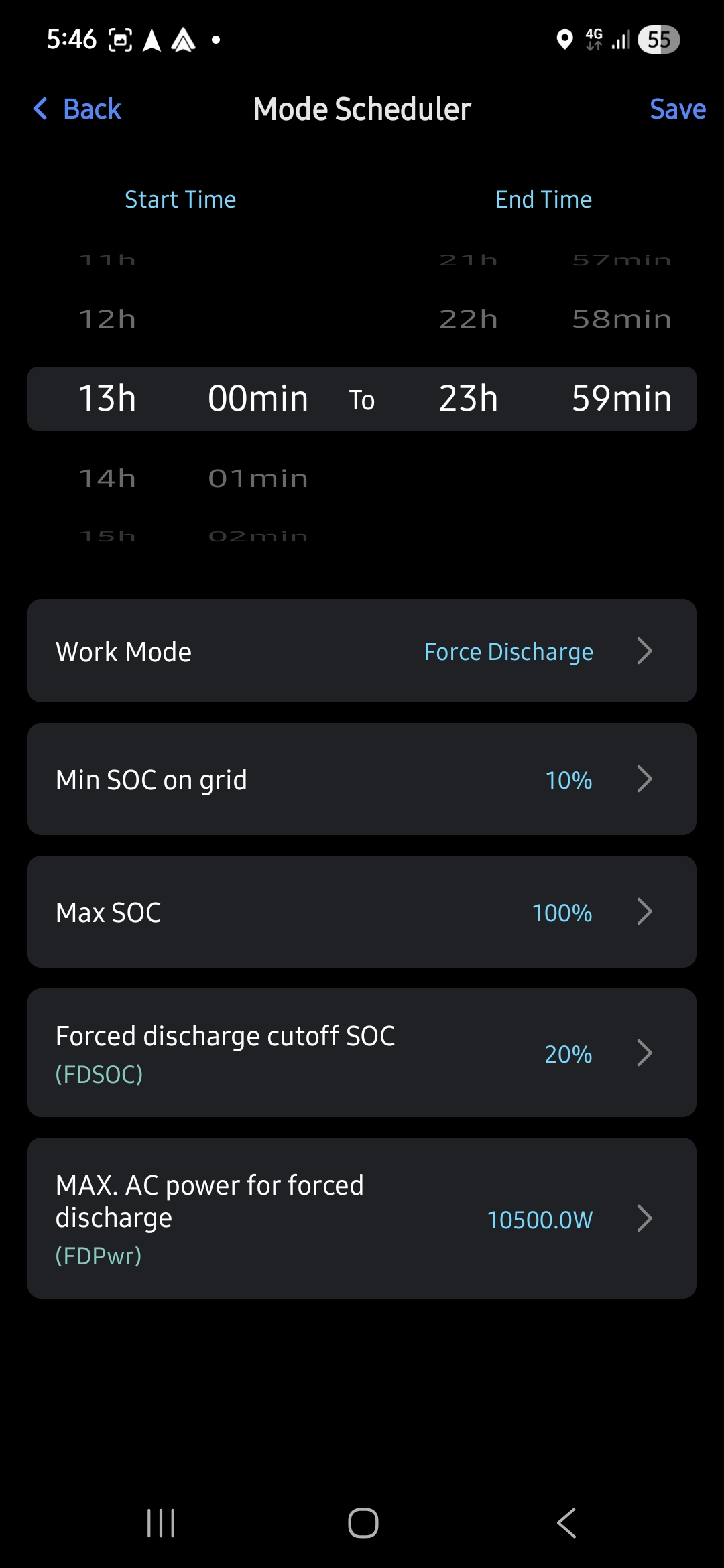

Attached is a screen shot of the schedule to ForceDiacharge, however the entire system seems to show nil.
I have 3 x AC running so load should reflect this, but it isn't.
I have a request in for the firmware upgrade to 5swc. Currently getting 1-2min updates.
Anyone else have these issues?
My battery is a 41kw system, but I never get it to discharge less that 96% though load is maintained.
