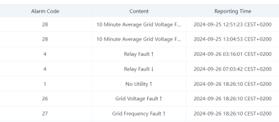

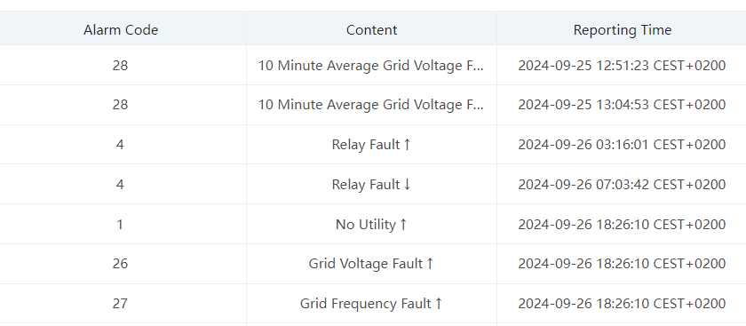

No I don't think it's dead, it is reporting a grid voltage fault (too high) and also a relay fault.

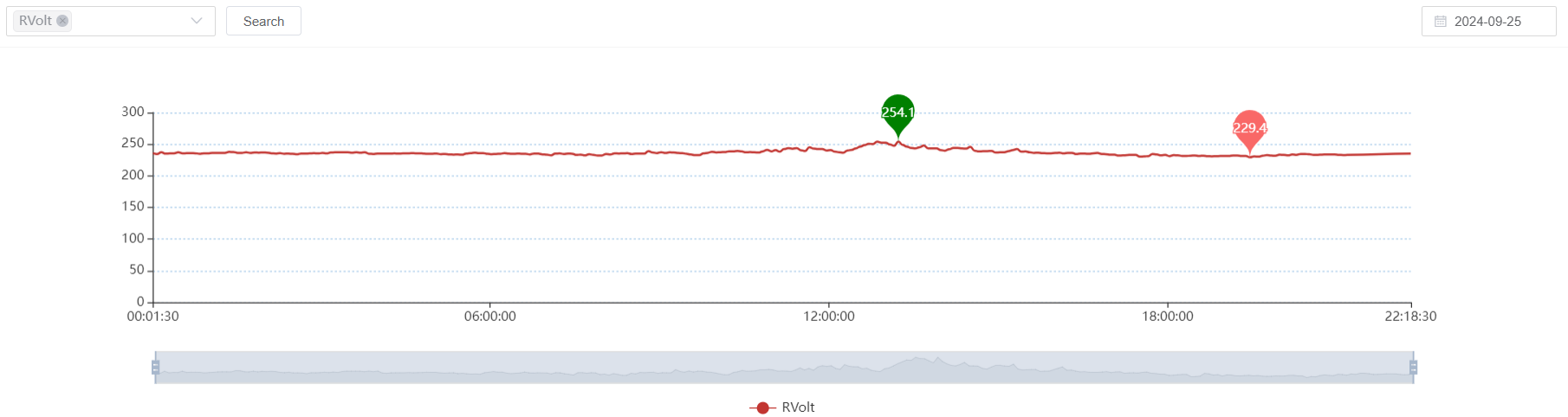

Probably a good start is to go to the Foxcloud website, look at the inverter details page and in the graph at the bottom select 'RVolt' - that will show what your grid voltage is over time and highlight the highs and the lows - if you can post that, I can make some suggestions.

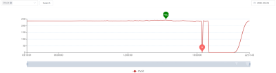

The RVOLT spiked on 25th, but has not spiked again:
I followed the manual and disconnected the unit on 26th. First a few minutes, then for half an hour. Unfortunately it did not fix it, and does not invert anymore:

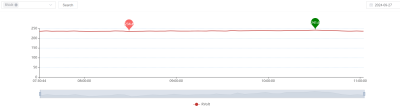

I did not touch it today:

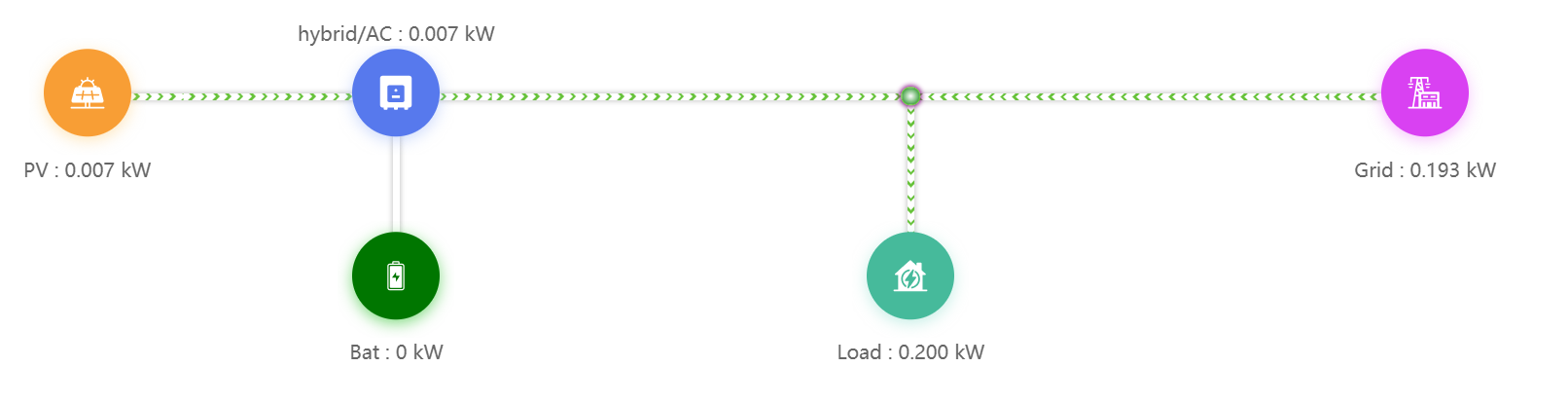

It keeps being stuck in the loop: 60s checking, restarting, 60s checking, restarting,... No production either today...

Ok, your voltage looks good and is in-line with what you would expect so I think the relay fault (an internal error) is causing this - I know that Fox can remotely diagnose and have implemented fixes for this fault remotely - so will wait for Fox support to get back to you.
